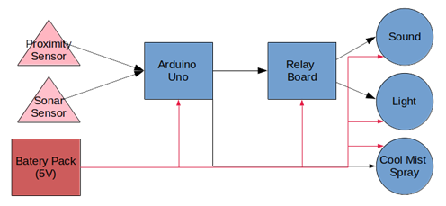

                                                  Figure 1. Warty Monster Block Diagram
Overview
As shown in Figure 1, the electronics for this project is relatively straight-forward: I use an Arduino Uno board, a 5V battery pack, a PIR proximity sensor, an HR04 sonar sensor, and the effects are done with 5V LED lights, a 5V sound recording+playback device, and a custom-made cool mist spray mechanism. The control of the lights and sound devices is done via a relay board (shield). I used an 8-relay board, but only 2 relays are needed.

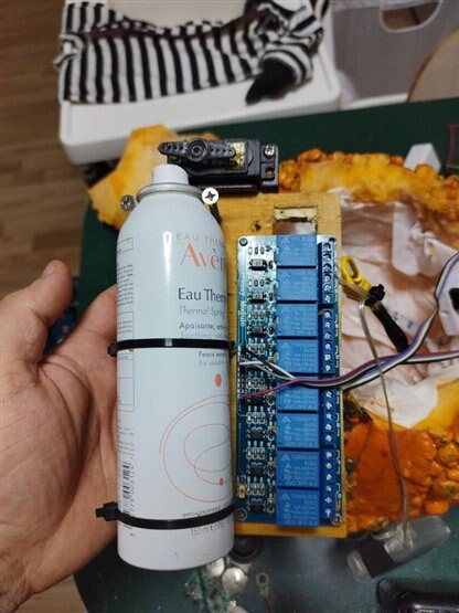

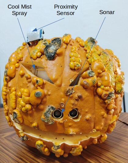

Figure 2 shows the frontal view of the scary pumpkin, featuring the sensors and the cool mist spray. Figure 3 shows the cool mist spray mechanism built with an MG995 servo motor and a thermal water spray. The MG995 rotates to an angle of 40 degrees to activate the spray. The Arduino code I used for this is below:

                  Figure 2. The Face of the Warty Monstart
                Figure 3. Warty Monster Cool Mist Spray
