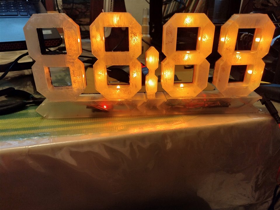

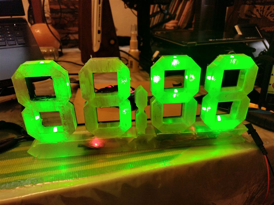

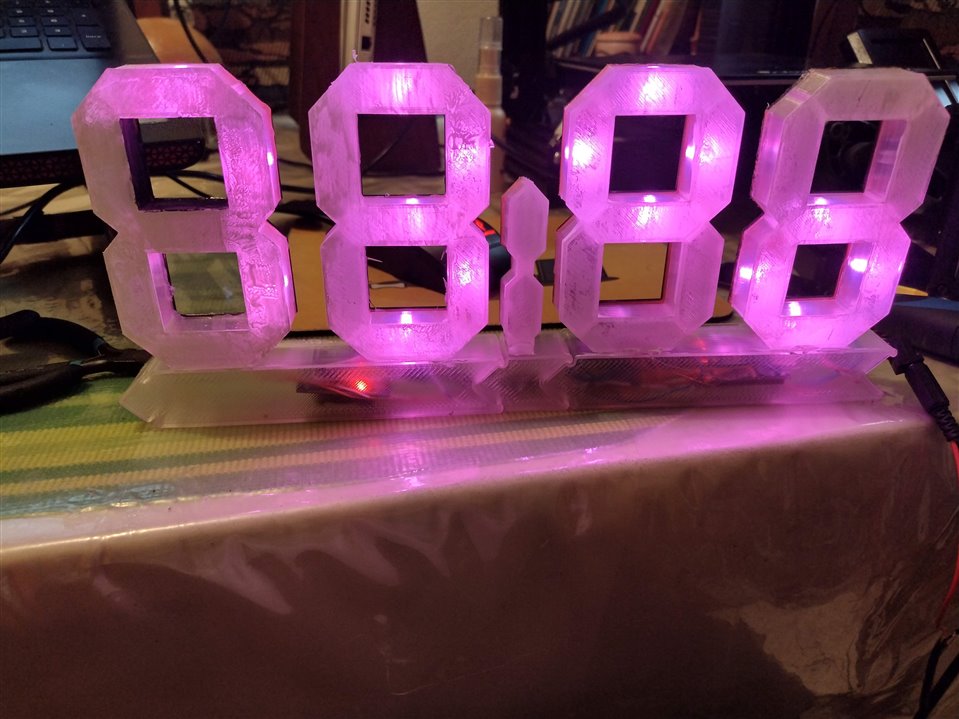

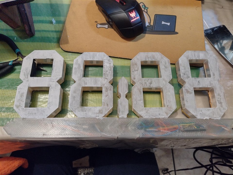

I made a 3d printed clock researched for stl files to get an idea, first I made one with MDF and a laser cutter but moths later I decided to use a 3d printed model to improve it. I found some files on thingiverse, and used them as a refference, but then I used my own code an diagram to wire everithing, up to the final stage. The main problem I am facing now exepting for programing, was a difusor for leds. To place you in context I used some ws2812b led strip to control them individually and able to program them as I wanted. I also used some codes I found on internet but the fact that using my own files and own diagram made me to modify some code. Here is my project.
It´s capable to show temperture, it gathers this information from a temperture sensor, also humidity and it displays it.

    Example of a tuner that I converted from incandescent bulbs to LEDs:
    I used both sanding and calc paper. Plain untreated LEDs would show up as bright hot spots

    John Park discussed pixel diffusion with his ninja timer clock display
    https://youtu.be/WUU8AQsf2Zw?t=132
    Jan Cumps over 4 years ago
    Calc paper (or oiled paper) may help with diffusion. When I use through-hole LEDs, I also sand down the lens of each LED if I need diffused light.
