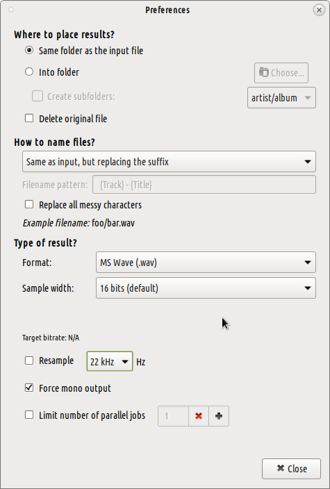

This is just something to have disturbing fun with: the Agony Box.
I'm using an Adafruit's Circuit Playground Express with some CircuitPython code in it and some freely available WAV files. The WAV files had to be converted to PCM 16-bit Mono and I think I need to tune down their volume a bit. I used the open-source SoundConverter app in Ubuntu for the conversion:
the CircuitPython code is as follows:

I just modified the WAV files from this drum machine code that originally sounded like this:
Next I used some brass standoffs and standoff rounded metal caps to be able to better access the touch sensors. I soldered some Dupont wires to a 3.7V phone battery and filed down their ends a bit to fit the battery port of the Circuit Playground Express.
Now let's hear some screams:
Disturbing - I know.
I plan to use analog buttons and a cheaper CircuitPython-capable device to build a better Agony Box. This is just some quick hack I did.
