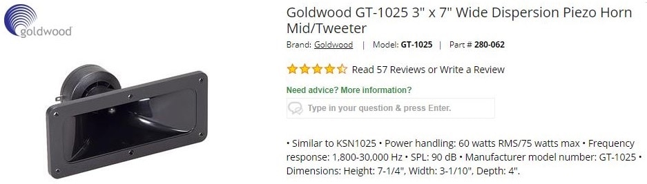

For a speaker, I chose some cheap piezo horns and modified one.  I removed the horn and adapted a 1" PVC coupler in its place.  The plan is to connect a 24" barrel and make the sound as directional as possible.

    That cheap tweeter may not be rated for 30kHz operation. Looking at the spec on this one:
    https://cpc.farnell.com/pulse/pls00307/tweeter-piezo-horn-188x80mm/dp/LS03583
    it suggests 3-20kHz frequency response.
    Similar with this one:
    3" x 7" Piezo Horn Tweeter3" x 7" Piezo Horn Tweeter
    May be an interesting experiment to use a microphone connected to the scope and see what happens as you increase from say 10kHz (still audible I hope) past 20kHz on the input.
  • kmikemoo
    kmikemoo over 6 years ago in reply to beacon_dave
    beacon_dave It's supposed to. imageimage  It is cheap so the rating could be... theoretical (aka marketing hype).
    When I hook it up to my audio generator, it does decent enough.  The sound level falls off as I approach 30kHz - which I assume is my hearing.
    Based on Gough Lui's reply and yours, I may try the audio generator into the H-bridge.  I really need to study up on these amplifiers.

    beacon_dave over 6 years ago in reply to kmikemoo
    "...The sound level falls off as I approach 30kHz - which I assume is my hearing..."
    You will be lucky to hear anything above 15kHz with your adult ears.
    Young children can hear up to about 22kHz but few adults can.
    Hence the suggestion of using a microphone to see what frequencies are actually coming out of the tweeter unit for a given input signal.
