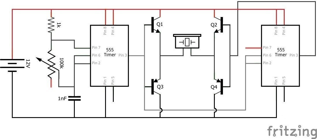

Like many a tinkerer, the 555 has a special place in my heart.  It's one of those MacGyver chips that seems to have endless uses.  Okay, not endless - but A LOT.  When I saw a 555 H-Bridge Push-Pull dog deterrent circuit, I had to try it.  The original circuit used BD679 and BD680 Darlington transistors.  I ordered some from China but... I may see them in April.  Maybe.  I substituted TIP41's and TIP42's because I could get them.
Schematic corrected March 12, 2020.

Needless to say, this was not what I expected.  I played with the potentiometer initially - until I noticed the smell of wires getting really, really warm.  I'm not audio expert, but I'm going to say that buzz is that the speaker can't respond to whats going into it.  Playing with the potentiometer didn't seem to affect the output sound.
I let the circuit cool and played with it a bit more.  The output frequency is not stable at all and pretty much runs away (escalates) as the transistors get hot.  I could heat sink them, but I don't have faith that it will change much.

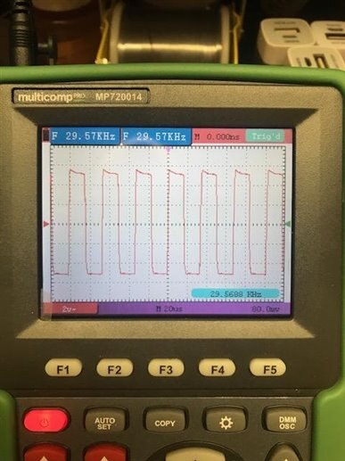

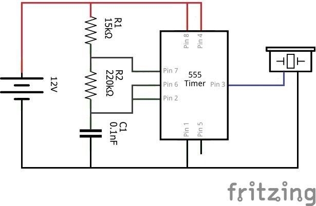

So I tried to go a different direction.  I connected a standard 555 circuit up and connected it to the piezo.  My Fluke says that it starts at 29.3kHz and climbs slowly.  The major issue?  I can hear it.
I shouldn't be able to hear it.

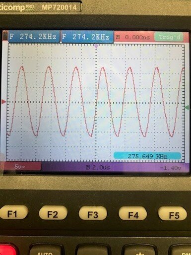

Thanks to the timely arrival of my new tool, I was able to grab this screen shot.  Thank you again to element14 and the judges.
This also allowed me to check my original circuit.  I substituted the trigger circuit from the simple 555 circuit in for the original 1k / 100k circuit.
While I was expecting the amplitude, I wasn't expecting the frequency.  Time to heat sink the TIPs and slow the initial 555 by a factor of 10.

    I suppose this is a good exploration into getting some sort of power into a signal - it can be a little tricky and I'm definitely no expert. That being said, hot transistors normally mean one of a few…
  • Gough Lui
    Gough Lui over 6 years ago in reply to kmikemoo +5
    A Darlington Pair is a classic BJT arrangement that results in a gain multiplication across the stages. Because of this, a Darlington would require less base current to achieve the same collector current…
  • jc2048
    jc2048 over 6 years ago +4
    Did the original circuit have the collectors of Q3 and Q4 connected to ground, by any chance? As you've drawn it, on the low side of the bridge you'll have a diode path emitter-to-base to whichever 555…
