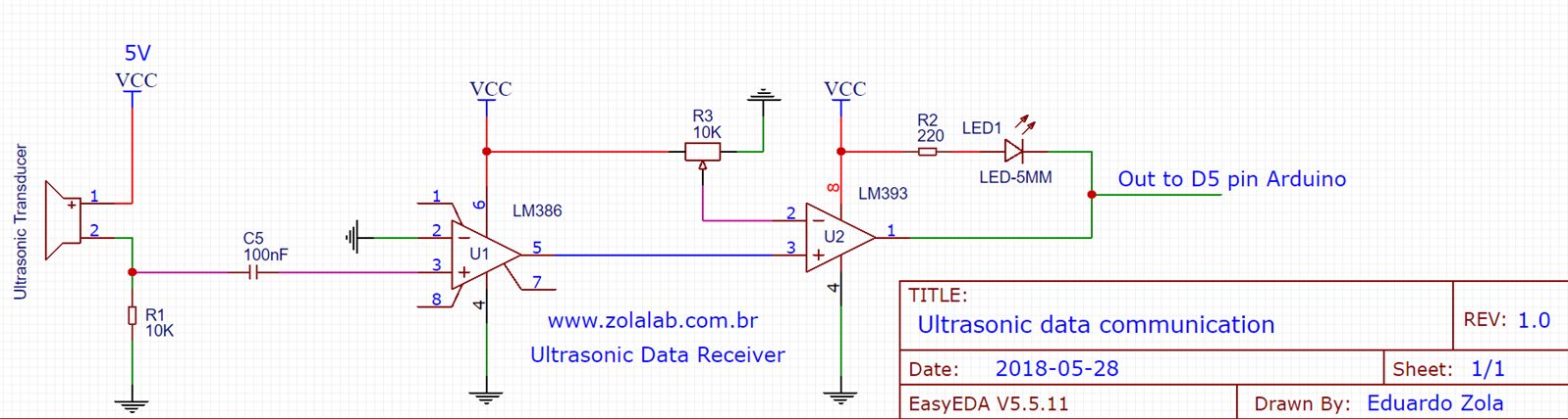

      • Schematic for receiver. Credit : the hackaday post

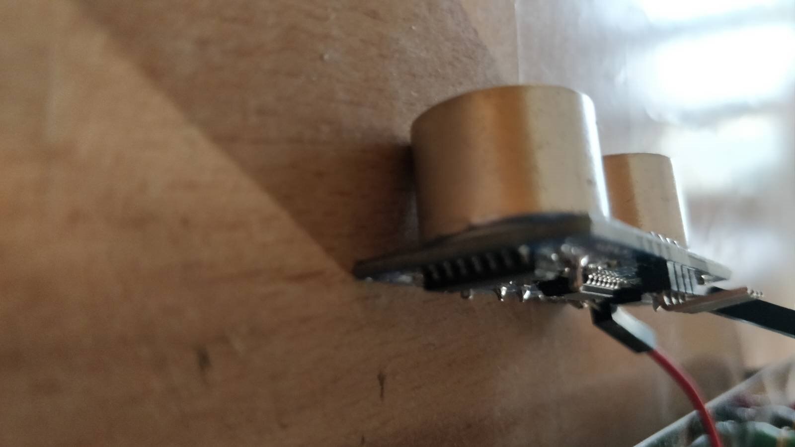

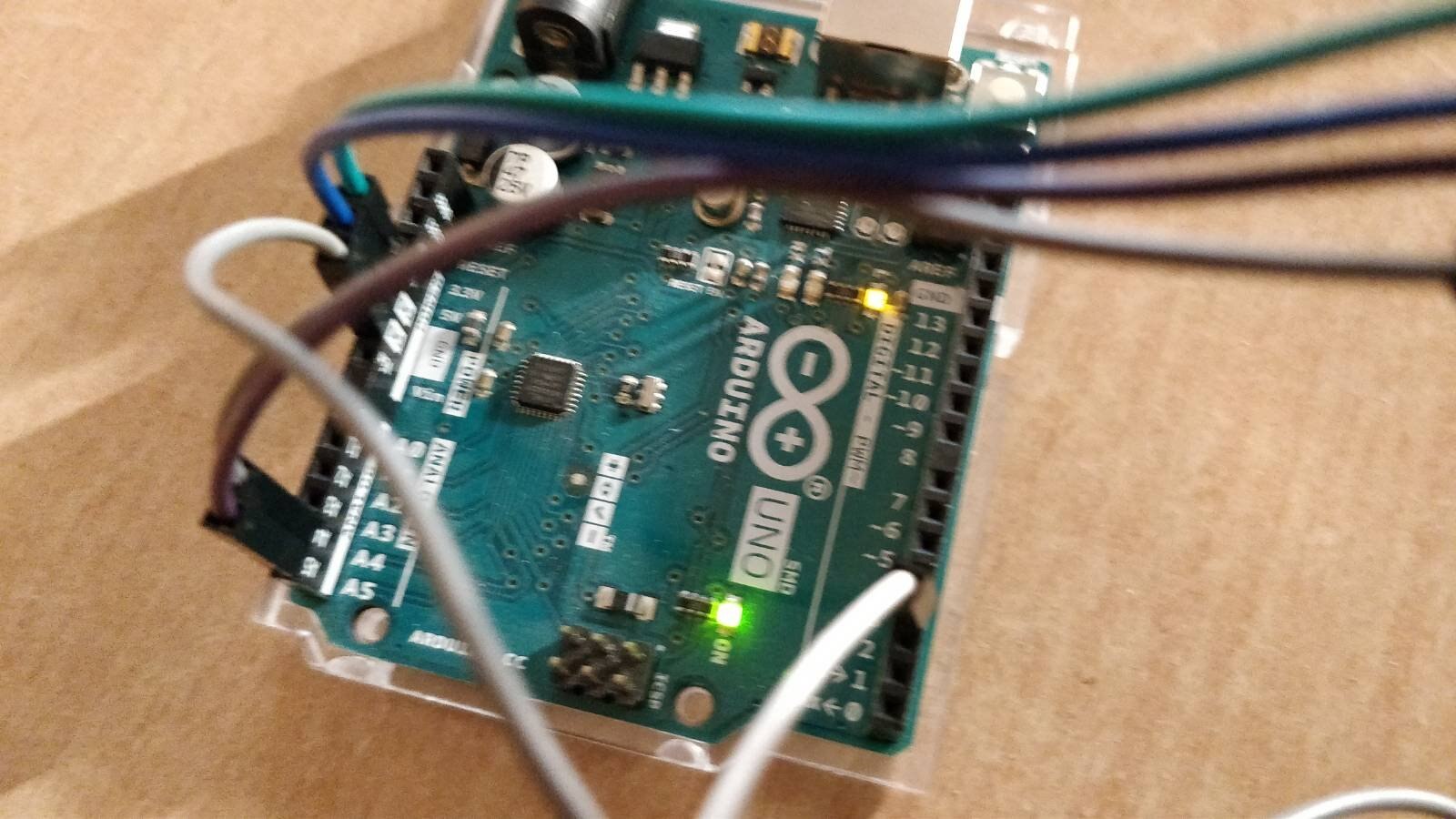

Then I thought to just use transducers of the ultrasonic sensors. I soldered one ultrasonic sensors transmitter pins and other ultrasonic sensor's receiver to jumper cables. The reason was that after the project I could de solder the wires and use it for something else.

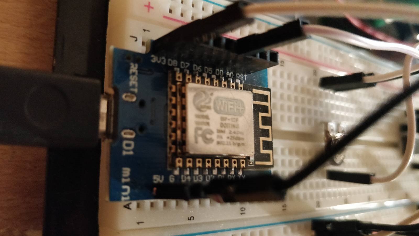

Wemos D1 MIni - uC with WiFi

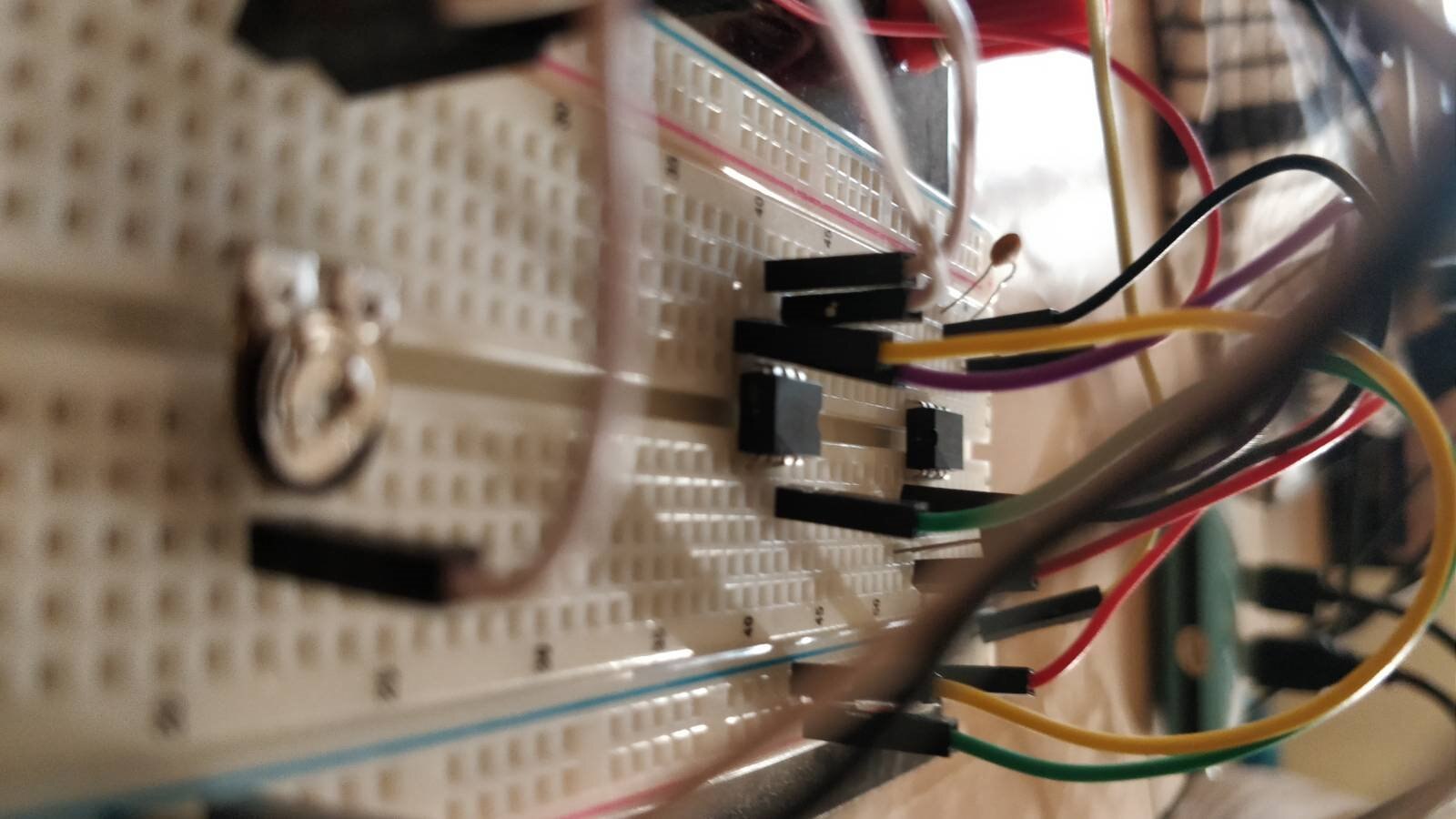

Assembling

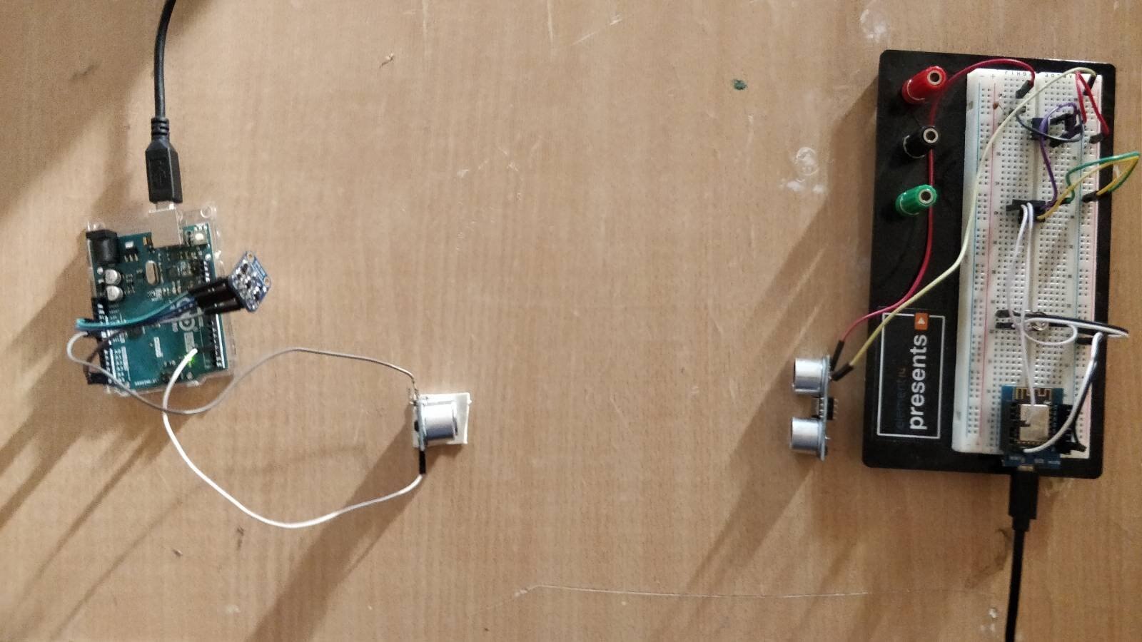

The schematic for the same is on the Hackaday post. I am just using wemos instead of an Arduino so that the data received can also be sent to the cloud. The only change is supply to comparator which will be 3.3v instead of 5v.
I did not connect the LED as found no practical use to it.
Schematic for Transmitter is pretty simple:

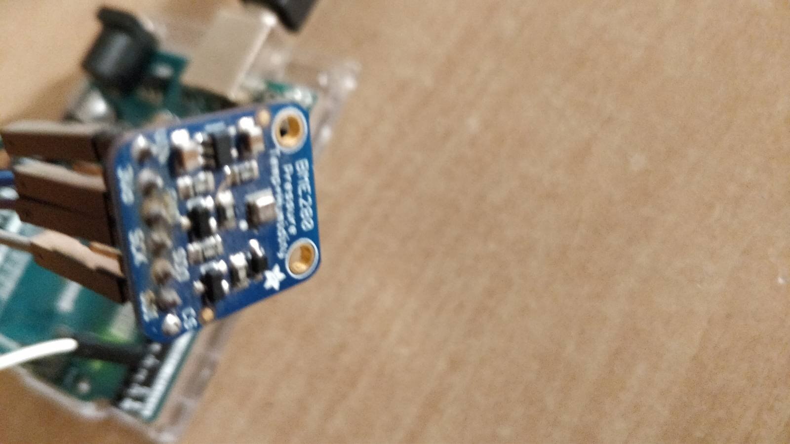

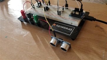

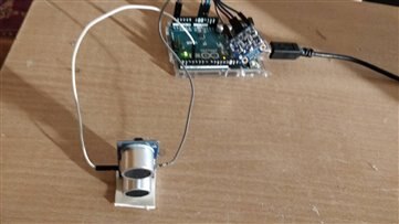

  1. Connect BME 280 sensor via I2C/SPI.  I used I2C because it requires only 2 wires. Also connect VCC/Vin and GND pins of sensor to your development board.
  2. Connect the transducer's one pin to pin 3 and other to GND
The Transmitterimage
The Receiverimage

Here is how it works:
  1. Data us read from BME280 sensor on the transmitter and a string is made in this format : <temperature>,<pressure>,<humidity>,#
  2. The string is then broken into characters and each character into 8 bits ASCII Value.
  3. If it is 1 then the ultrasound pulse of 2ms and if 0 then of 4ms is formed. The "tone()" function of Arduino creates a very high vibrating frequency .
  4. On the receiver side data is received by measuring the time duration of which the pulse is their. Then it is converted to either 1 or 0 based on the pulse duration.
  5. Then the bits are converted to ASCII to characters and finally a string is formed.
  6. This string is then used to separate the temperature, air pressure and humidity values.
  7. The data is then pushed to Blynk cloud on pins V1, V2, V3 respectively.

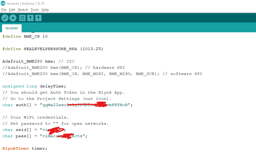

Sender Code   https://gist.github.com/vimarsh244/dabe71cf9e18b30b88f72c52e9a638d6
Receiver Code   https://gist.github.com/vimarsh244/d3d09b8dcfb82ff1f4a4e30a9d3687a1

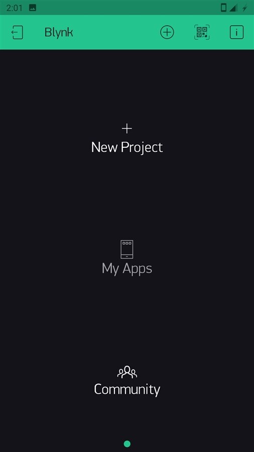

First step is to download the Blynk app from the Play Store/ App Store.
Then follow these steps to complete setting it up.
{gallery} Setting up Blynk

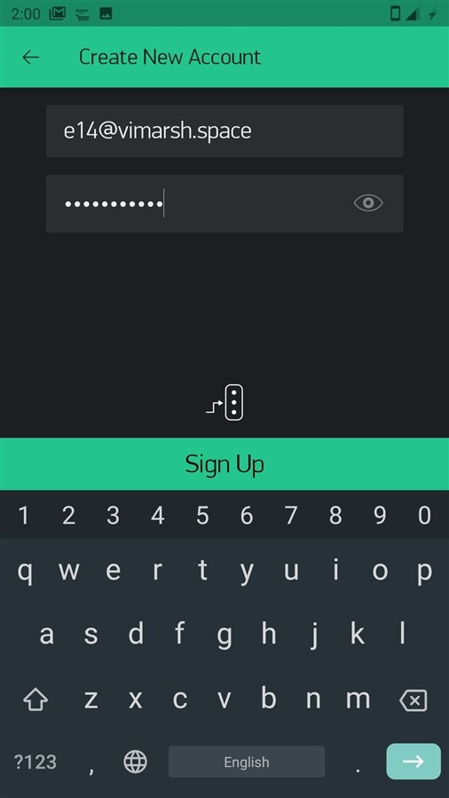

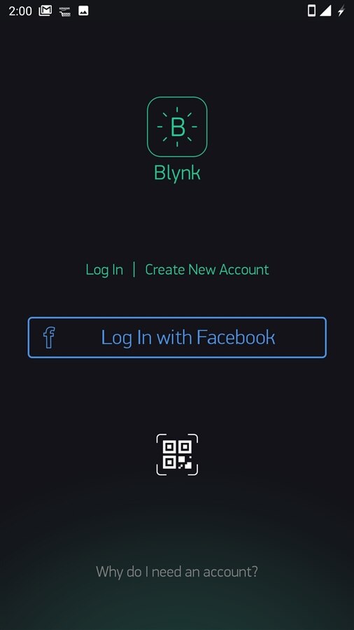

Once you open the app, you will be greeted with this screen. Click on create a new account.
Enter your details and click on Sign Up

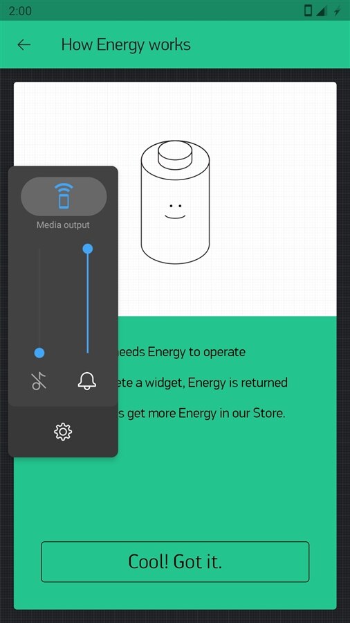

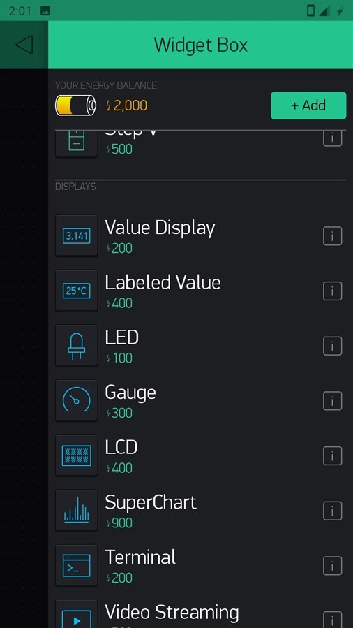

Here, you get to see that you will only be given 2000 energy. Energy is like a virtual coin in Blynk from which you can get several widgets. Widgets are various input/output graphical elements,

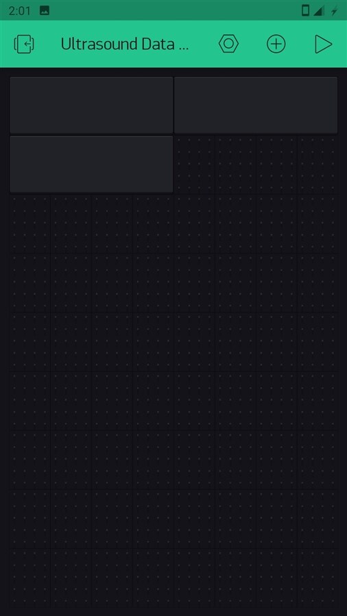

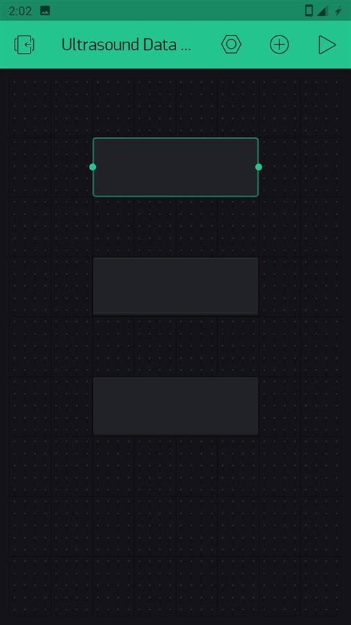

Click on new project

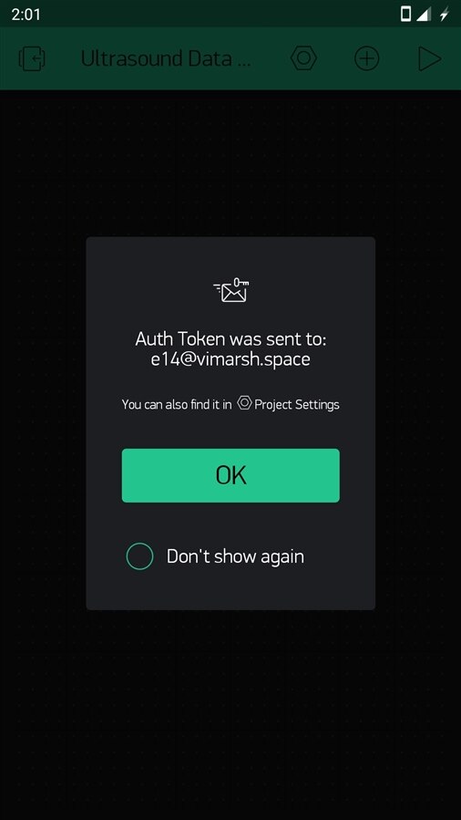

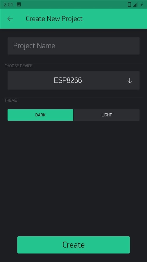

You will see this. Enter your project name and select correct device. For us that is ESP8266, the chip on the Wemos D1 mini
After creating the project you will get your auth token on your email address. Auth Token is a string of character different for every device.

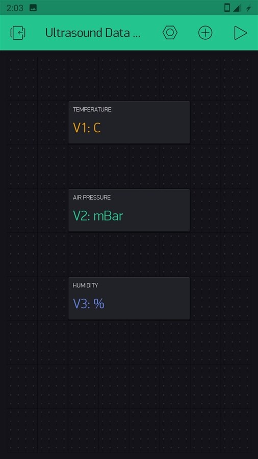

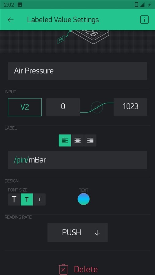

Tap anywhere on the screen and you will see this menu from left. Select Value Display/ Labeled Value
Add 3 of those to your project.
Arrange them in proper place by long pressing then moving it.

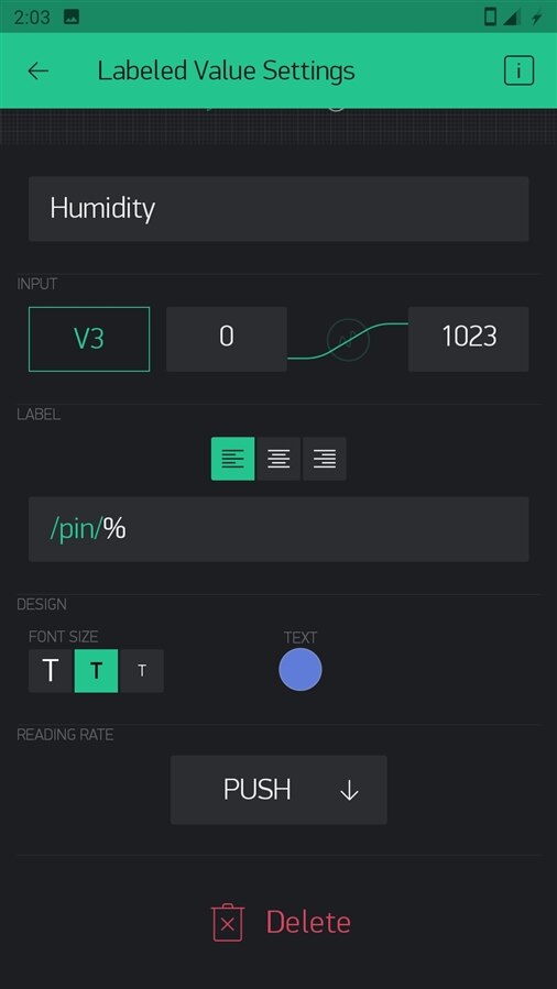

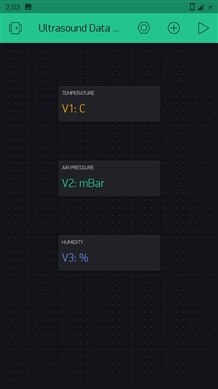

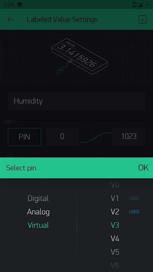

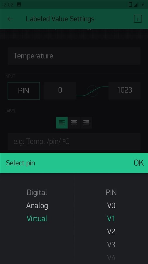

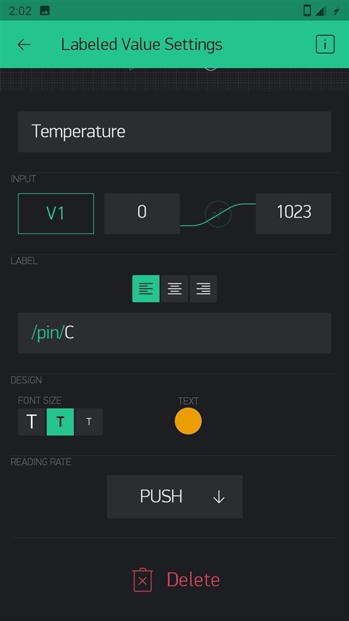

Click on one widget and name it temperature and select pin to Virtual and then V1

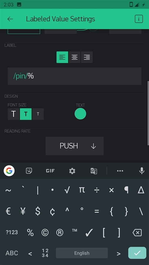

You can set text color,size,etc and the ending text after '/pin/'  It will be different for every widget.
Do the same for Air Pressure with another widget
And the same for humidity
Yo can type any symbol at the end.
This is how humidity settings will look like

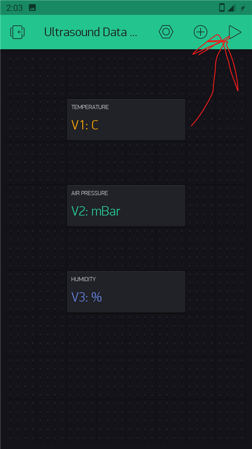

And the configured screen. Then go to you Arduino IDE. and upload code.
First don't forget to change the Auth token and WiFi Credentials in the code.
Then click on play button

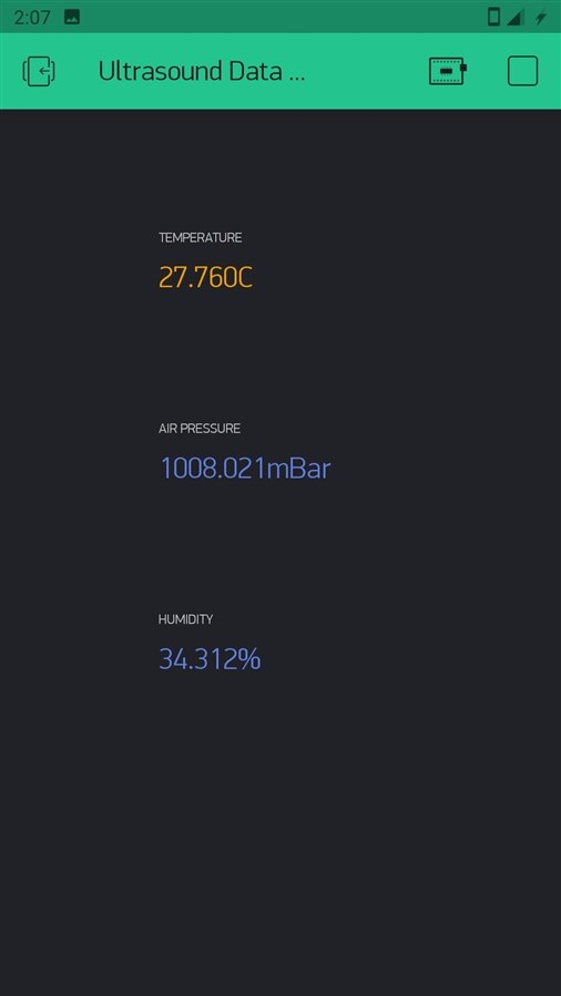

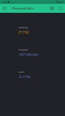

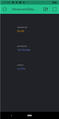

You will see your data from the sensor being transmitted via sound on your smart phone app.
Also, because you are using a cloud service. You can download the app on any other phone and also see that data!

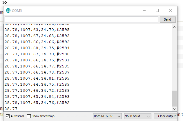

Results

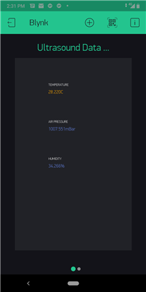

You can listen to sensor sending data 3 times with one second delay in between: Listen here
Here is the data on the Blynk app:
I found that the connection link was not stable for esp8266 to Blynk server perhaps because of code in-between which Blynk says no as because of delays the server session may time out.
Also, the distance between sensors and sensitivity may have to be tuned in a better way. Just if I had an oscilloscope!

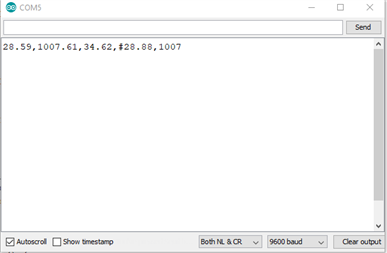

Data being received>
Speed of Transmission
I edited the code of receiver to find time it takes to received the full string. I turned out to be around 2600 ms.
long initial_time=micros();
//existing code
long final_time = micros();
long transmit_time= (final_time-initial_time)/1000;
Serial.println(transmit_time);
Here is output with that:

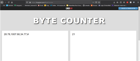

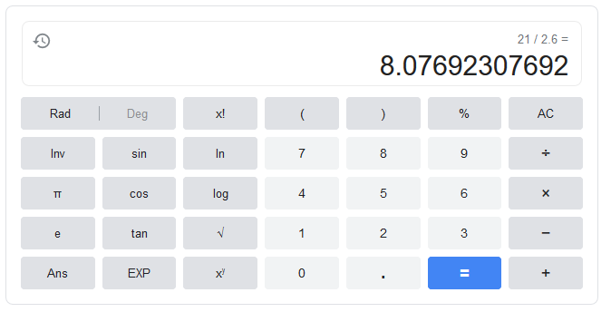

To calculate speed I measured the Bytes being sent and divided it by time it takes.
It is 21 bytes:
Dividing it by 2592 milli seconds
Speed = 8.077 bytes / second
The speed seems quite less and it is compared to WiFi and other RF. But that is still reasonable if we want to send some specific readings.

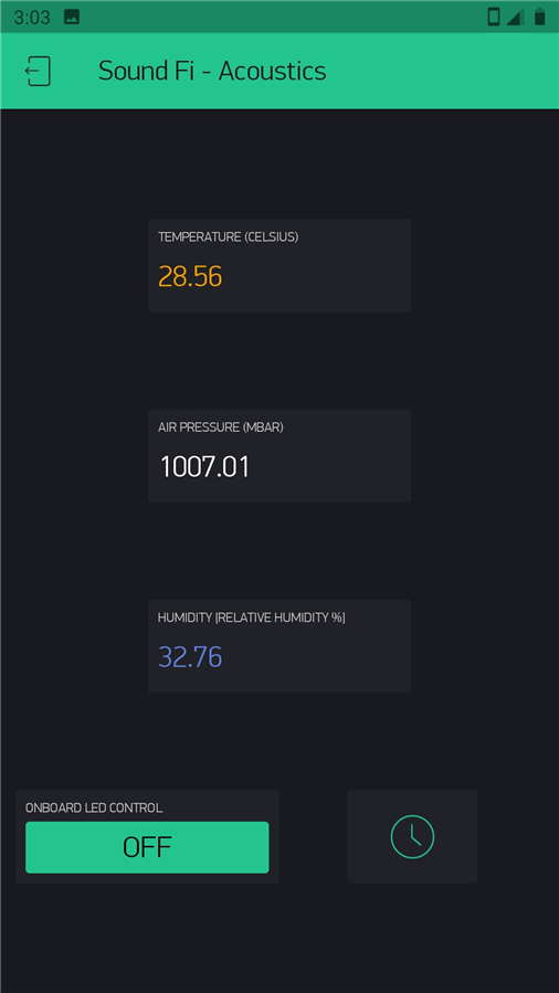

If you want to see the data on your smartphone which my device is transmitting. Then see the steps>
I will keep it on for some days probably and hopefully it will be transmitting. I live in Gujarat, India. So those are my indoor weather conditions. Also, I have added a button to control the onboard LED on the Wemos D1

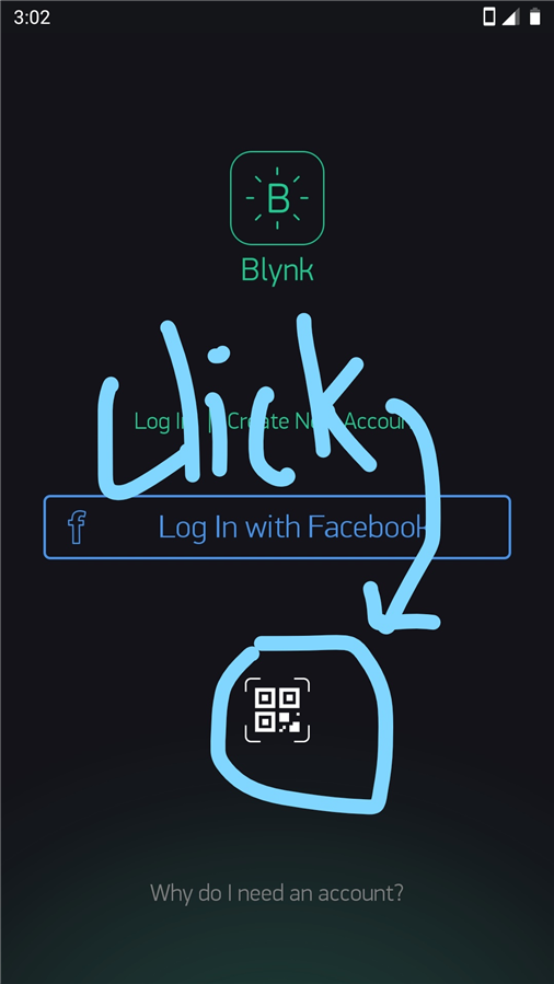

Click the QR Button
Scan this QR Code
Enjoy!
