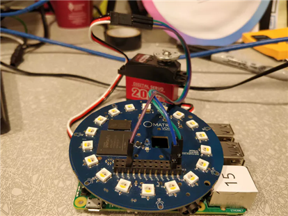

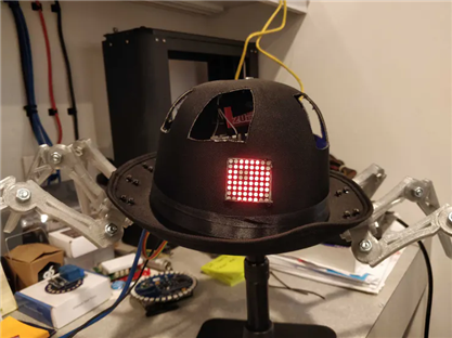

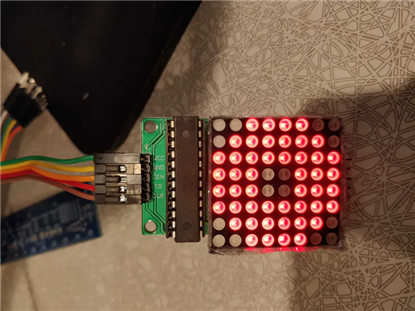

4. Wiring the Servo and 8x8 LED MATRIX

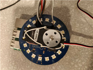

Attach the red wire (power) of the servo to the 5V pin on the MATRIX Voice expansion GPIO, the black wire (ground) to a GND pin, and the white wire (signal) to GPIO4 as shown below.
For the LED MATRIX, attach VCC to the 3V3 pin, GND to the other GND pin, DIN to IO25, CLK to IO26, and CS to IO27. The pins marked IO come straight from the ESP32 as shown here.
5. Assembly

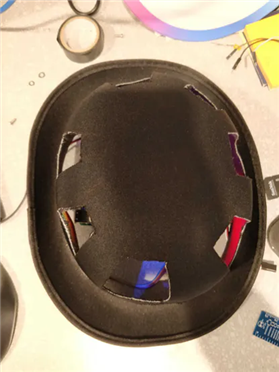

In order to lodge the 8x8 LED MATRIX in the front of our bowler hat, we cut out a square of similar size for it to poke out through.
We then cut out 8 squares around the bowler hat around the height where the MATRIX Voice's microphones would be exposed for audio to go through to them. We covered up the cut-outs with audio mesh, which is a nice addition if you have them.

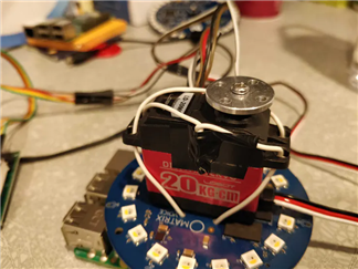

We attached the servo motor to the ESP32 MATRIX Voice using the camera holes and threaded two sturdy wires through to go over and across the servo as shown in the images below.
Note: In order to ensure that the servo is attached to the MATRIX Voice in the appropriate orientation, run the odas program and ensure that the servo angle lines up with the LEDs on the MATRIX Voice.
Make sure to attach the Raspberry Pi to the MATRIX Voice with two spacers, bolts, and nuts (we used plastic ones). That way the torque from the motor does not attempt to twist off the MATRIX Voice from the Pi.

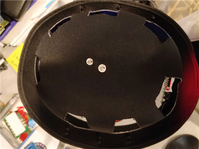

We poked two holes in the top of the hat to attach the hat to the servo hub as shown in the images below.
Note: Set the servo to 90 degrees by running the odas program, then exit out of the program and attach the hub to the hat such that the 90 degree side of the servo makes the hat face the "front".

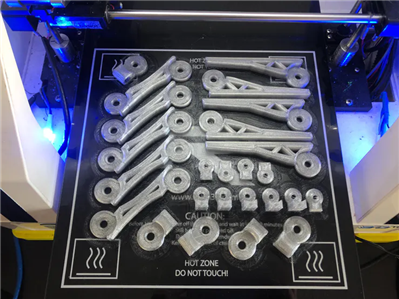

For the spidey legs, we designed and 3D-printed with clear black PLA.
The assembly of the legs to the hat can be shown in the series of pictures below. Follow the process of cutting slits in the hat, zip-tying hinge to hat, and bolting each joint together.
We used 16mm M6 bolts for the 2 leg joints and 30mm M4 bolts for the swivel joint.
We zip-tied the Raspberry Pi to an inner hat to secure it to our heads by looping through the remaining two screw holes in the Pi and looping around the Pi itself on the other side.
And there you have it! Doris, the evil bowler hat from Meet the Robinsons, ready to scare image
