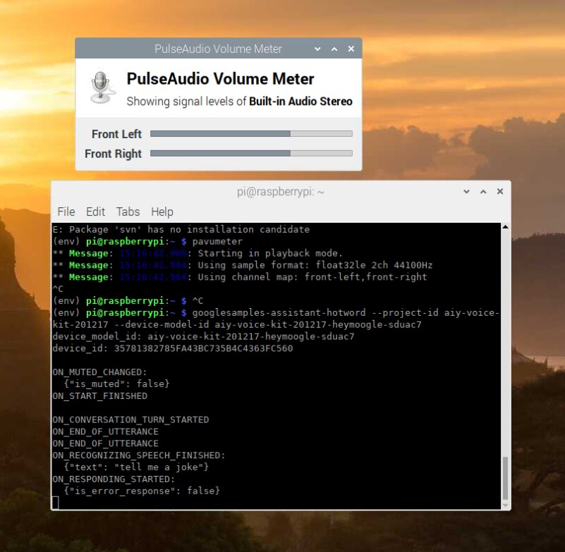

  • easyejl
    easyejl over 6 years ago
    After a lot of pain and suffering image I finally got the hotword based google assistant working with a VU meter. the problem I had was mostly configuration I think. I started with one meter, but it was python 2.7 based so how it used alsa + pulseaudio was different. then I ran into google assistant problems, then tried another and another and another VU meter type project. Finally found this one. Its in C, but since its real value is that its a) working! and b) shows the pulse audio api calls that get made, I'm pretty sure I can take what I need from it and do it in python. I may just distill it down and use C. I'm just a good bit more comfortable with basically any language other than C image I tend to have memory management issues in C
  • easyejl
    the arm is almost complete. I had originally going to use the google AYO voice hardware, but was having problems getting it to specifically work with pulseaudio, which I need for reading the output volume/frequency realtime. so I picked up a different audio card. Nice thing about this specific kit is that the controller built in that you can see in the picture allows control by USB. so easy to integrate with the pi, and I don't need a 2nd servo hat on top of the audio.
