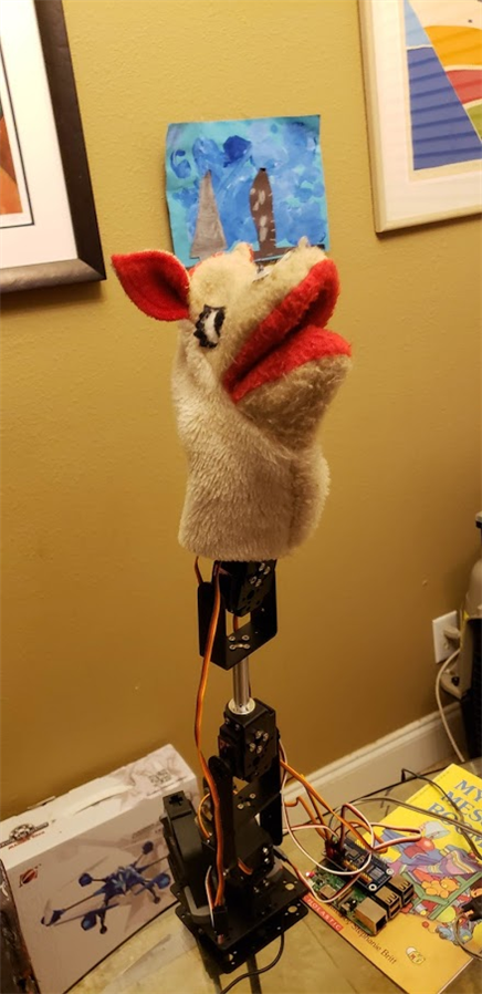

My wife and I went to see Evil Dead - The Musical, and I was entranced by the moose puppet on the wall. I thought "Heck, it would be easy enough to make an animatronics moose to have at home", so I set out on this project.
Basic plan steps are
  • Acquire moose head puppet
  • Acquire robotic arm + servos
  • Begin programming pi - Basically can use most of the Google AYO voice pieces, need to add some references to pulse audio to capture the sound as he's speaking, to use to move the mouth
  • Assemble pieces
  • Laugh a lot
Steps completed
Moose head puppet on the way from ebay!
Robotic arm on order
Google AYO kit reformatted back to original and programming has begun!

    Made some modifications to the claw, and have it able to work a puppet mouth now. It's only slow because the pi is underpowered right now, I ran out of outlets. So its being powered by the USB port on…
  • easyejl
    easyejl over 6 years ago +4
    For the claw modifications, I took out the 2 pieces circled, set the other arms to be straight and then fully tightened them. They originally were set as loose, with a locking nut so that they could bend…

    Made some modifications to the claw, and have it able to work a puppet mouth now. It's only slow because the pi is underpowered right now, I ran out of outlets. So its being powered by the USB port on an older Surface Pro. Not exactly high output.

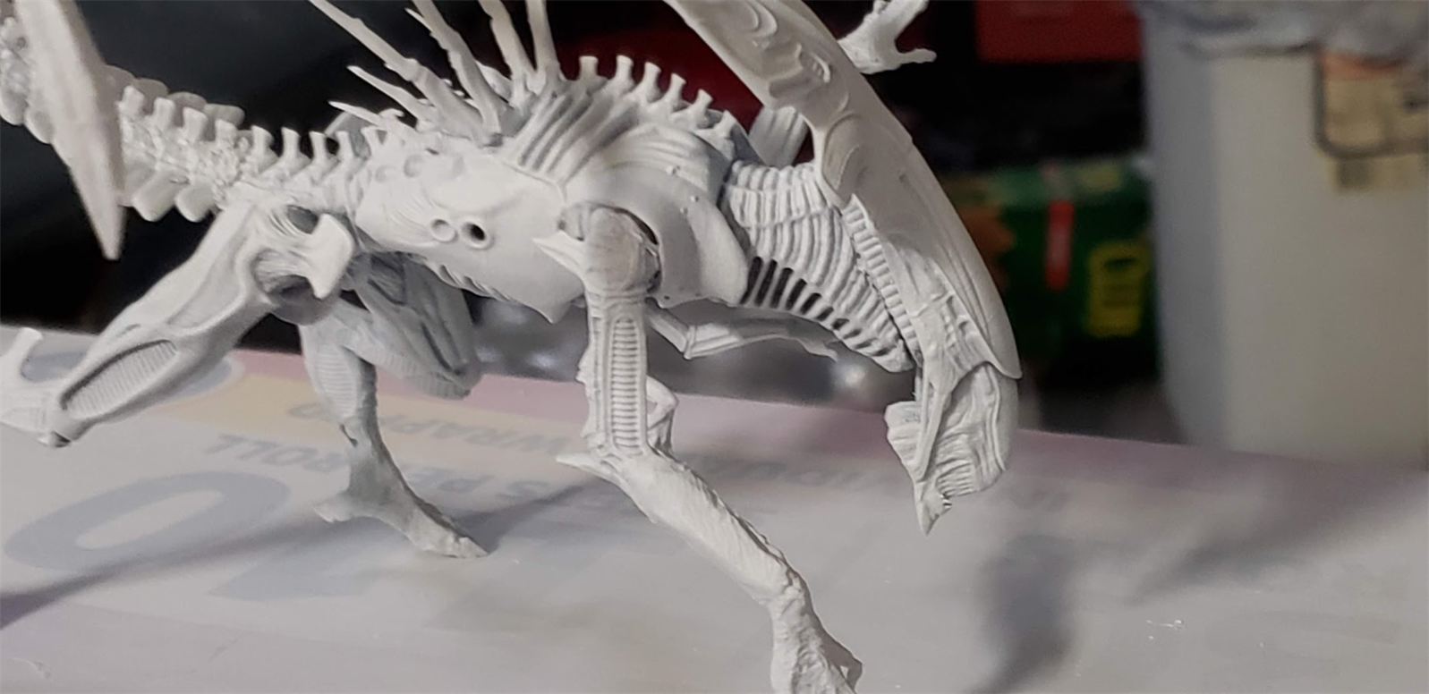

    I'm now on my 3rd 3d printer, a resin one this time, for that reason. Started modifying a Tevo Tarantula to make it a quick change head system (to easily swap nozzle sizes) and now it sits there with the last (failed) print still on it for close to 2 years now. The elegoo mars has nothing really modifiable on it, and prints spectacularly as is.

    I've also built a second arm. The link to it is here
    https://www.aliexpress.com/item/33010121287.html?spm=a2g0s.9042311.0.0.5d3c4c4dvDMqvK
    Simple, nice to put together, and inexpensive. Came with M996R servos, no controller. I still need to modify the claw to move fast enough and in an appropriate manner for a puppet mouth. I used this with a pi and a servo hat, worked nicely outside of 2 of the joints barely having enough power to move if the whole arm is extended straight horizontally. I might add some springs to give it tension that way, or replace those 2 servos with higher torque ones.
