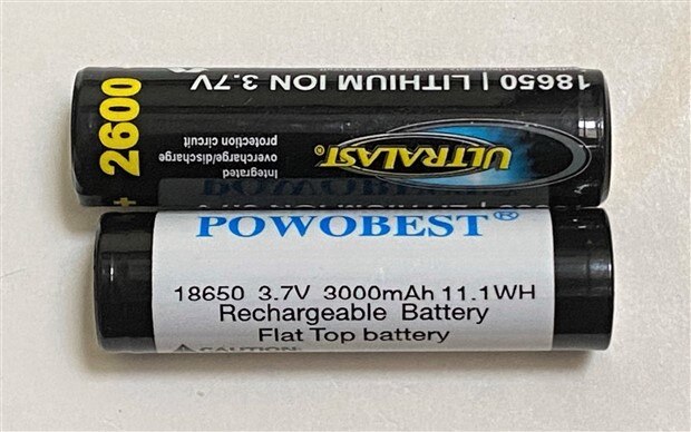

At last, I finally received the correct size 18650 batteries.  I could have started testing with an external power source, but decided to wait for the batteries.  The way the power is hooked up you can't get enough voltage from the Arduino Uno USB port to power the motors.
Here's a picture of my battery problem - I initially purchased the longer batteries which did not fit in the battery holder.  But, they do work great in a flashlight that I got with the shorter batteries image.

It appears that I'll need to adjust (calibrate) the motor speeds to run straight, but a good sign of life.  The IR obstacle sensors don't appear to be working.  Fairly simple circuits - guess that's my challenge for the weekend.  I'll also look at the AlphaBot library to see what I might need to change if I use a different processor board for control.

    Cool robot (drone)! A little tweaking (or maybe encoders) and you should be able to get your forward motion straightened out. Interesting how the battery sizes differ. Funny, but with all the Li-Ion batteries…
    Interesting how the battery sizes differ.  Funny, but with all the Li-Ion batteries that I have worked with, I have not yet experienced any of the protected cells.  My initial work with Li-Ion batteries (unprotected) were in very high current draws (>100A pulses), where protection would not have worked.  As I continued to use them, I stuck with what I knew and continued to use unprotected cells, and provided protection within my charge and discharge circuits.
    Good luck as you move forward with your project.
