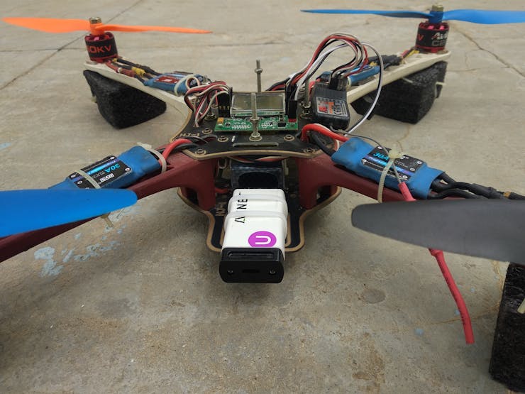

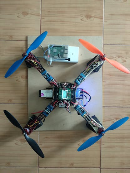

Get the required things. Here we are using a Raspberry Pi, A drone with a flight controller and the most important thing is our avnet brainium module.
Let's connect the brainium module to the Raspberry Pi via Bluetooth.

This makes the connection to the Raspberry Pi and hence we can use Raspberry Pi as a Gateway device. It's better as we can easily mount a standard Pi or even Pi Zero in drones or industries instead of a smartphone. Through the gateway, it can send the data to the cloud to generate AI models.
Here I have chosen Raspberry Pi because we can make the gateway as mobile and it can fly with the drone.

I have trained the model for following situations:
1. Broken propeller
2. Broke connection
3. Damaged propeller, i.e dangerous to fly
4. Stationary drone
5. Drone running without propeller
6. Drone running with propeller

I have attached a buzzer to raspberry pi for the notification.
                                      Raspberry Pi with Drone
The predictive maintenance AI of this drone is so good that it was able to detect the modified propeller also.
