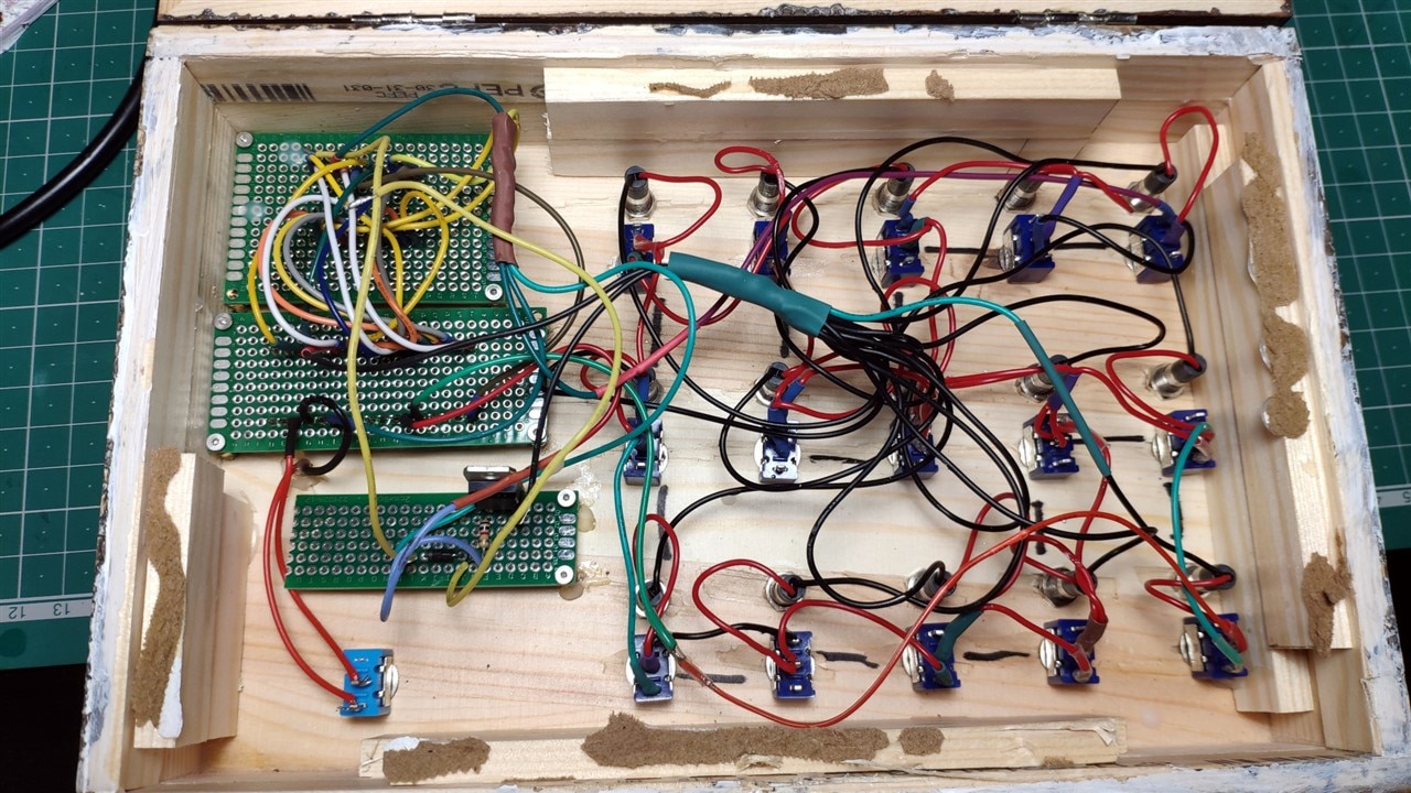

Circuit
Here's the start of the wiring
The first switch gets 5v from the Arduino. The middle PIN of the switches is always going to be connected to the next switch. Next, you make a choice. Either you solder it to the top PIN or the bottom one. This will make the switch activate by pushing the switch to top or bottom. They are 3 positions switches. triple the fun ! :)
To make the LED light turn on when putting the switch on the correct position (top or bottom, according to the PIN in which we solder the wire), just wire the positive wire in the middle PIN of the switch. The current will come from it when putting the switch on the correct position. The ground wire to the ground. You keep doing this until the final one.
One thing I've done (and you can see from the black lines in the box, next to the switches) was to create a path. If it was just flipping switches in sequence it wouldn't be as fun.

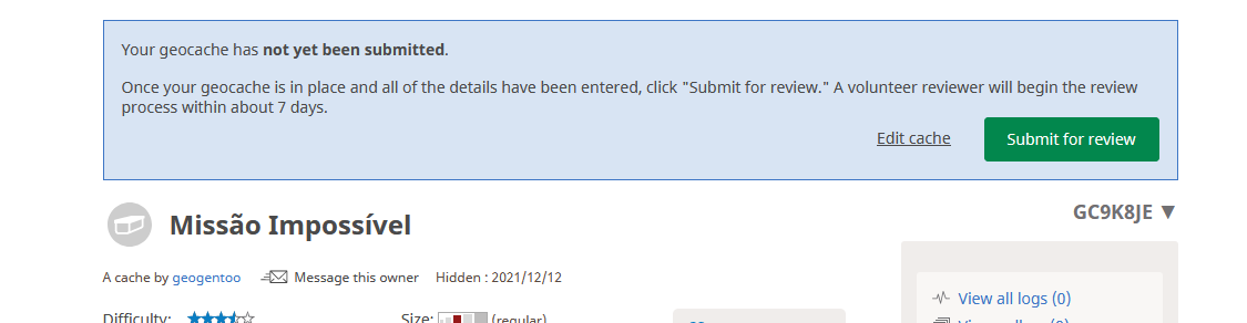

If you know Geocaching, you can - and should - give a hint to solve the cache.  Since I've added a timer, it would take some tries before they could solve the cache in under 40s. It's possible, because the LEDs would indicate that the switch is on, but let's not be too harsh. I want the people to have fun.
On the Geocaching page of the cache (to be updated when cache is published), there's this image:
Using the image as an hint, they will understand the order to flip the switches.

openCache function
This function checks the voltage on the analog Pin (The ADC circuit) and reads the value. After some testing, 900 is the minimum value read when all the switches are flipped correctly.
If we get lower, then it means that no voltage is reaching the PIN, hence the switches are not all flipped correctly.
NOTE: This was my way. I'm sure that could be other ways, or this value may be dependent on the battery voltage being full or almost empty. This uses a 9v battery.
If the value is above 900, then, we turn the SOLENOID PIN to high and it retracts it, opening the cache.
Back to the runCache.
If openCache returns 1 - meaning it's opened, we exit the runCache loop() - and back to the setup function. Remember - this function was called from there.
If openCache returns 0, we keep going in the openCache loop until the timer runs out (but the cache never opens).
After exiting the runCache function, we show the animateDisplay function.
This function takes 2 arguments - i and j . This are the variables that countdown in the runCache function.
If we exit the runCache function with still time left, i and j will be the time left : i is dozens and j is ones.
If we left the time run out, both will be 0.
In a infinite loop, we display i and j on the 7-digits display. Delay 1s.
After that, we put all the segment PINs on HIGH, making them turn off.  Wait 1s and display the digits again...

NOTE: Here's the cache page. It's not yet published, you'll received an error. It's been raining and I haven't yet had time to publish it. The cache page is done, but still have to place it .
