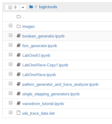

Here are the logictools notebooks.  The ones with the "LabOne" prefix were ones created for use in the lab.
