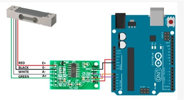

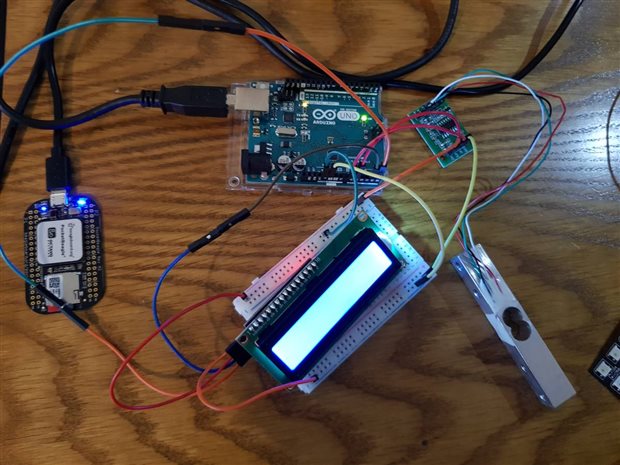

These are the first results of the working smart shopping bag project. Finally I got the Load Cell 10kg straight Bar sensor and the Load Cell Amplifier HX711. Interfacing them is simple with Arduino. There are also libraries available in Arduino to use the load cell.
Connecting the load cell to the Arduino board via the amplifier

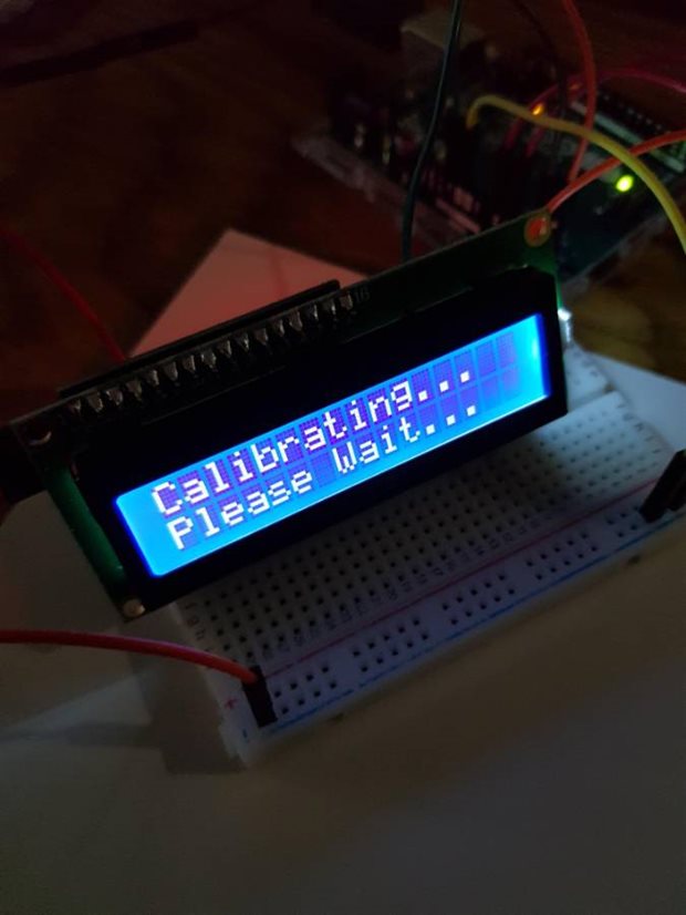

Testing and calibrating the load cell

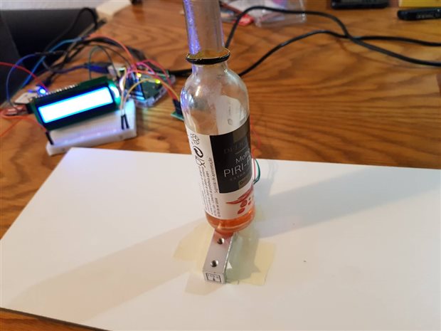

The test setup

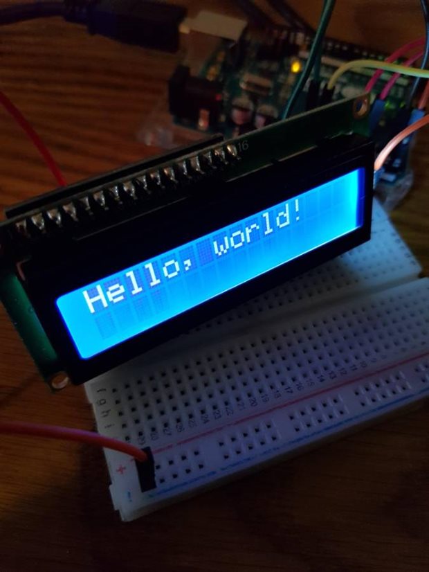

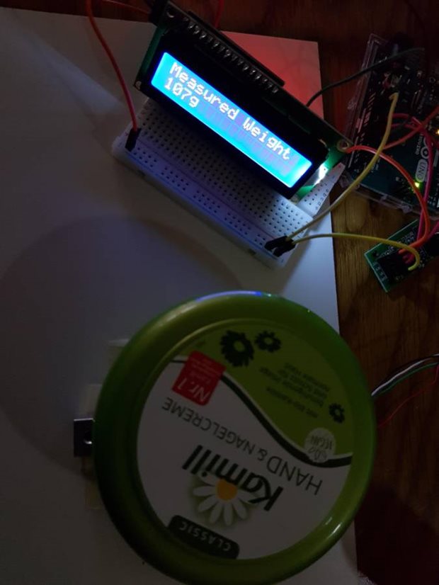

I2C operated LCD to see the load results

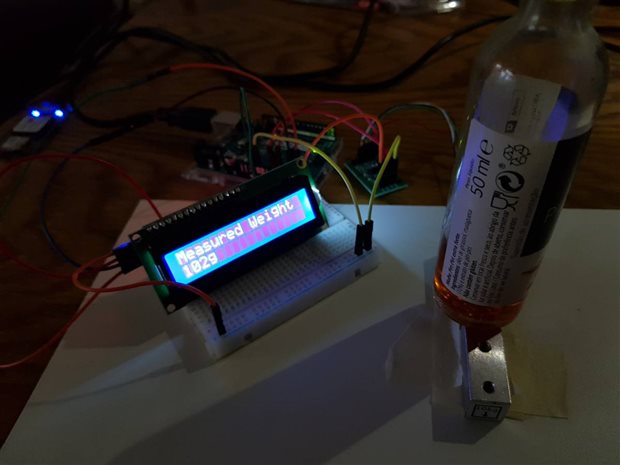

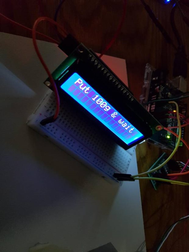

The load cell should be calibrated with 100g so i chose to use the spicy sauce

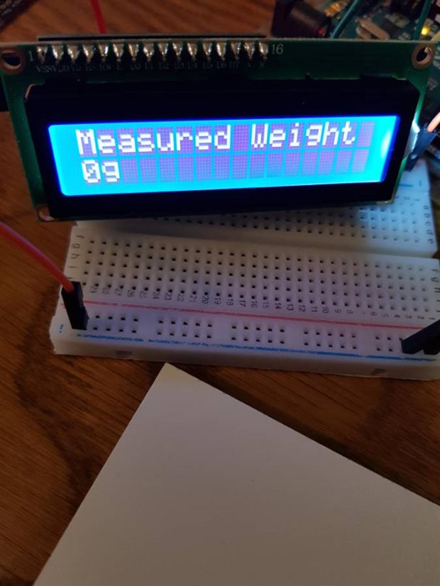

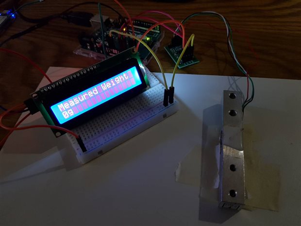

reset the scale to 0grams
No weight measurement. Sometimes some offset can be seen which have to be reset everytime
measuring other items such as cream.

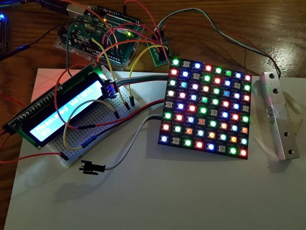

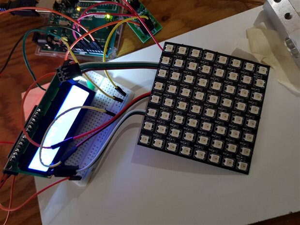

Adding the flex Panel LED array to the mix and connecting to Arduino
Working video with different messages to the flex-led panel

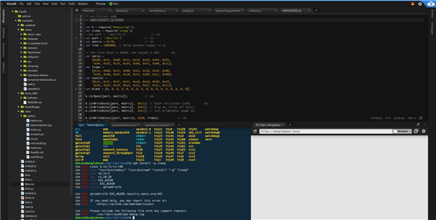

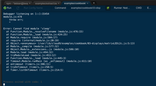

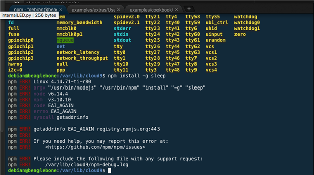

  • I tried to re-do the code with pocket beagle but without much success. Since the beagle IDE runs on the board itself there is needed to add a wifi dongle to install libraries on it. I also tried to use the flex panel with beagle bone but without much success so I decided to go with Arduino.
  • Another minor issue is that the load cell needs to be reset several times as sometimes it does show not so accurate results. I did several times the calibration of the load cell.

  • daz23079
    daz23079 over 7 years ago
    You won’t get accurate readings from this load cell because it is not mounted correctly it needs mounting feet 1 at the top and 1 at the bottom.
