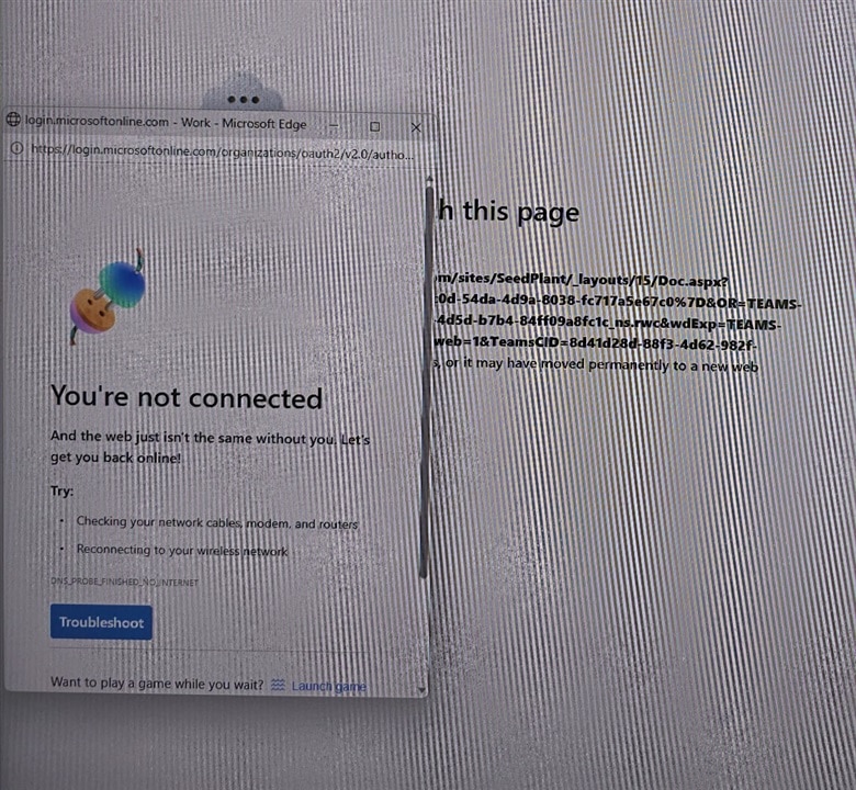

I had an IT itch that I needed to scratch. The yard supervisor met me at the office with his phone, he stated, “We’re performing seed-plant maintenance and received this message.” He showed me a screenshot of the control computer for the plant. Immediately I responded, “You don’t have a network. Let me take a look and I will let you know.”
All the golf carts used to ferry employees around the yard were gone. It was a walk or take my car the half kilometer to the seed-plant. How did I know it is half a kilometer? The point-to-point network elements that beam the network signal to that part of the yard indicate 600m.
While walking to the building, I pondered what could be wrong. I had used the network monitoring system in the office to examine that part of the network and it showed the switch for the plant was offline. When I arrived, I discovered the network switch didn’t have power. This issue stemmed from the UPS being offline.
The UPS was installed to prevent brownouts. The plant is at the far reaches of the yards AC power runs. Larger motors and industrial equipment powering up play havoc with the yard AC. Delicate equipment like computer had issues before the UPS was installed, frequent reboots or short network outages were normal.
Why was the UPS off? That question remained unanswered. My itch to know if and when such things happens motivated me to find a way to communicate with the UPS.

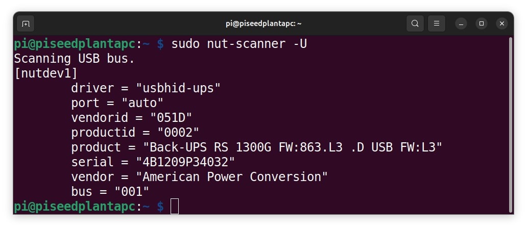

sudo nut-scanner -U             		#with the USB cable connected this gets information needed later

I judge the quality of a HOW-TO document on HOW-MUCH I need to change the HOW-TO in order to get the project working. I didn’t find one HOW-TO, that worked from start to finish. Gather nuts from each of the stashes of videos and Internet posts finally got my NUT working.
Below I have provided screenshots or code for the four files that I added configuration details to get the NUT working. The Pi needs to communicate with the UPS hardware in order to configure the NUT server. The NUT software provides a tool nut-scanner -U to make that USB query possible.

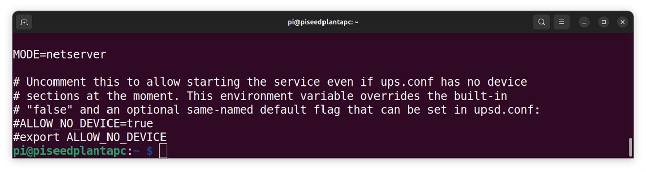

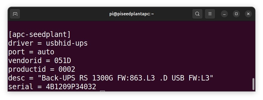

sudo cat /etc/nut/ups.conf Recall you queried the UPS for information. This is the file where that information goes. I just drop to the bottom of the file and start entering.

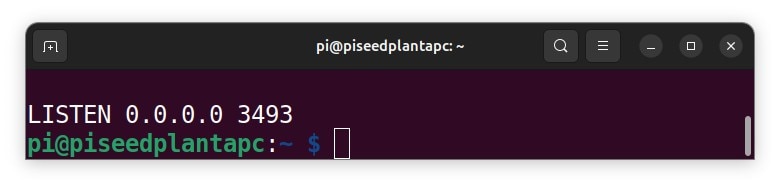

sudo cat /etc/nut/upsd.conf Setting up port requirements.
sudo cat /etc/nut/nut.conf You will find the MODE line inside this file. In mine it had <none>, I changed it to this value.
