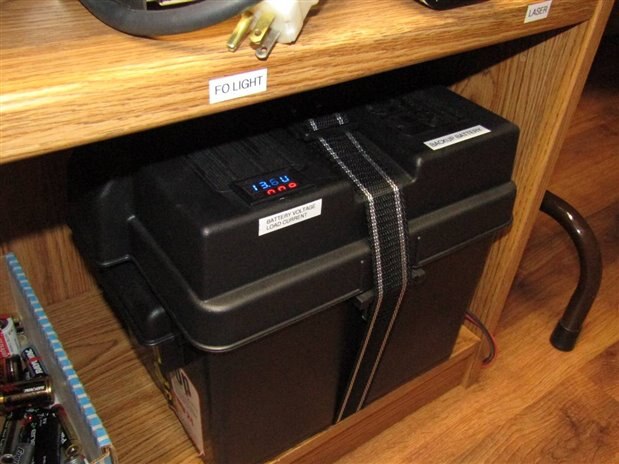

Here is the battery in its case with the volt/ammeter mounted in the cover. Every couple months I pull the mains electrical plug and let the system run for an hour or so. Two nights ago I performed this routine test but within 10 minutes the UPS was beeping frantically for power and before I could get to the mains plug it died.

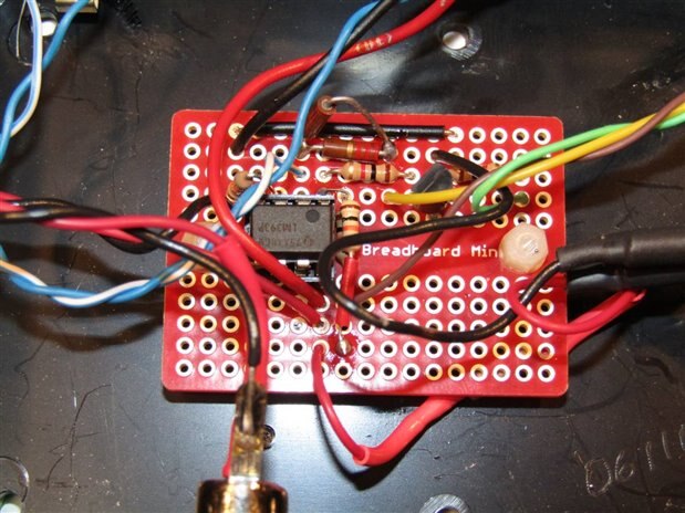

This was the inspiration that I needed to build an Interface for the PDT. As it sits the Process Duration Timer (PDT) was designed to monitor and time a voltage level and respond by stopping the clock when the monitored voltage level drops below a given threshold.
At its core the Interface is very simple with an LM393 comparitor, a MOSFET output and the required resistors and hardware needed to allow a sensor  to monitor a given process by watching other physical changes in the system and reporting back to the PDT with a High or Low voltage output which in turn is used to stop the timing of the process.

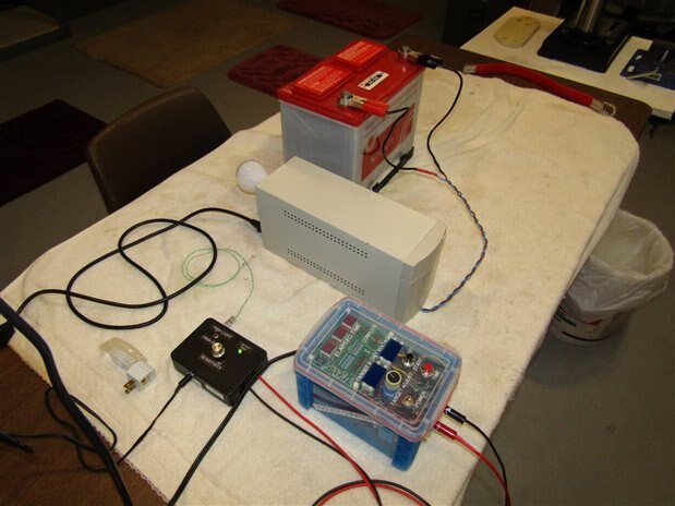

It was my plan to build the Interface and let its ability to monitor a light level watch the 75 Watt bulb on the output of the UPS that was being powered by the damaged battery. As long as the bulb was lit the interface would send 15 volts to the PDT and it would happily keep on timing the process of battery discharge. As soon as the battery level dropped below critical for the UPS operation however the bulb would go out and the interface would send a Low voltage signal to the PDT and the timer would stop and wait for me to return and read its output.

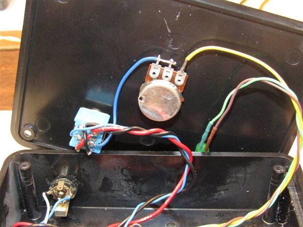

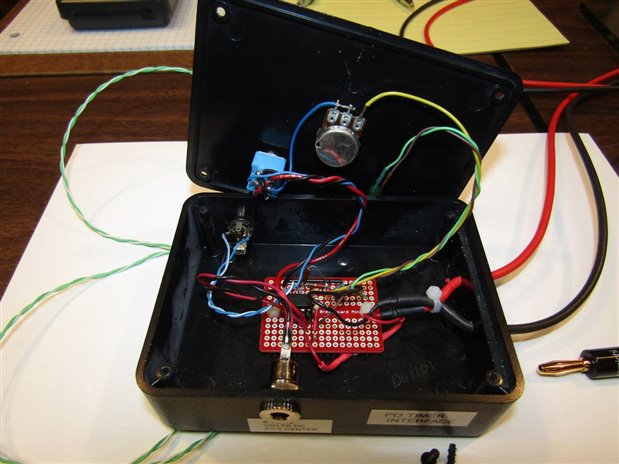

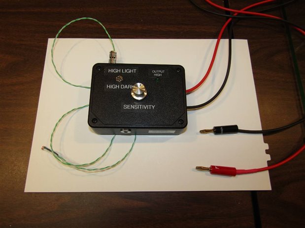

Before I get to the actual battery test however here are some picture of the Interface:
I am using a DPDT toggle switch on the unit to give me the flexibility to transition from High output to Low output on the Interface in either direction, Light to Dark, or Dark to Light. The LED tells the state of the output and the potentiometer allows the operator to adjust the sensitivity to fit local light conditions.

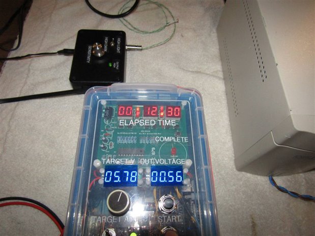

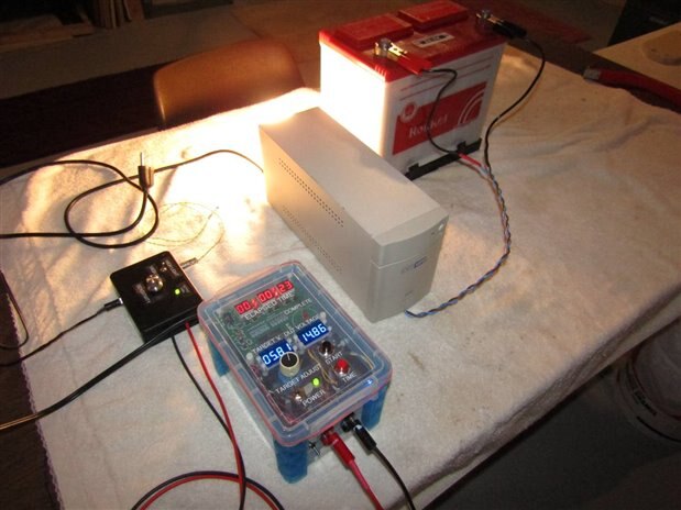

Here is a picture of the experiment set up. The battery has been charged for several hours and is showing all the signs that it is bad. The UPS is hooked to the battery and has a 75 Watt bulb plugged into one of its outlets. In a preparatory experiment I have measured the current demand on the battery to power the 75 Watt bulb. This turned out to be about 8.5 Amps. For some reason I don't understand right now the UPS's power demand is not stable but fluctuates +/- 1 amp while it is working. If anyone knows why please clue me in. The photo resistor sensor of the PDT Interface is pointed towards the 75 watt bulb. The Interface is set so that the output will transition from High output to Low output when the sensor no longer sees the light.
The PDT has been set to watch the Interface which should put out about 14.86 volts and continue timing the process until it sees less than 5.81 Volts.
The timer indicates that we are 1 minute 23 seconds into the test at this point.
We really did not have long to wait as 12 minutes and 30 seconds after the process started the battery gave up. If we do the math for 8.5 Amps over 12 minutes and 30 seconds we get about 1.7 Ah of power. For a battery that should have upwards of 45 Amp Hours this is a clear indication that the low fluid level has permanently damaged this battery beyond redemption.

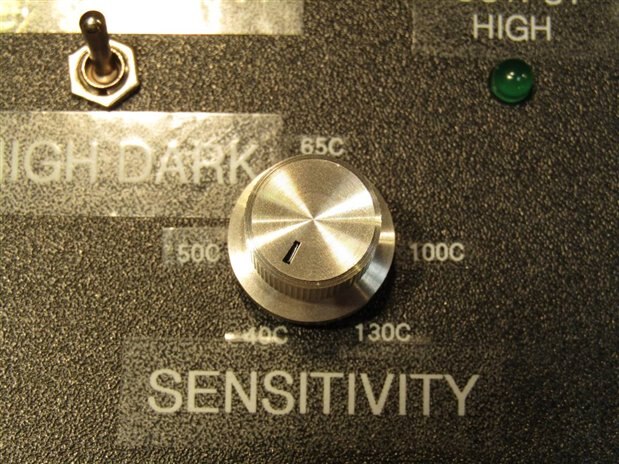

Since I was still in the mood to upgrade the Interface I also made a Thermistor Sensor for it. The thermistor was chosen to work with the Interface in the range of 40 C to 130 C as I guessed that this might be a range that would be usable for me. Now I will be able to monitor and time processes that involve things that gradually heat up or cool down.
The sensitivity control was labeled with approximate transition temperatures for future use of the thermistor sensor.

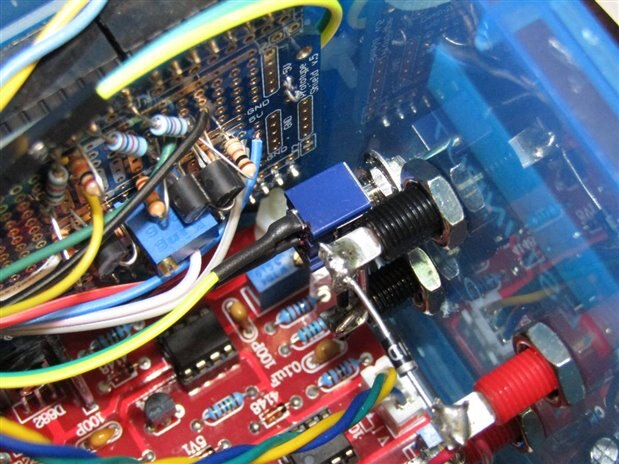

    I should probably start a new blog for this but you are all probably getting sick of my Process Duration Timer so I will add it to this stream. After I finished with the interface I saw another simple improvement that I could make to the PDT unit. Up until now the PDT only worked on situations where the voltage from the Device Under Test (DUT) was falling towards the Target Voltage. By adding a switch that the Arduino could read as High or Low I was able to add another Mode whereby the PDT can also process DUT voltages that are rising towards a Target Voltage. The software of the Arduino also had to have a simple upgrade to accommodate the reversed process. Here are some pictures of the upgrade:

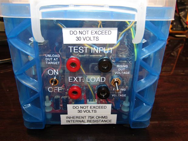

    A little hard to see but the blue SPST switch in the center of the picture will pull the 5 volts supplied by a 10K resistor on Pin 11 of the Arduino down to 0 volts when it is in the closed position. This directs the computer to process the input voltage data to the PDT as Rising or as Falling.
    A view of the end control panel of the PDT
    After I finished with the upgrade I performed a test of the unit. I set up an experiment with a 10,000 uF capacitor which the PDT monitored. I set the bench power supply to 10 volts and the Target voltage on the PDT to 6.32 volts which is one Time Constant. I selected 2 random 10K resistors from the bin. I then charged the capacitor through each resistor while the PDT monitored and timed the process as it went to the Target Voltage. Resistor "A" took 142 seconds and Resistor "B" took 145 seconds. The Ratio of Resistor "A" to Resistor "B" was 142 / 145. I next took an ohmmeter reading of Resistor "A" which turned out to be 9,869 Ohms. Using the ratio predicted by the PDT I calculated the value of Resistor "B" to be 10,077 Ohms. Finally I measured Resistor "B" and found that it was actually 10,038 Ohms. The reading of the PDT was therefore off by 0.4% which is acceptable for any experiment that I would likely do.
