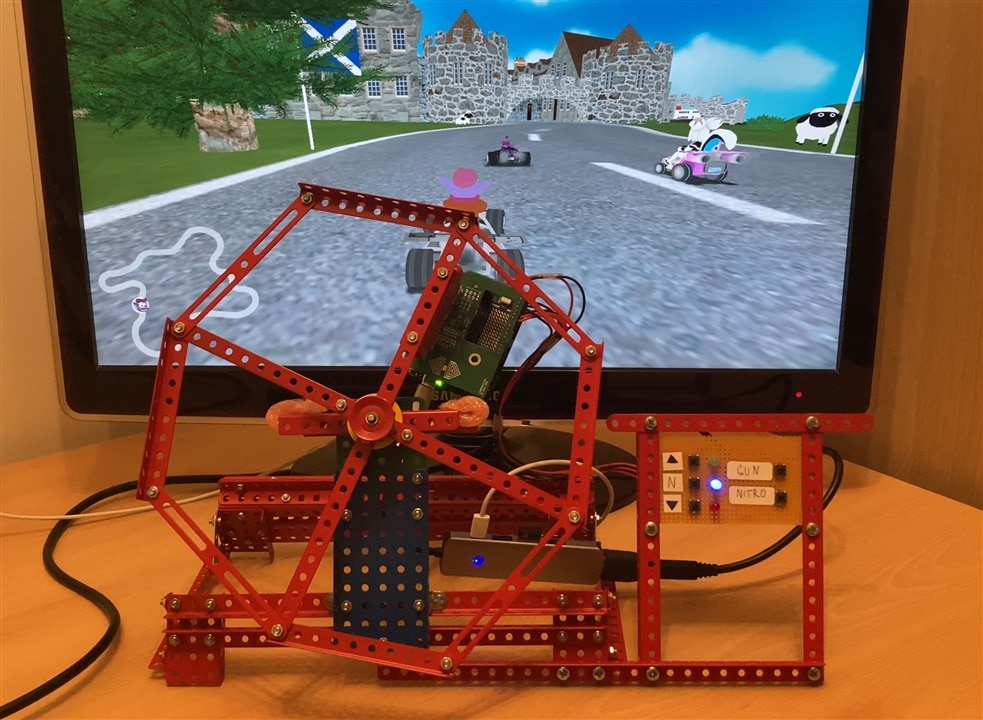

Hello Element14 community. As part of “Make a Connection” Project14 competition I made a SuperTuxKart racing console using Arduino Uno Q, Meccano like building set, my own gyroscope and accelerator shield, Linux driver and bunch of python script to connect everything together.
See it in the action
Mechanical Base
Mechanical base is built from building set called Merkur. It is very similar to Meccano well known in UK. Merkur is Czech (or Czechoslovak back in time) alternative to Meccano. They are more or less same, except pitch of holes is metric (10mm) in case of Merkur and imperial (12.7mm) in case of Meccano. Both building sets are from metal, so they are heavier than Lego for example, and build is also much more mechanical strong.

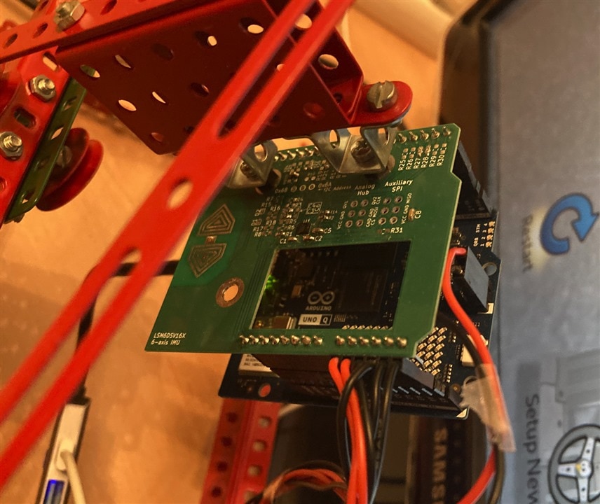

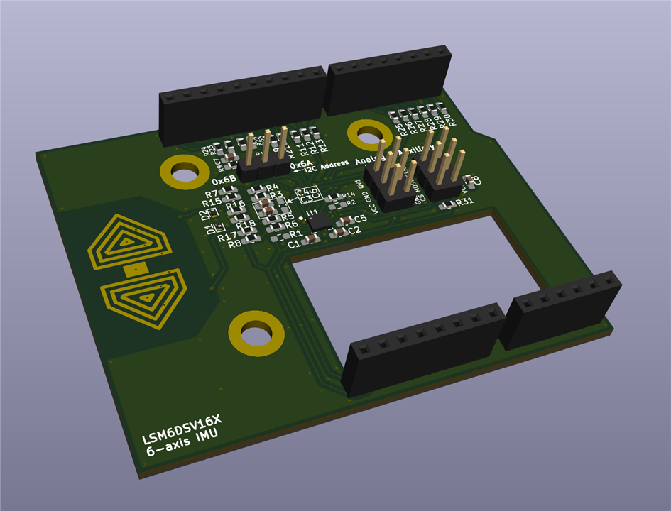

Gyroscope on Custom Arduino Shield
Motion detection is done by STM LSM6DSV16X 6-axis accelerometer and gyroscope. This is one of the most feature rich sensor in this category on the market. Inside the chip there are various engines which process data from raw sensor, auto calibrate it, and provide highly accurate mostly noise free data.
To get it to my Arduino Uno Q, I had to make my custom shied. I made shield utilizing nearly all it’s capabilities of the chip but not all are used in this application.
Designing custom shield allowed me to design it specially for Arduino Uno Q. I added holes perfectly fitting building set and add hole for making Uno Q matrix display visible.

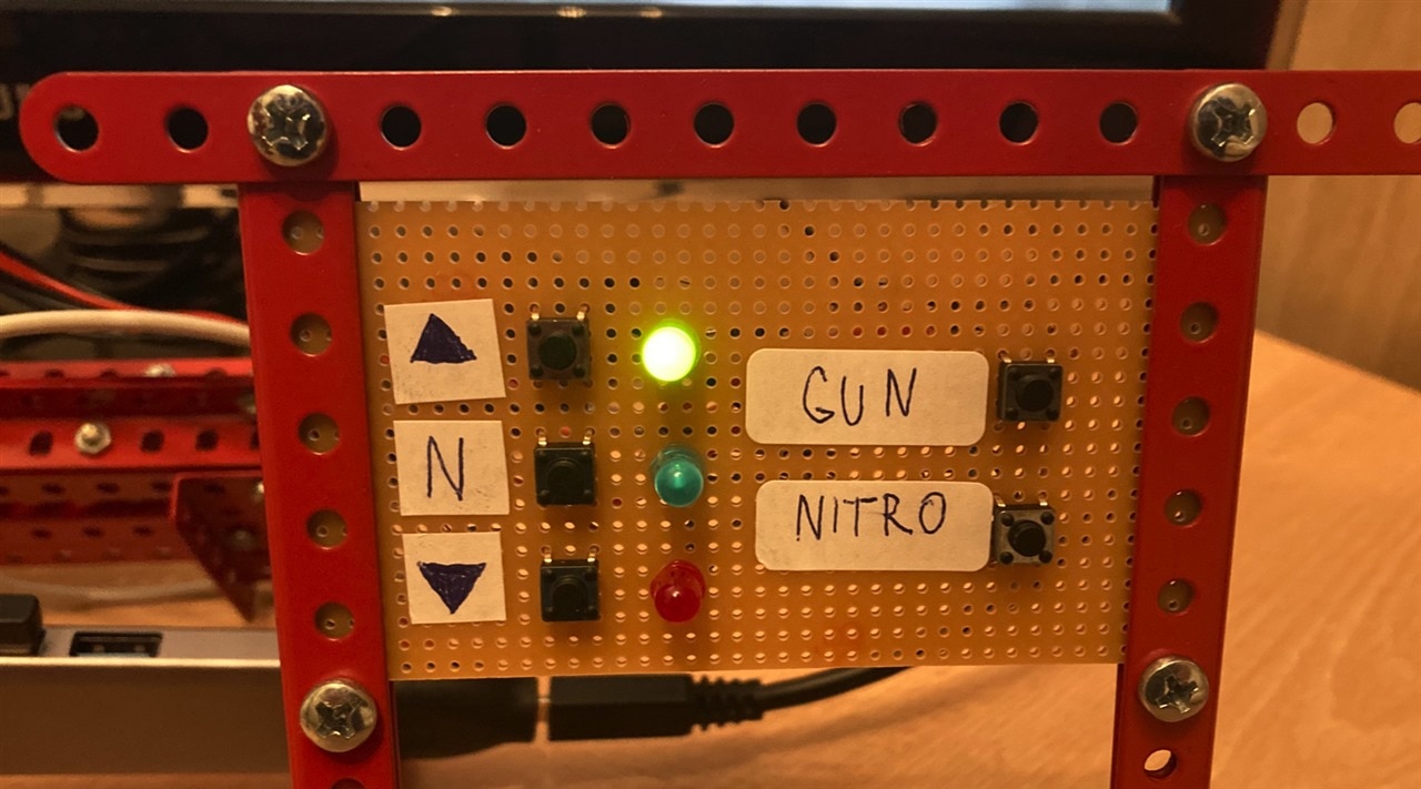

Control Panel
Except steering wheel I added simple control panel which allows selecting direction and activagin game functions Nitro and Gun.

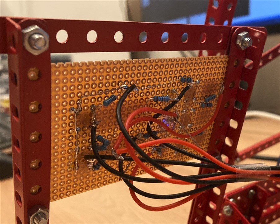

From back there are resistors forming resistor dividers allowing me connect multiple buttons to single pin on Arduino and detect pressed buttons using ADC.

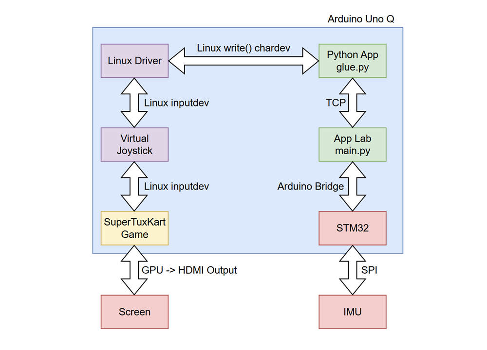

Connections
The hardest part was interconnecting all the layers.
  • STM32 (Arduino Sketch) connects to sensor via SPI
  • STM32 send data to python app in App Lab via Arduino Bridge connection
  • Game can’t run in App Lab container, so it is needed to export data from App Lab container to outside word. This is done via TCP socket since this is only option container can communicate outside.
  • Game do not understand this socket. Game gets data via virtual joystick device provided by Linux driver.
  • Linux driver also can’t connect to socket because of security.
  • There is additional python app (glue.py) which connects socket with driver by forwarding data between them.
  • Linux driver communicates two directions. On input it handles character device which it uses for receiving data from HW. On other side it provides input devices which is virtual joystick.
Following diagram show all the connection and flow:
