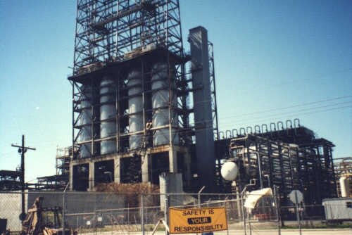

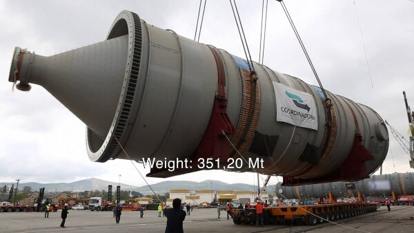

Coke Drums are big.  Believe it or not, they just keep getting bigger!
Refining Industry Coke Drum
Coke Drums in refining take the heaviest part of the crude that is left over in distilling and heats it up until it begins to break down (crack) into lighter compounds - the stuff that makes more money.  It was a process that matured back in WWII when the need to get every usable ounce of crude drove the technology.
They usually are built in sets of 4s so they can be ran through their cycles without interrupting the continuous process of the crude units.
A 4 Drum Coker
One thing to be aware of is that they grow.  Since they are cyclic, they go from ambient temperature to nearly 1000F every couple of days.  In turn, they grow when its hot and shrink back when its cold.  This can cause issues with attachments to the drum such as level and temperature transmitters.  If you put the attachment too close to a nearby permanent structure like a hand rail, as the drum grows, it could grow into the handrail, busting the transmitter or its attachment nozzle resulting in a horrible leak and fire.
This project grew out of necessity (pun intended).  At work, we wanted to replace a component at the bottom of the drum with one that had some attachments.  Gut tells you that it can't be growing much in that direction or it would have run into the floor and bottom out its spring can supports.  But, the question was asked and no one had true engineering data on the matter.  So, in the spirit of Makevember 2019, a project was born.  We're going to measure drum growth at different levels from bottom to top using an Arduino Mega solution.

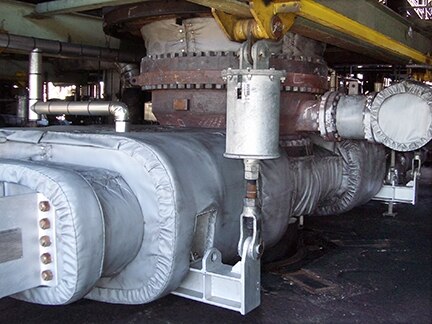

We stuck it under the Bottom Unheading Valve.  This is a picture of one from the manufacturers site:
Delta Valve - Bottom of Coke Drum

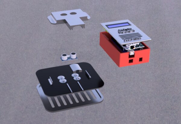

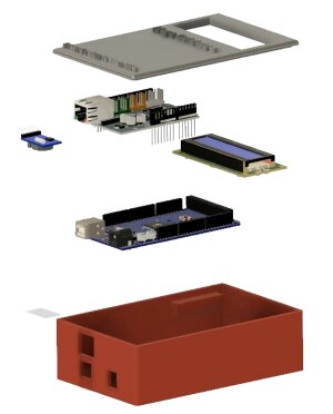

Autodesk Fusion 360 Exploded View of the Brains

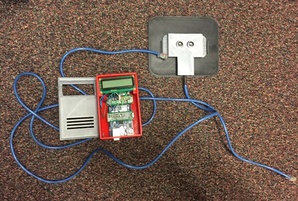

Autodesk Fusion 360 Exploded View of Sensor
The sensor side (on the left) looks pretty crazy, I know.  What you have is a base made to hold 1/8" plate of steel to give it some mass.  The vents in the bottom were put in just to save material.  The black part pictured is just the lid of the base, but it has some bosses on it so screws can secure the proximity sensor while giving clearance to the proximity sensors underside components.  The black part also has two tabs.  These allow the cover on top to snap in place.  There is also a separate cable stress relief piece floating around there.  It was printed separately so I could replace it for different cable sizes.  That cover simply snaps to the base lid for a unique look.  Most importantly, it doesn't simply blow away.

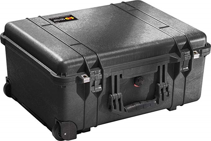

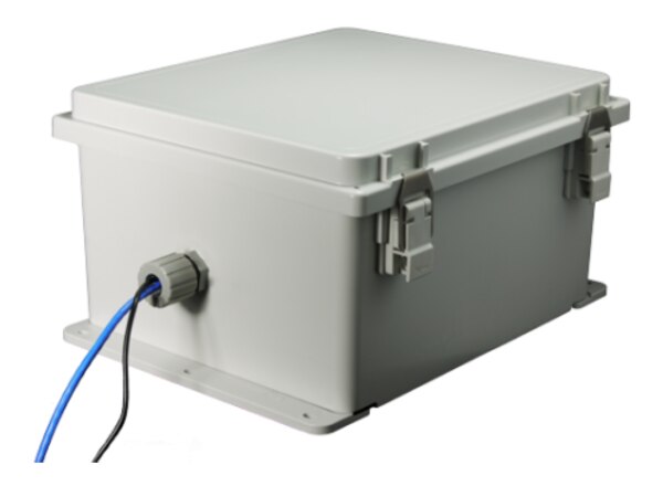

To protect the brains from the weather, I installed it in a Class I Div II Enclosure which then was put into a Pelican Case.  The Pelican Case has a port that allows me to connect the sensor to the case.  The port on the inside allows the brains to then connect to it.
Weather Tight Pelican Case
NEMA Enclosure for Class I, Div 2 Areas

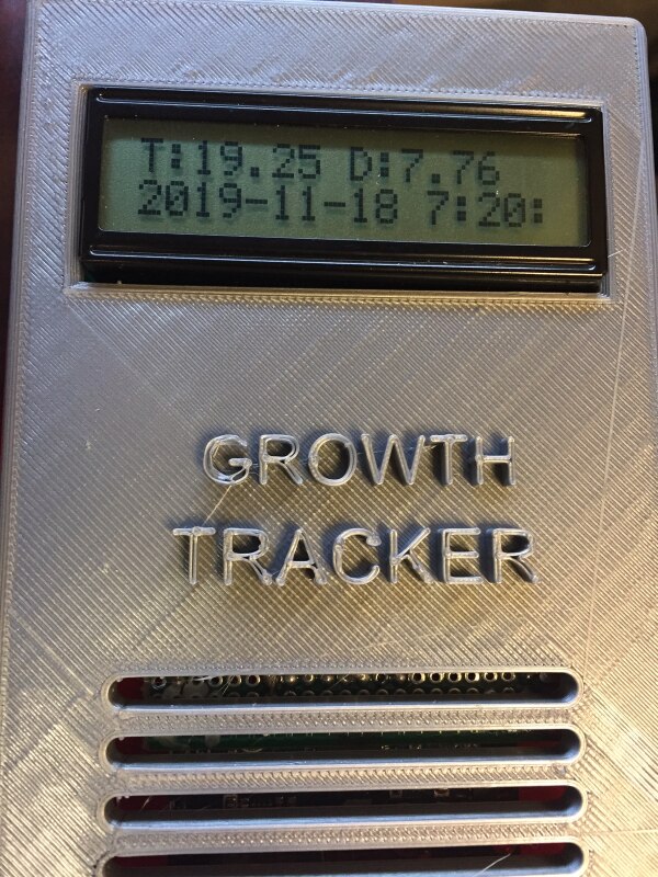

FINISHED PRODUCT
To connect the proximity sensor and LCD, both using I2C communication, I made a two daughter boards you can see if you zoom in below.  These were just protoboards to allow for wire-to-board connectors to hook up the sub components.  I liked the reliability and ease of an ethernet cord.  Since I had some cable, connectors, and crimpers handy, I crimped some custom length cables to connect the sensor to the suitcase and the suitcase to the Arduino stored within a NEMA enclosure.
Growth Tracker in Real Life
Growth Tracker Showing an Active Measurement

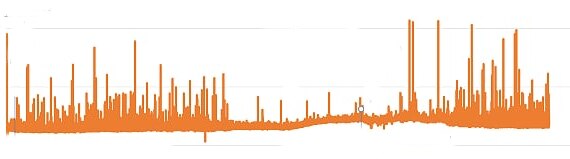

The data was absolutely useful.  I stripped it down for academic discussion of the trend without giving units, scale, or time.  You'll have to do it on your own if you want all that or join my team.  :-)
Academic Version of the Data
A few observations:
  • Due to the dusty environment, many readings showed error.  However, the error couldn't be more convenient in that it rarely can error lower than the actual distance.  This is because when it fails, its because the fastest path for the sound to get back was obstructed and a relfection (which is a longer path back) was recorded instead.  In turn, I just need to look at the bottom of the data.  It is a great smooth trend following process physical conditions of the drum showing healthy movement in a safe range.
  • The bottom trend against temperature of the process (not on this graph) can tell you if you have an unhealthy mechanical stop.  Stoving up the bottom of the drum can lead to cracks on the drum skirt that pins it down to the building structure.  If that were the case, my next step would be to inspect the large can and its buddies to ensure they are not gagged or at their max compression in the cold empty state.
Delta Valve From their Website.
Note the Spring Can in the Middle - it can cause problems restricting drum growth.

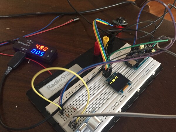

PROTOTYPE #2
I was very happy with how easily I was able to get this data.  So much - I'm working on prototype #2 with the Arduino MKR Zero over the holiday - it is Makevember, after all.image
Growth Track 2.0 Under Development
This version cuts the running power from 160mA to 60mA.  In addition, I can enter a sleep state that I wake up from periodically either via Real Time Clock trigger or by the MKR built in code functionality.
Now that I've seen the rate that the data changes by physics, I know I can also just take data every 30 seconds versus every second.  So, I'll wake it up every 30, take 5 readings, record the lowest, and then go back to sleep.
With this new design, I'll easily get over a week of battery life allowing me to get multiple drum cycles recorded without having to ever visit the structure in between.  That's easier on me, the operator, and the engineers.  Awesome!!
