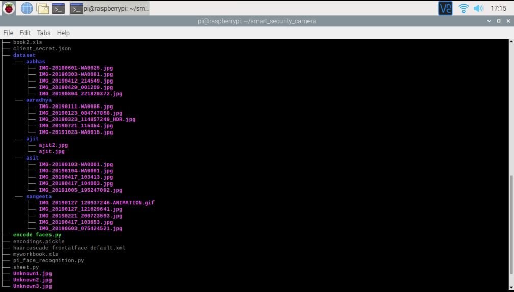

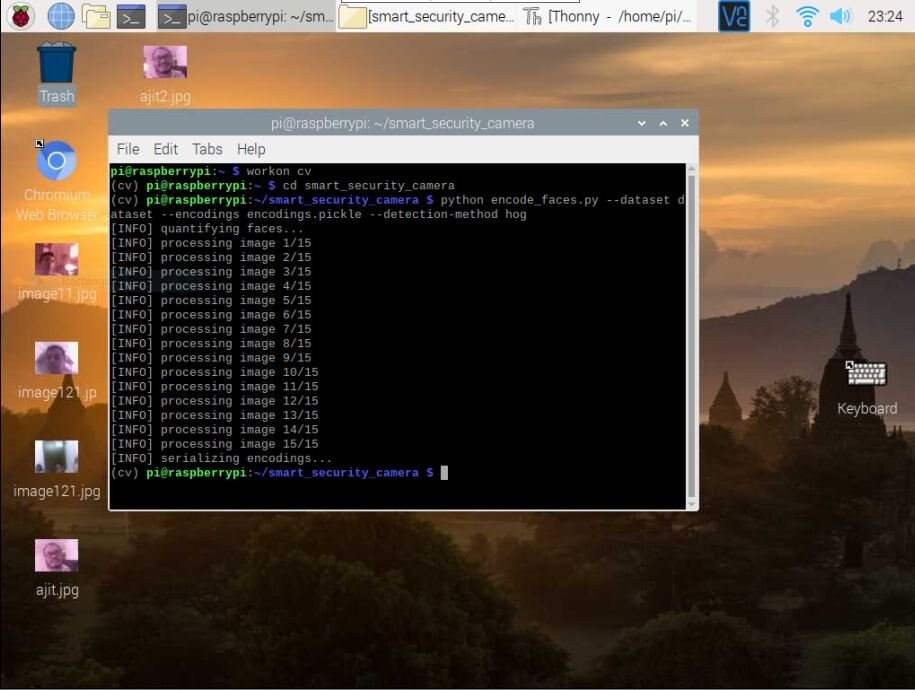

you need to then replace the dataset with your desired dataset 5 images per person is sufficient, then you need to run the encode_faces.py
$ python encode_faces.py --dataset dataset --encodings encodings.pickle \
 --detection-method hog

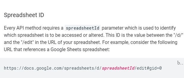

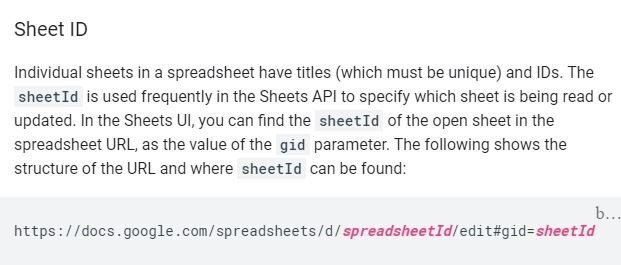

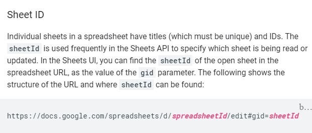

the next step is to get the client_secret.json file from google sheets API to use it to upload data onto google sheets by following the steps below, then place the client_secret.json file in the smart_security_camera directory.
The next step is to get the Spreadsheet ID and Sheet ID of your google sheet worksheet where you want the data and replace it in the code in face_reconition.py and sheet.py files.

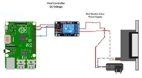

the next step is to connect the relay 5v and GND pin with  VCC and GND of raspberry pi and signal pin of the relay with GPIO pin 18 and connect it with your electromagnetic lock as a switch connection

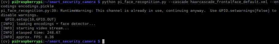

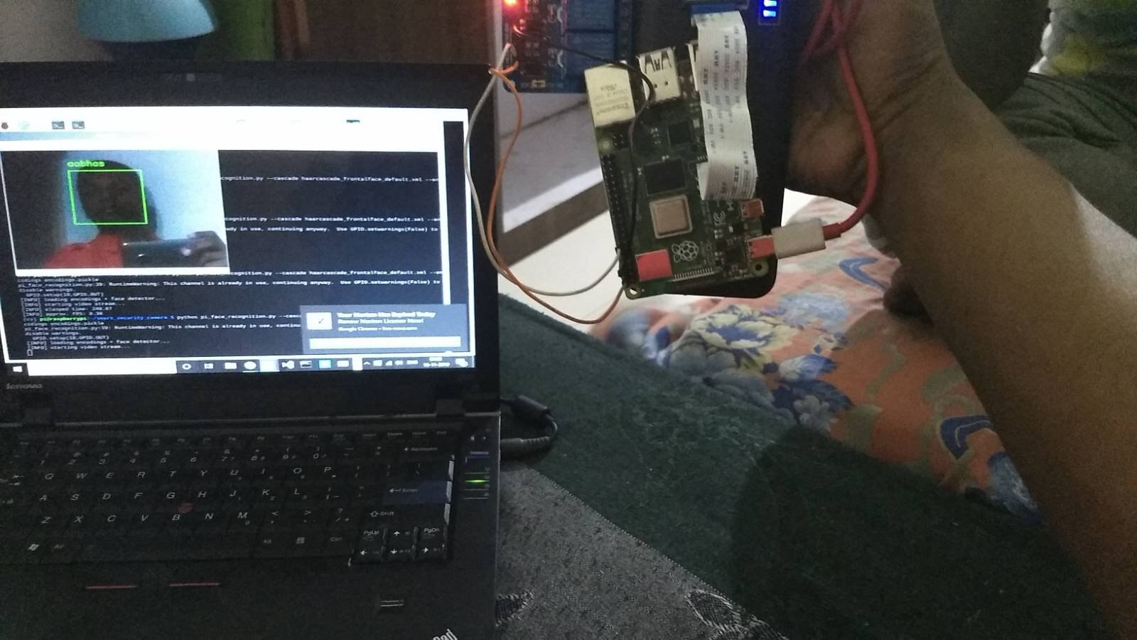

USAGEimage
good frame rate about 8.5 frames per second was achievedimage

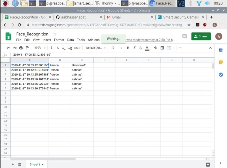

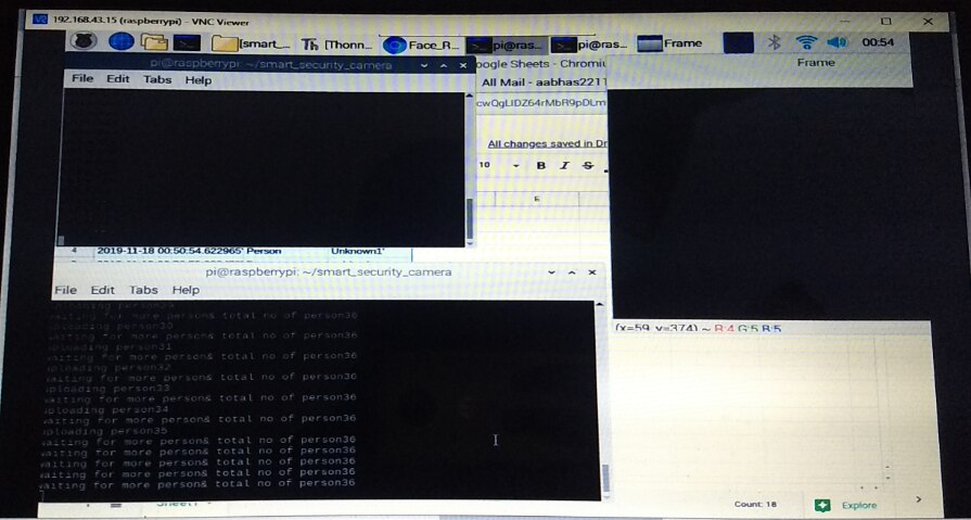

the python script uploading data to google sheets
the relay turns on when a known person is detected

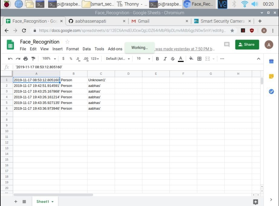

data on google sheets

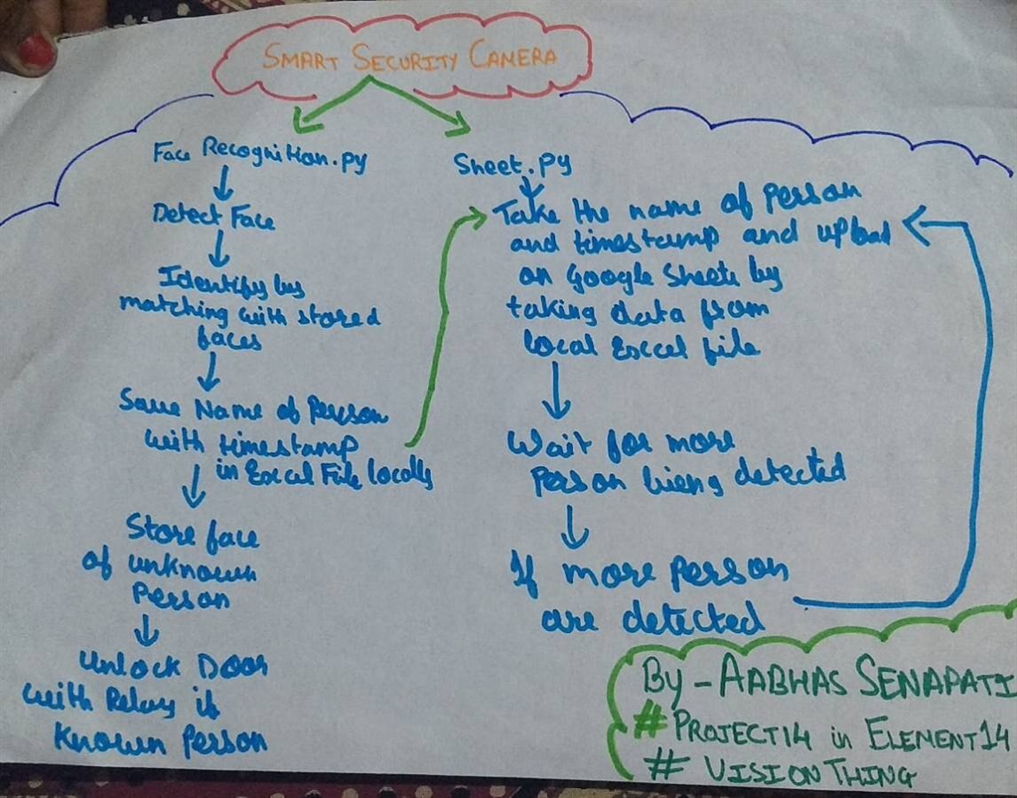

The two essential part of the entire project is the pi_face_recognition.py and sheet.py python file. In the broader aspect, the pi_face_recognition.py file does the face recognition and stores it locally while the sheet.py takes this data and uploads it to Google Sheets.
Working of pi_face_recognition.py:-
The first tas is to use the encodings of the faces and determine that is there any face in the frame, then the next task is that it does is that it checks with each and every face to identify whose face it is or is it an unknown face then it draws a bounding box around the face and if an unknown face is detected it stores that frame with numbering the unknown face serially, then the last task is that it stores this data locally to an excel file.
Working of sheet.py:-
The task of this script is to take the data from the locally saved file and upload it onto Google Sheets with data who was at the door and at what time and date.
