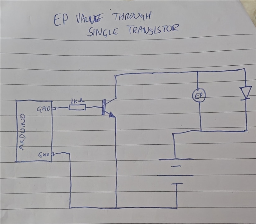

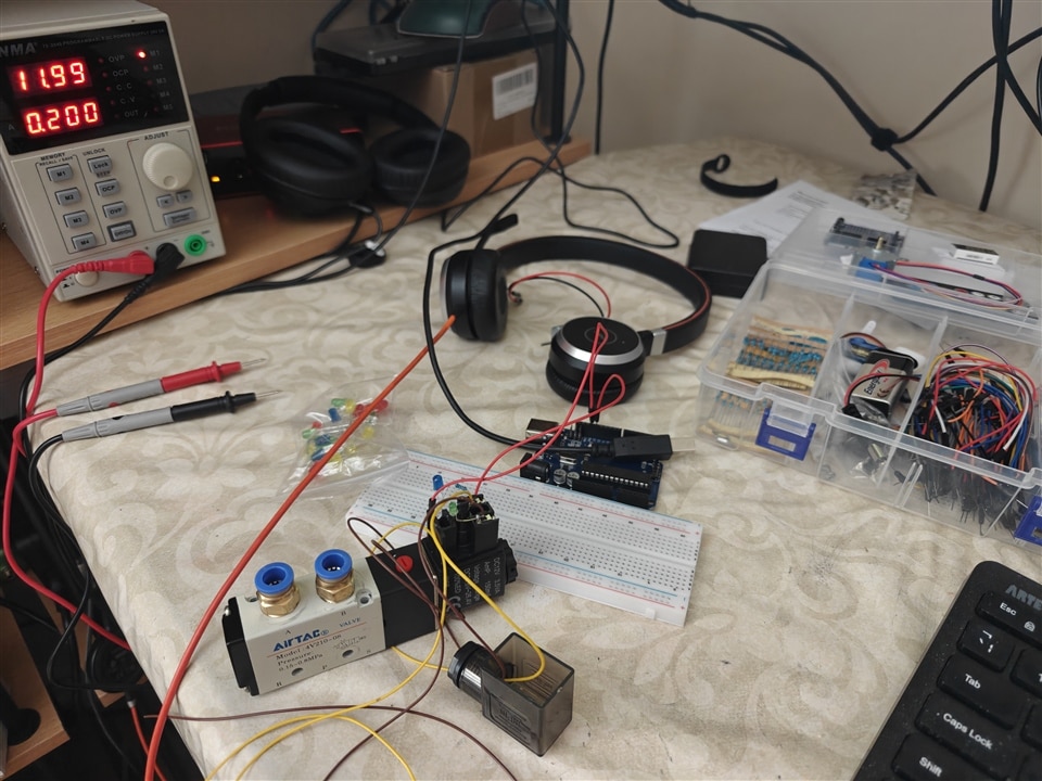

2. First challenge: the electro-pneumatic valves
I started with the electro-pneumatic valves because they looked interesting. They are pneumatic valves operated electrically by a solenoid, and they ended up causing more head-scratching than any other component in the project.
The valves were labelled Airtac 4V210-08. The markings on them did not make the supply requirements immediately obvious:
Valve markings
• DC12V 3.5VA
• AmP 150mA
• Voltage range: DC21.6V to 26.4V
• 100% ED
That raised the obvious question: were they 12V devices or 24V devices? I searched Airtac's website, but I could not find this exact variant with markings that matched the valves in front of me.
My first circuit used a transistor to switch a valve from the Arduino. I set the bench supply to 12V with a fairly low current limit, uploaded a small test program and heard a very satisfying click. Success. Or so I thought.
My first hand-drawn idea for switching one electro-pneumatic valve through a transistor.
As I added more valves, the clicks became distinctly less enthusiastic. Eventually I was not sure they were moving properly at all. I took a spare valve and slowly increased the supply voltage. At around 24V it snapped open and closed confidently, and with four valves connected they all worked. At the time, that seemed to settle the matter: I designed the rest of the prototype around 24V. This decision would come back to bite me later.

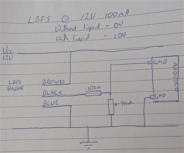

3. Testing the LBFS liquid level sensor
Next came the Baumer LBFS liquid level sensor. This was a much more expensive and sensitive bit of kit. In our application its job was simple: keep watching the beer level and tell the Arduino when the can had reached the correct fill height so the beer could be shut off.
Unlike the valves, the sensor could feed directly into the Arduino input. I wrote a small test program and used a glass of water on the bench. The Arduino serial monitor changed state as I dipped the sensor into the water and removed it again, which was exactly what I needed to see.

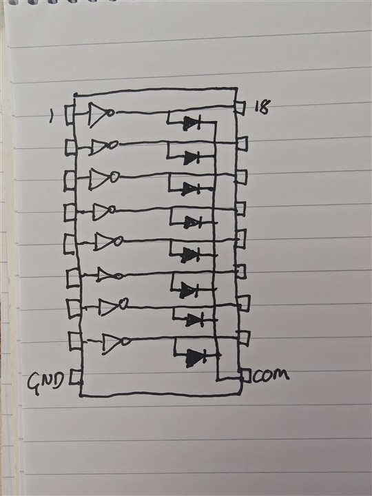

6. The neat solution that got very hot
At this point I started wondering whether there was a tidier way to switch everything. My original approach meant using a separate transistor for each output, and I was heading towards seven of them. An integrated driver looked much neater, so I tried a ULN2803.
The ULN2803 Integrated circuit contains eight pairs of Darlington transistors.  It features built-in diodes to protect against voltage spikes.
imageA very rough sketch of a ULN2803, showing the 8 transistors, protected with diodes
With only a few components connected it looked promising. Then I added the fourth electro-pneumatic valve. The ULN2803 decided it had contributed quite enough to the project and retired at a fairly impressive temperature. Lesson learned.
The ULN2803 experiment. It looked like a neat way to replace several separate transistors, right up until it became the hottest component on the bench.
After checking the requirements properly, I went back to individual switching devices and compared IRLZ44N and IRFZ44N MOSFETs. I settled on the IRLZ44N. It was more than I strictly needed, but the final electronics would live in an enclosed space with very little ventilation, so running cool mattered more than shaving a few pence off the parts list.

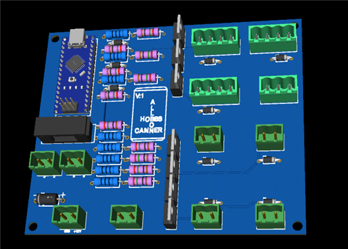

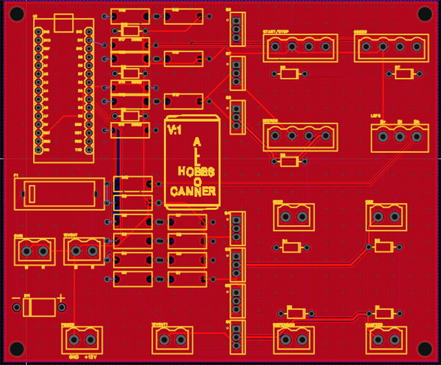

10. PCB layout: making it serviceable
The PCB itself went through a lot of iterations. I wanted more than just a board that worked. If something failed later, I did not want to have to desolder half the machine to fix it.
The Arduino Nano therefore sits in pin headers rather than being soldered permanently to the board. The external wiring uses plug-in connectors instead of wires being soldered directly to the PCB. That makes the controller much easier to remove, reprogram or repair.
Final PCB layout in EasyEDA.
 EasyEDA's 3D mock-up of the populated board.

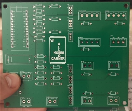

11. Sending the board away: no undo button
I spent several weeks checking every component, trace and copper pour. This was the first PCB I had designed at this level, and software development had given me a bad habit: if code is wrong, I can edit it and try again. A manufactured circuit board is less forgiving.
Eventually I uploaded the files to JLCPCB. Their checks said the design looked valid, which was reassuring. Then I clicked Pay. That was the moment the project stopped being a drawing on my screen and became something I was going to have to solder together.
The boards arrived remarkably quickly, about five days from China to England if I remember correctly. I used one of the spare boards as a practice run and immediately discovered that the soldering iron tip I had chosen was not ideal for the larger transistor pins. That practice board paid for itself. I changed the tip, moved on to another board and built the final controller.
The bare PCB on the day it arrived.
The finished controller board with the buck converter connected below it.

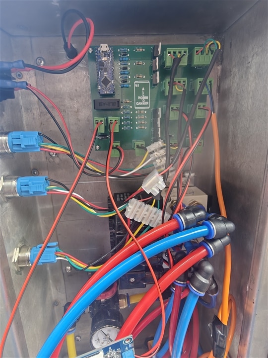

12. Into the canning machine
With the controller assembled, I connected every switch, sensor and valve. The wiring looked slightly alarming at first because we had deliberately left generous lengths while developing on the breadboard. Tidying could come later. The first job was to find out whether the board actually worked.
First installation test. The wiring was still deliberately long from the breadboard stage, so elegance had not yet entered the building.
I powered the machine up and the buttons lit as planned. After spending weeks checking the PCB, I pressed the cycle button with rather more nerves than should really be attached to one push switch. By some miracle, it worked.
For the first full test we used water rather than beer. The cans moved along the line, the dispensing arm lowered, CO2 was released for four seconds into one can while water was dispensed into the next, and the fill continued until it reached the LBFS sensor. The machine then stopped the liquid flow, raised the dispensing arm and completed the cycle. The filled can could then be passed to a separate machine to have its lid fitted.
Once I knew the controller was doing its job, I shortened and tidied the wiring and screwed the PCB into its permanent position inside the machine.
The final controller installed inside the machine. On the left are the power, beer enable, CO2 enable and cycle switches. The pneumatic lines sit below the controller.
