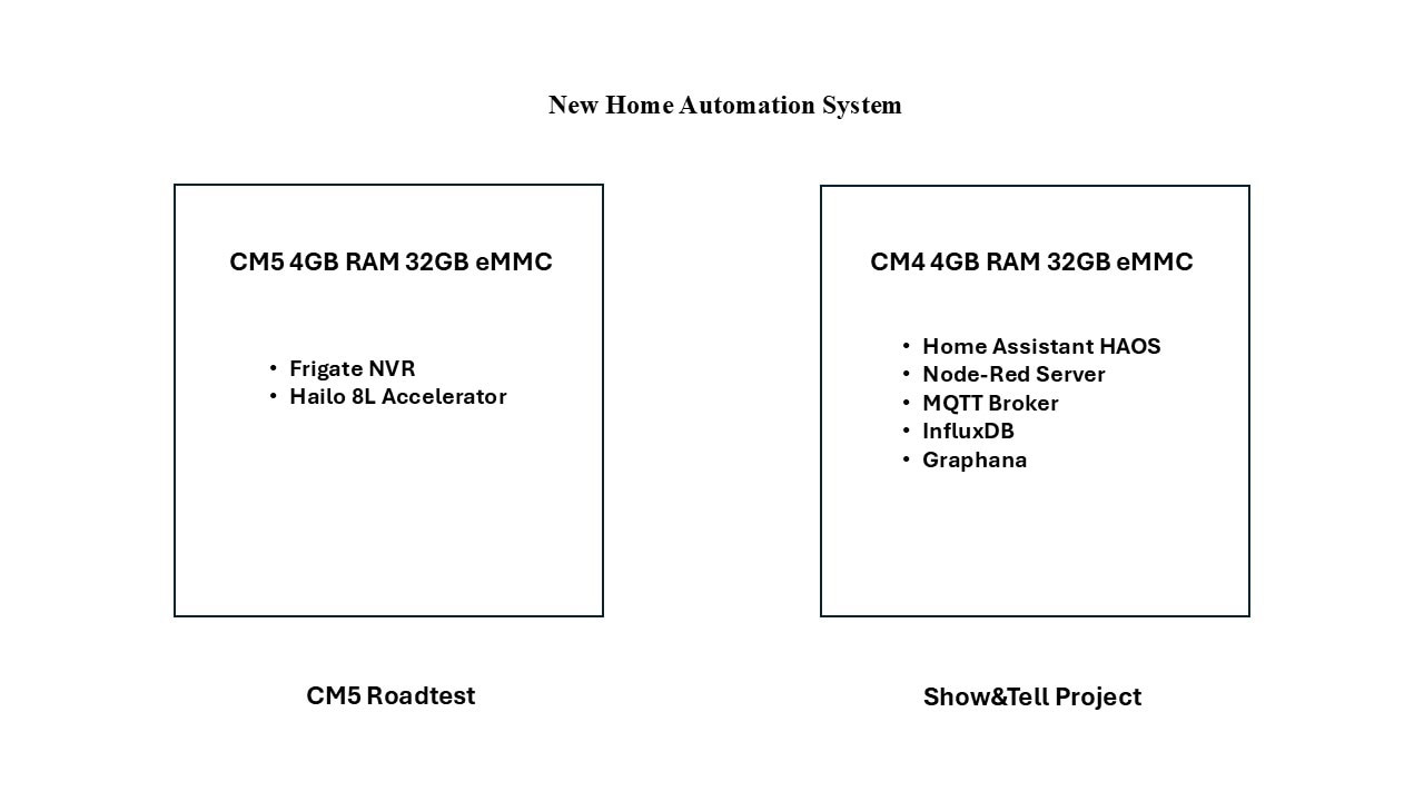

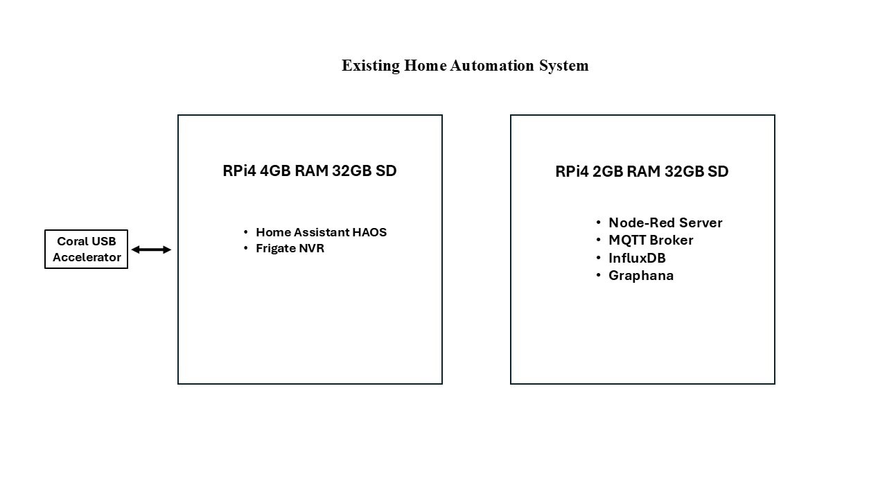

In assessing my existing function partitioning, I decided that I would take this opportunity to reorganize my system configuration.  Here are diagrams of my existing setup and my restructured one.
My existing setup evolved over time.  I originally had a requirement to create local dashboards for my environment sensors (temperature, humidity), so I started using an RPi4 with Node-Red and MQTT for messaging.  Then I added database and graphing capability for analysis.  Later I wanted a home automation tool that I could use to aggregate control for switches and lights from the various vendors and their apps, so I added another RPi4 flashed with Home Assistant (HAOS).  Then I wanted to add object detection and storage for my security cameras, so I added the Frigate add-on to Home Assistant.  Then I added a Coral USB AI accelerator to improve detection performance.  One thing that I learned from this setup is that I had difficulty adding more than a couple of cameras before it started to impact the operation of Home Assistant.  Therefore, I will partition the new setup with a CM5 dedicated to running Frigate (this is the RoadTest kit).  And use a separate CM4 for HAOS and the other utilities (Node-Red, etc) will be HA add-ons.  The CM4 setup is the subject of this Show&Tell project.

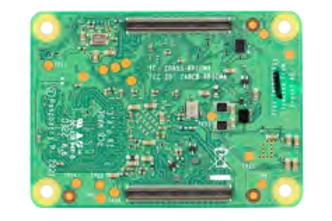

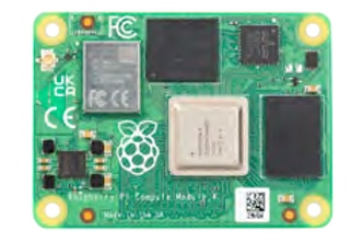

 RPi CM4 with HAOS
 CM4104032
Specification Details
Processor Broadcom BCM2711 quad-core Cortex-A72 (ARM v8) 64-bit SoC @ 1.5GHz
Memory 4GB LPDDR4
Storage 32GB eMMC
Connectivity Optional wireless LAN, 2.4GHz and 5.0GHz IEEE 802.11b/g/n/ac wireless, Bluetooth 5.0, BLE with onboard and external antenna options
  Onboard Gigabit Ethernet PHY supporting IEEE1588
  1 × USB 2.0 interface
  PCIe Gen 2 x1 interface
  28 GPIO signals
  SD card interface for SD card or external eMMC
Video Dual HDMI interface (up to 4Kp60 supported)
  2-lane MIPI DSI display interface
  2-lane MIPI CSI camera interface
  4-lane MIPI DSI display interface
  4-lane MIPI CSI camera interface
Multimedia H.265 (4Kp60 decode); H.264 (1080p60 decode, 1080p30 encode); OpenGL ES 3.0 graphics
Input power 5V DC
Operating temperature 0 to +80°C
Dimensions 55 mm × 40 mm

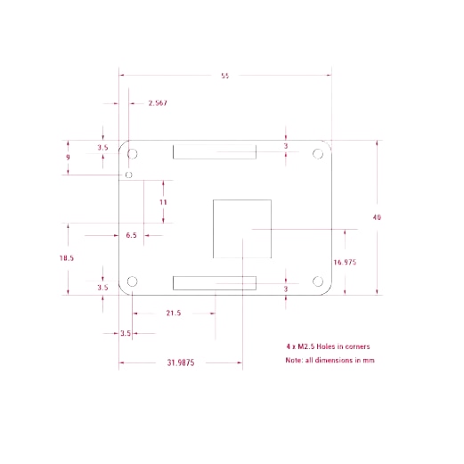

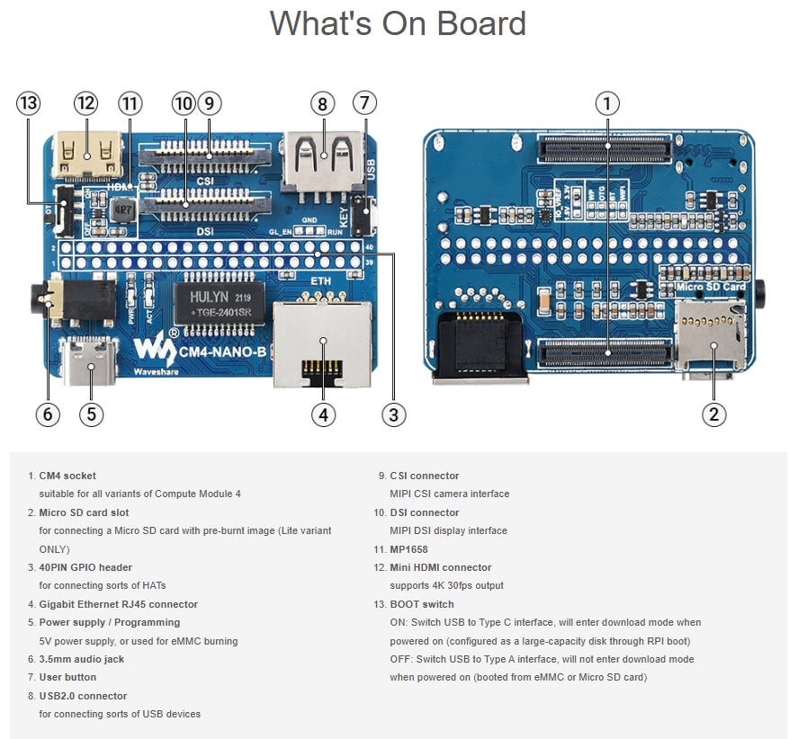

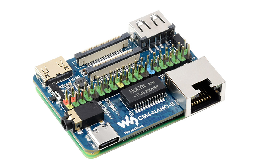

Waveshare CM4-Nano-B Carrier Board
I am using a Waveshare Carrier that has the same footprint as the CM4 to provide a very compact assembly.

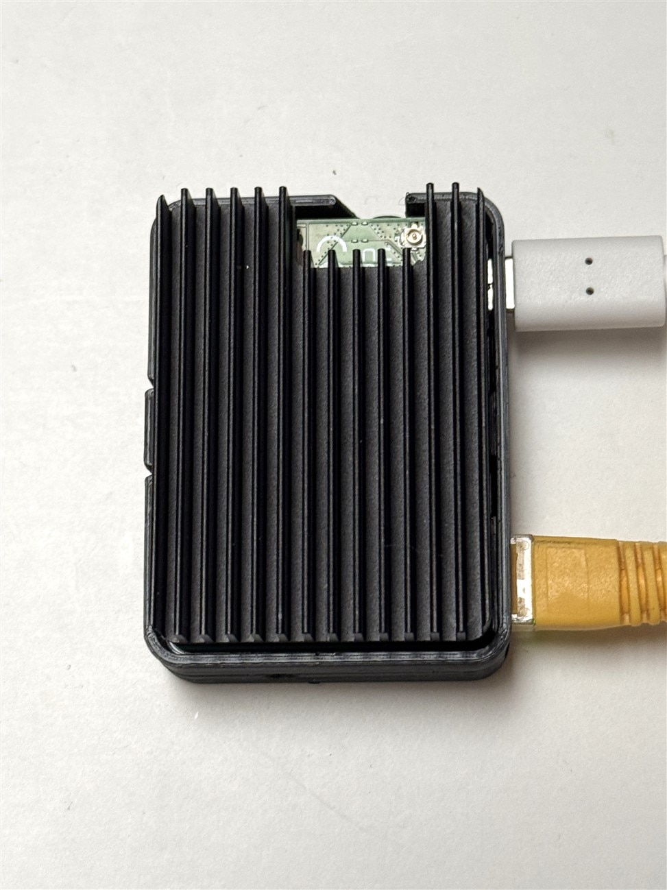

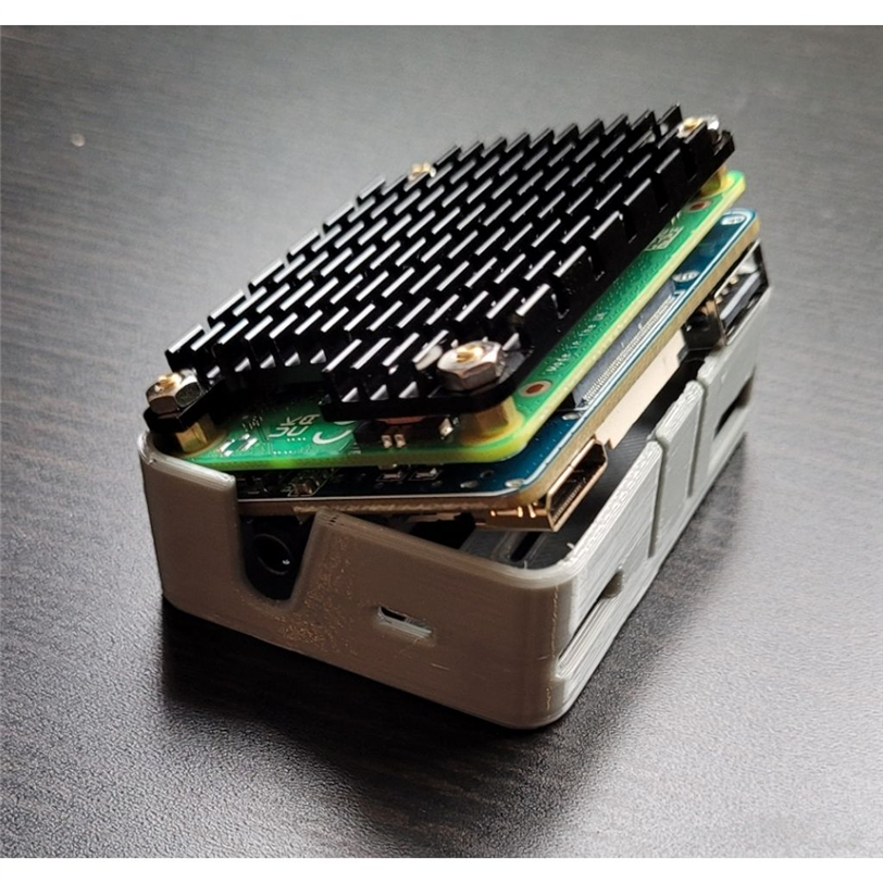

3D printed enclosure with CM4+Carrier+Heatsink
I found a 3D file on Thingiverse, PI_CM_WS_nano_b_case.stl, that I could use with with the carrier board and passive heatsink.  I am not doing any heavy computational work, so the passive heatsink should be fine (might not even be needed).  When I was running HAOS with Frigate I used active cooling with a heatsink and fan.
I hadn't intended to post this project until I saw the Show&Tell competition, so I don't have the disassembled view (it's a snap fit in the enclosure which makes it somewhat difficult to easily take it apart once the heatsink is added).  Below are pics of the ports on the case.
Top view looking down at the heatsink
  • Yellow cable is Ethernet (using it rather than WiFi for improved reliability)
  • White cable is USB-C power (using 5V 3A RPi power adapter)
  • uFL WiFi antenna connector is available but not used
Bottom view
  • 40p GPIO connector
  • CSI connector
  • DSI connector
Side view
  • Mini HDMI connector
  • USB-A host connector
  • Latch to hold assembly in case
Side view
  • Ethernet RJ-45 connector
  • USB-C power connector
  • SD card socket above USB-C (easier to see in next pic)
Side view
  • Audio jack
  • Boot switch
Side view
  • User button

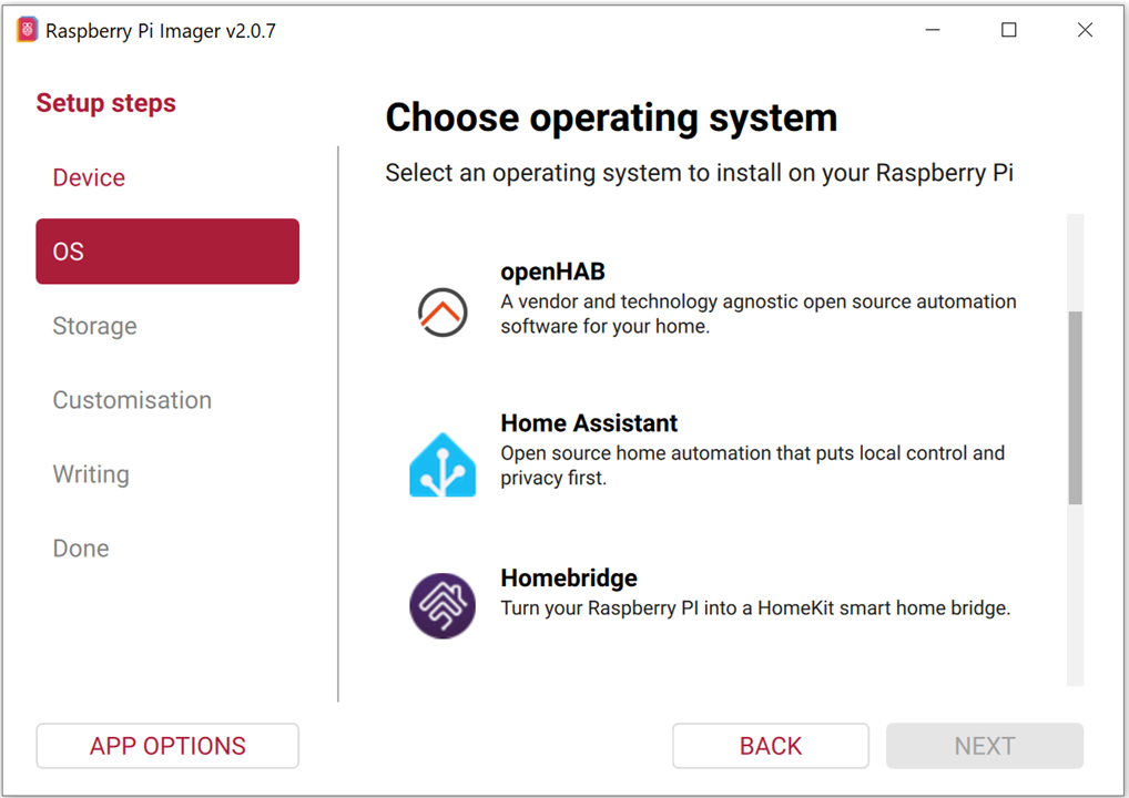

The good news is that the Raspberry Pi Imager can be used to flash HAOS onto the eMMC card.  There's a couple of extra steps involved because we are writing eMMC rather than an SD card.  There is an additional usbboot (rpiboot) utility required to expose the eMMC as a normal drive for writing.  You also need to set the Boot switch on the carrier board for this mode.  The instructions are straightforward and I did not have any issues.  The one caveat is that the USB-C port is being used to both power and flash the CM4 so the host computer port needs to have sufficient power or you'll need to add a powered USB hub.  I used the USB3 port on a Windows desktop without any issues (rated at 900 mA).

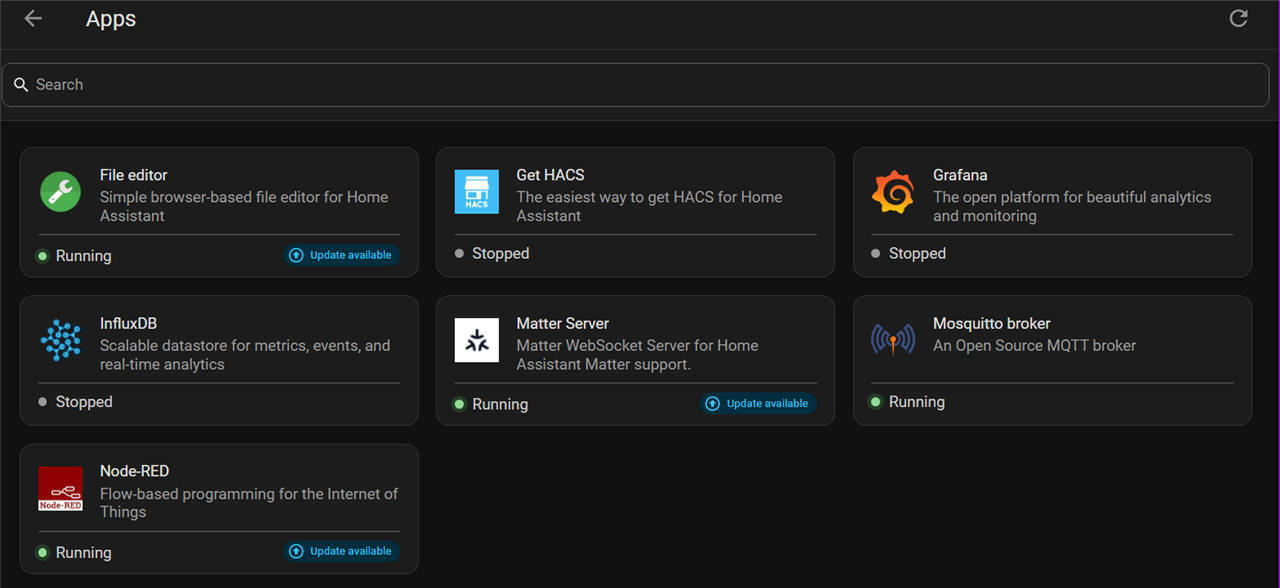

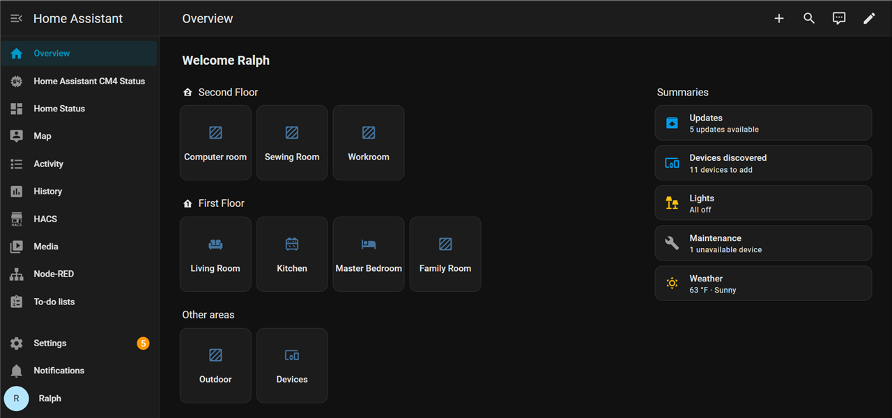

I won't go through all the setup and configuration steps as these are well documented.  You are required to create a User account with name and password.  And it is also necessary to install HACS (Home Assistant Community Store) to get Node-Red, InfluxDB, and Grafana.  MQTT is a standard (official) add-on.
Home Assistant Home Page
Installed Apps

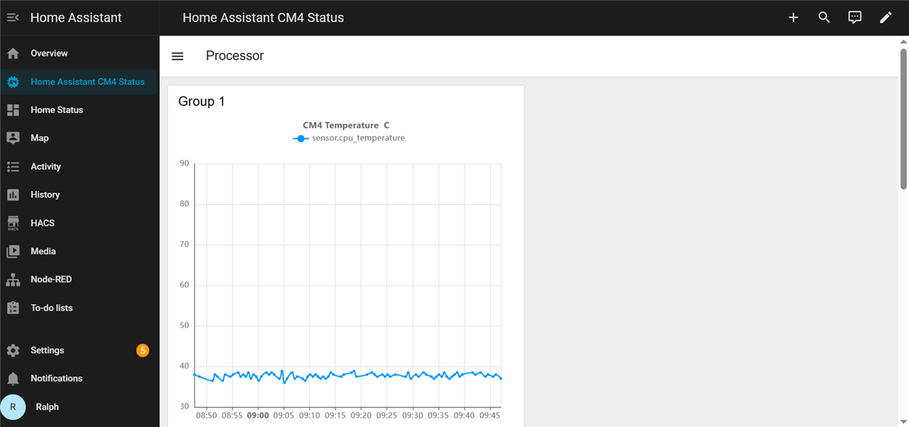

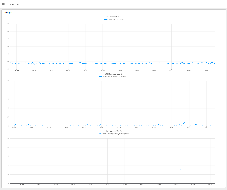

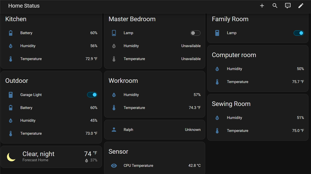

CM4 Status (have to scroll down for processor and memory usage)

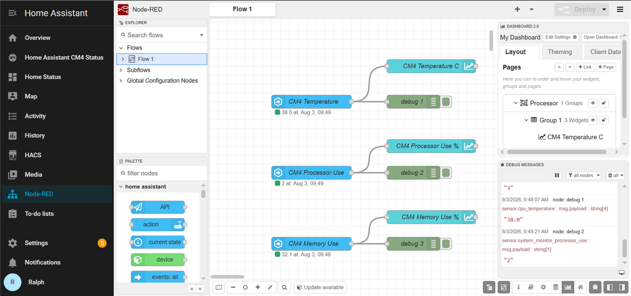

Node-Red flow to mimic CM4 status on external dashboard
The Deployed Dashboard at URL: http://homeassistant:1880/endpoint/dashboard/page1
Status of Sensors and Lights
Project Summary
Home Assistant is running with the required apps installed.  I've just tried Node-Red, so there's more testing required to verify the other apps.  The processor temperature is staying below 45 C with a 25 C ambient, so I'm confident that I don't need active cooling.  I really like the small footprint.  I think that I might add an audible alarm.
