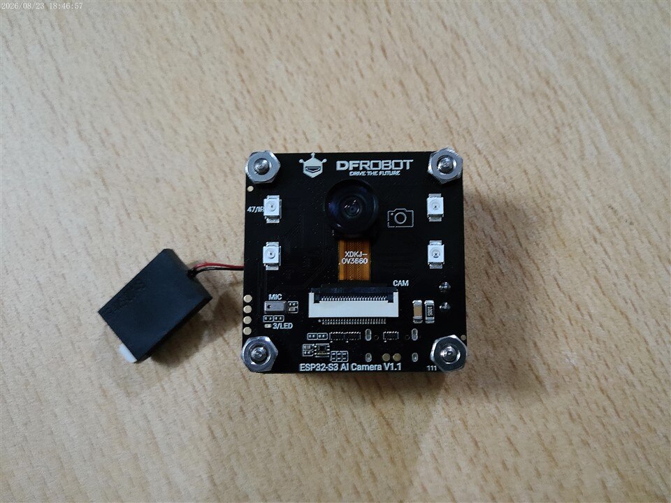

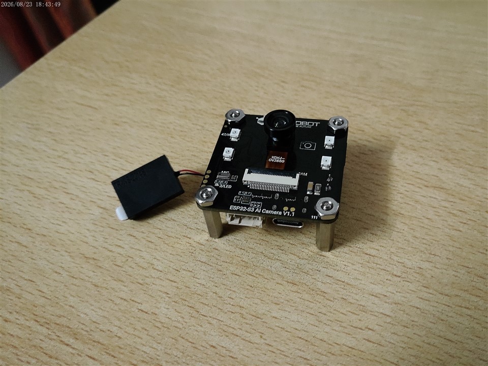

Just a few weeks ago, I got a development board from DFRobot. The board is based on ESP32-S3 SoC and it has camera and other interfaces. I was thinking about making some camera-based device that can be useful gadget for people who like technology. So, then it came to create a peephole camera for homes. Peephole cameras can be fixed on home door and anyone who come to home when owner is not there can keep a message for the owner. The message can then be used to get the information.
DFRobot ESP32s3 AI camera
Some days ago, I got a nice camera board form DFRobot. This is a device with many interesting features. This development board has 3 MP OV3660 camera. It has various other interesting interfaces to make this kind of project a reality.
  • 3 MP OV3660 camera with IR LEDs for night vision
  • ESP32-S3 SoC with WiFi and Bluetooth interface
  • LTR-308 Light intensity sensor
  • I2S MEMS microphone
  • SD card slot to store image, audio recordings
  • Speaker with amplifier for playing the audio
  • upto 3.7-15V DC power supply option
The board has WiFi/BLE interface that can be used for transferring files between the user's PC/Laptop or cell phone. The camera can be used to save images and the microphone to save audio recordings. The speaker can be used to play some example audio as well.
