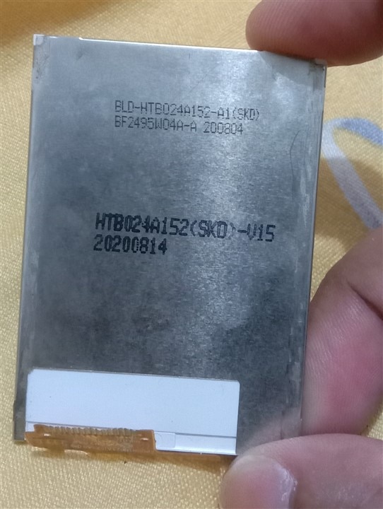

We all have old feature phones lying around in a drawer, destined for e-waste. But recently, I learned about these old devices: many of their LCDs actually use the exact same standard SPI protocols and driver ICs as the hobbyist TFT modules we buy online.
For my latest project, I wanted to put this theory to the test. My goal was to extract an undocumented LCD from a salvaged phone, reverse-engineer its pinout, and make it fully usable with standard microcontrollers (and eventually, my own custom-built MCU).
Here is how I cracked the pinout of a mystery screen using a custom PCB and a software brute-force hack.
The Salvage Operation and Live Probing
Before ripping the phone apart, I needed some baseline data. I opened the phone case, powered up the mainboard, and grabbed my multimeter. By probing the live board while the phone was running, I was able to identify the VCC and GND pins for the display.
Once I knew where power was coming from, I applied a generous amount of flux and used a desoldering wick to safely free the fragile 16-pin ribbon cable from the mainboard. I managed to manually trace out the backlight pins and confirm the ground pins.
Naturally, my next step was to do what any engineer would do: I checked the part number printed on the back of the LCD and searched for it online. Unfortunately, I hit a complete dead end. There were no datasheets, no pinouts, and no documentation available anywhere. I had a handful of unknown data pins (likely SCK, MOSI, CS, DC, and RST) and was completely on my own to figure out which was which.

With the hardware secure, I decided to automate the reverse-engineering process using an ESP8266. But to write a brute-force script, I first needed to know what initialization commands to send.
While I didn't have a datasheet, there is a reliable rule of thumb for salvaged phone screens: smaller displays (roughly 1.8 inches) typically use the ST7735 driver, while larger displays (around 2.4 inches with a 240x320 resolution) almost always use the ILI9341. Since my salvaged screen was a 2.4-inch panel, I confidently set up my script to use the standard ILI9341 initialization sequence.

I knew I was close. A few cycles later.... The screen transitioned from chaotic color noise into a crisp, solid color fill!
I immediately locked onto the Serial Monitor to capture the pin mapping that was running at that exact second.
The Final Result - Pushing Pixels
With the complete, verified pinout captured, I hardcoded the correct SPI pins into my sketch, and started pushing actual data to the screen using standard ILI9341 libraries.
Seeing full-color image patterns rendering flawlessly on a screen that was destined for the trash just days earlier was incredibly satisfying. Because the screen's pinout is now documented, it behaves just like any off-the-shelf SPI TFT module. I can now wire it up to any standard microcontroller.
