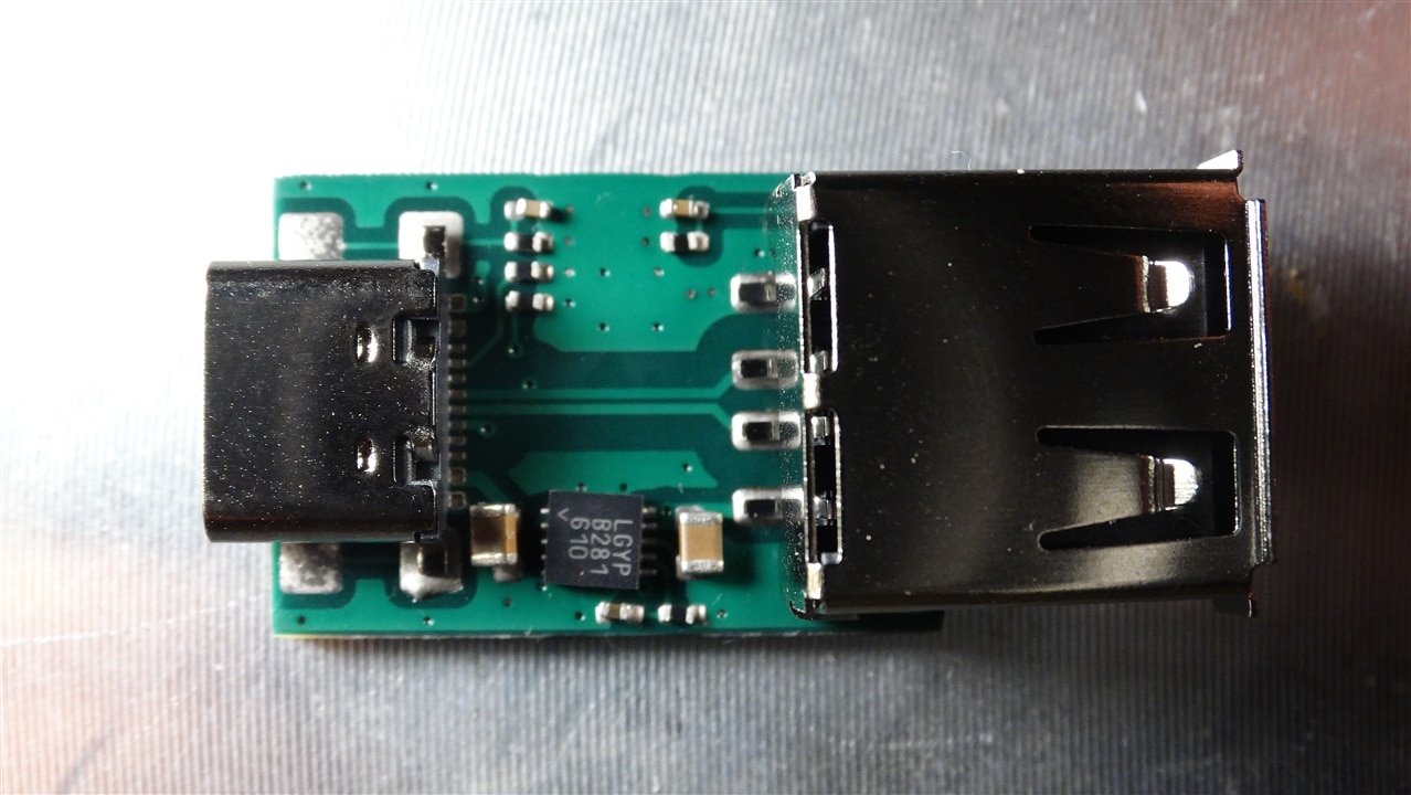

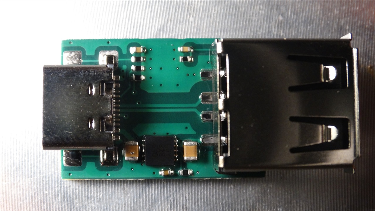

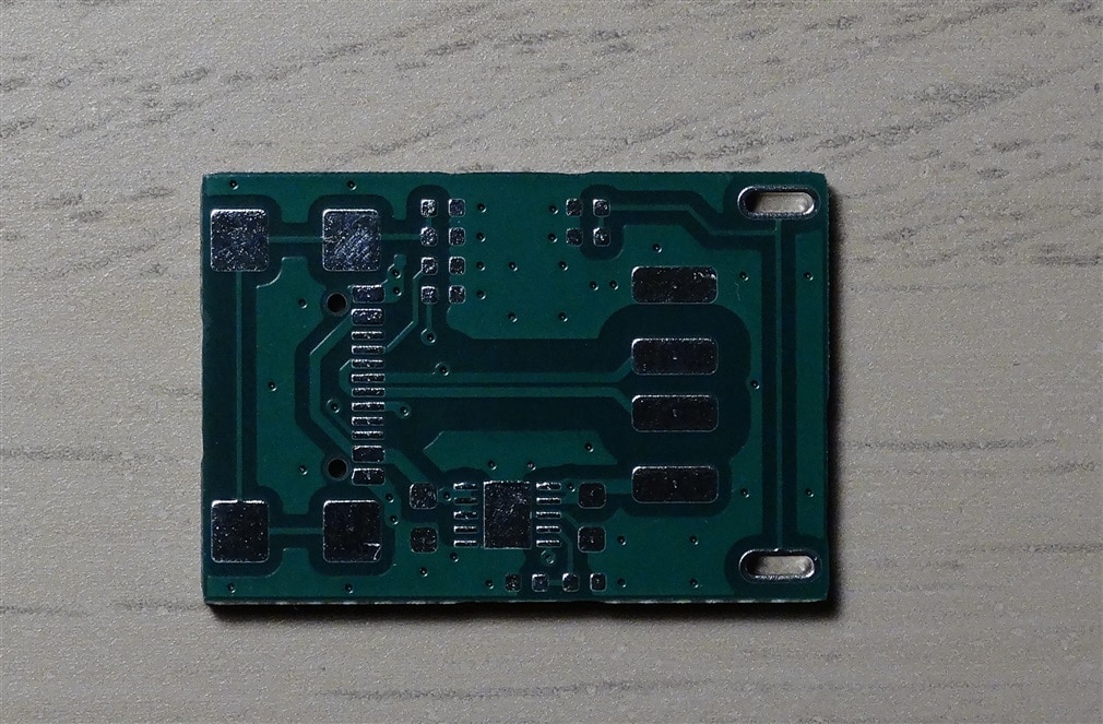

At this point, I designed a PCB in KiCad to host the LT3045. I wanted to enable USB passthrough from a host device, so that I could connect my SDR by USB to a computer (or an Arduino Uno Q as will be shown in my next blog), while having the supply get regulated by the LDO. The design is super simple, just the LDO, two, high quality 10μ X7R input and output capacitors (X7R dielectric is strongly recommended by the datasheet due to their nice properties, mainly their low ESR) and a few supporting components. The USB shields are not grounded, as this would cause horrific ground loop issues that would completely negate the use of such a nice regulator, instead they are tied to ground by a 1MΩ resistor, and a 100nF capacitor. This way they are not left floating, however if there is an ESD event (or similar transient to the USB shield) the capacitor can quickly discharge it to ground. The 5.1kΩ resistors are used to tell the USB-C host controller that this board wants 5V. The remaining resistor and capacitor are used to set the output voltage - unusually, this is done with a single resistor, not two as is more common. This is because the LT3045, as shown below, uses a current source (red) to set the voltage at the non-inverting input of the error amplifier, the user just provides the resistor (green) that this current flows in to. The voltage, then, at the non-inverting input is the output voltage (because the error amplifier is in a unity-gain configuration), and can be calculated easily from Ohm's law, for 5V we want a 50kΩ resistor. There are lots of interesting reasons that Analog Devices chose to implement the voltage reference in this way, they discuss them in the datasheet for this part (and in the application note) if you are interested.
LT3045 typical application schematic, ADI 2026
Before anyone mentions it, I did not include USB data line protection (like a TVS diode array) because I am lazy and am not planning to touch this thing once it is installed :) Below is the schematic and 3D view of the layout. The empty pads are for the USB-C and USB-A connectors (as will be shown). Most of the components are 0402's since I wanted the form factor to be as small as possible, ideally no wider than the width of the USB-A connector.
3D view of LDO board
PCB

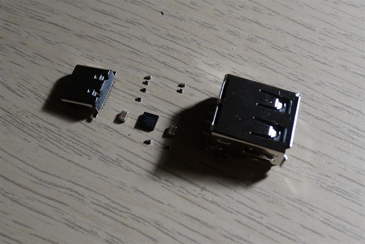

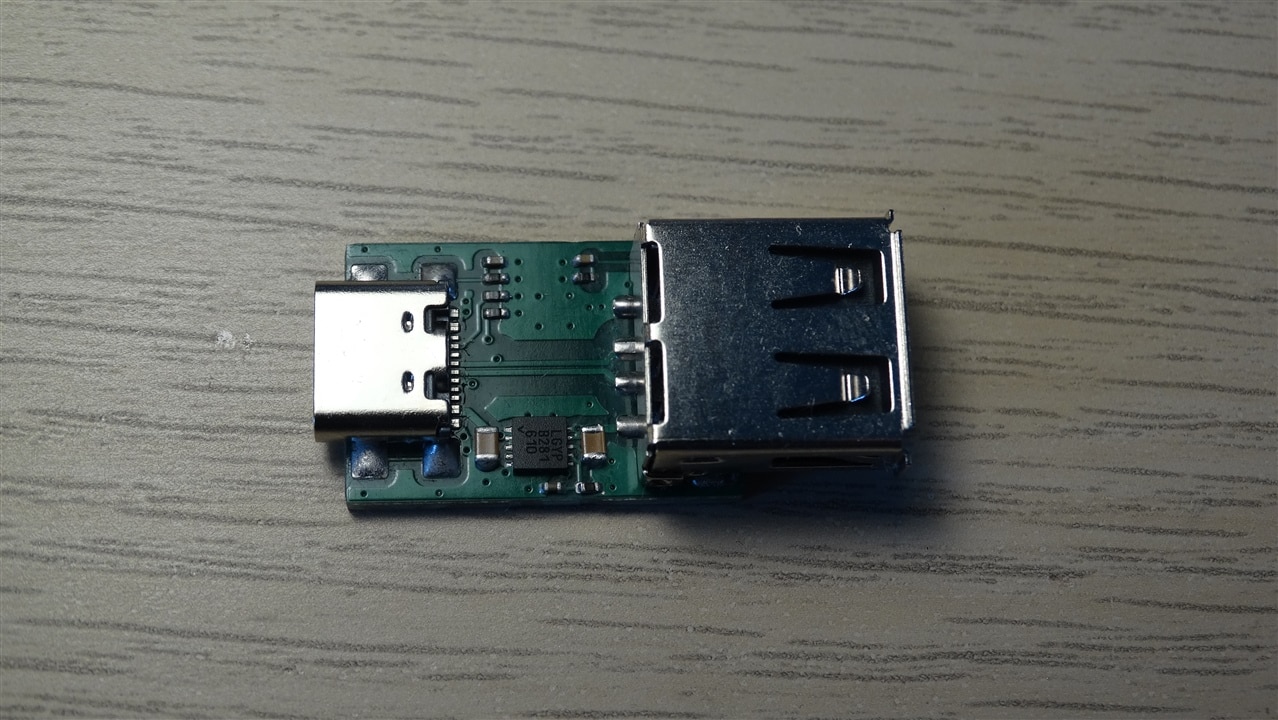

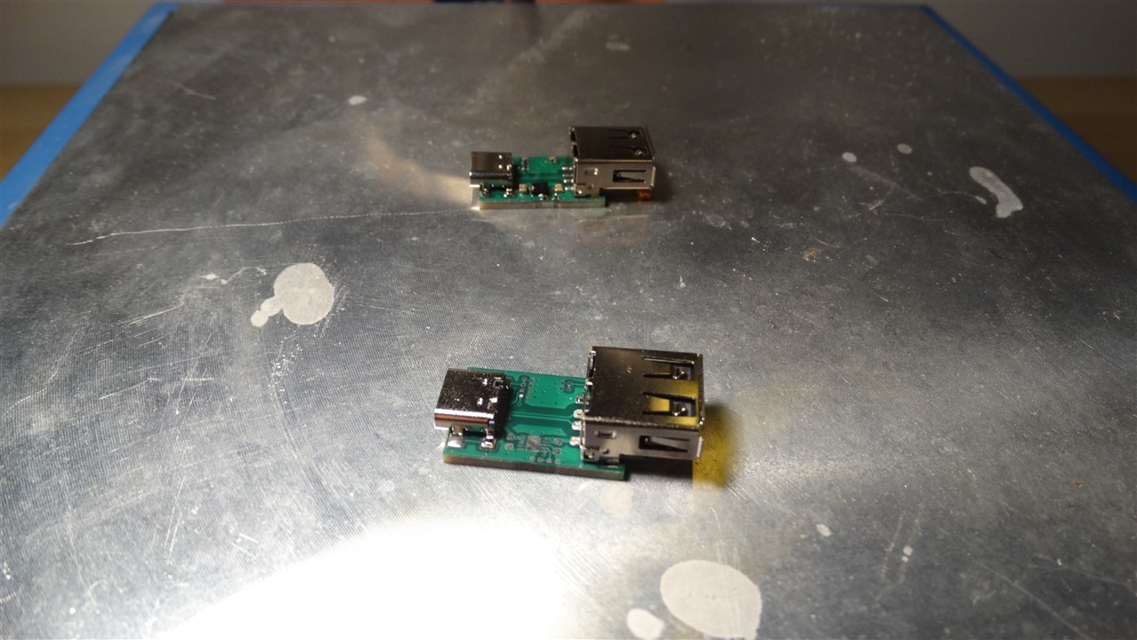

Once the PCBs and parts arrived, it was just a case of soldering everything on. I used my hotplate for most of it, however I did end up re-seating the LT3045 with hot air as it didn't solder down properly due to the big thermal ground pad it has on its bottom.
Assembly montage: Components, pre-placing components, hotplating, post-hotplate, cleaned up final board

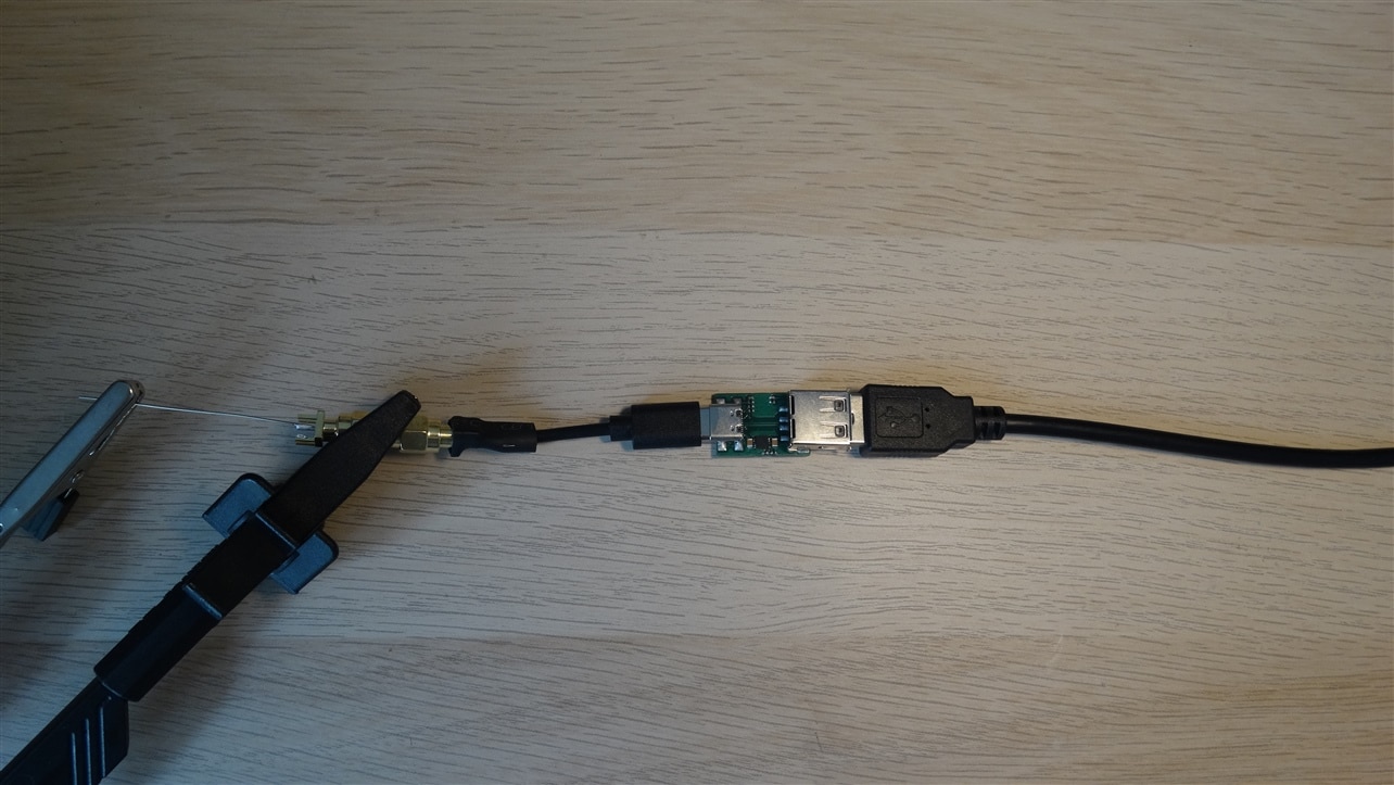

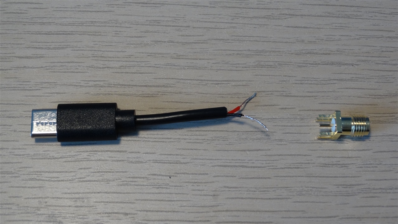

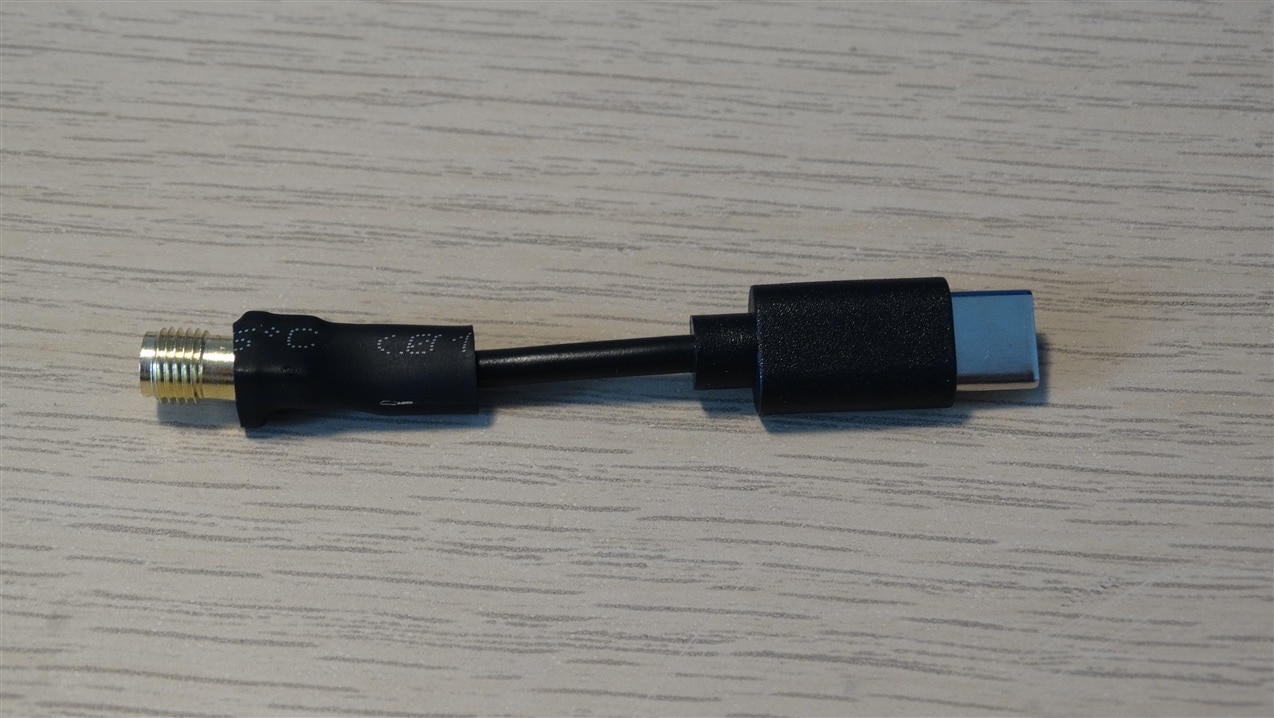

I also made a SMA to USB-C adapter to make testing easy. The USB data lines were severed, and the supply rails were connected the the centre (Vdd) and shield (Vss) of the SMA connector respectively. This way I could easily provide a voltage to the device without using any fly-wires. It's a bit cursed but will do the job nicely.
USB-C splice and SMA connector (unsoldered, soldered)
A simple DC test confirms that the output is being correctly regulated to 5V.
DC test setup. 6V is applied to the input through the SMA adapter (centre 6V, the shield is ground), and the output at the USB A port is measured. The exact output value is approximately 5.06V. The inaccuracy is due to me not using a precision resistor to set the output voltage

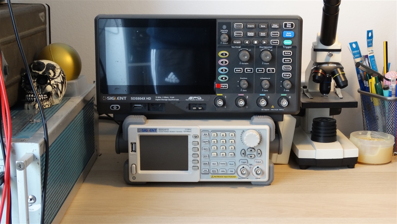

Scope and function generator, DC supplies can be seen on the left
Further to this, I wanted to obtain AC characteristics for my LDO board. My scope and function generator pair have the functionality required to measure transfer functions, in this way I could obtain the PSRR of my entire breakout board. There are many reasons that this may differ from the plot shown in the data sheet, however, any performance degradation would likely be down to bad layout. The application note for the LT3045 contains many suggested layout techniques, and I followed these to the best of my ability given the tight form factor.

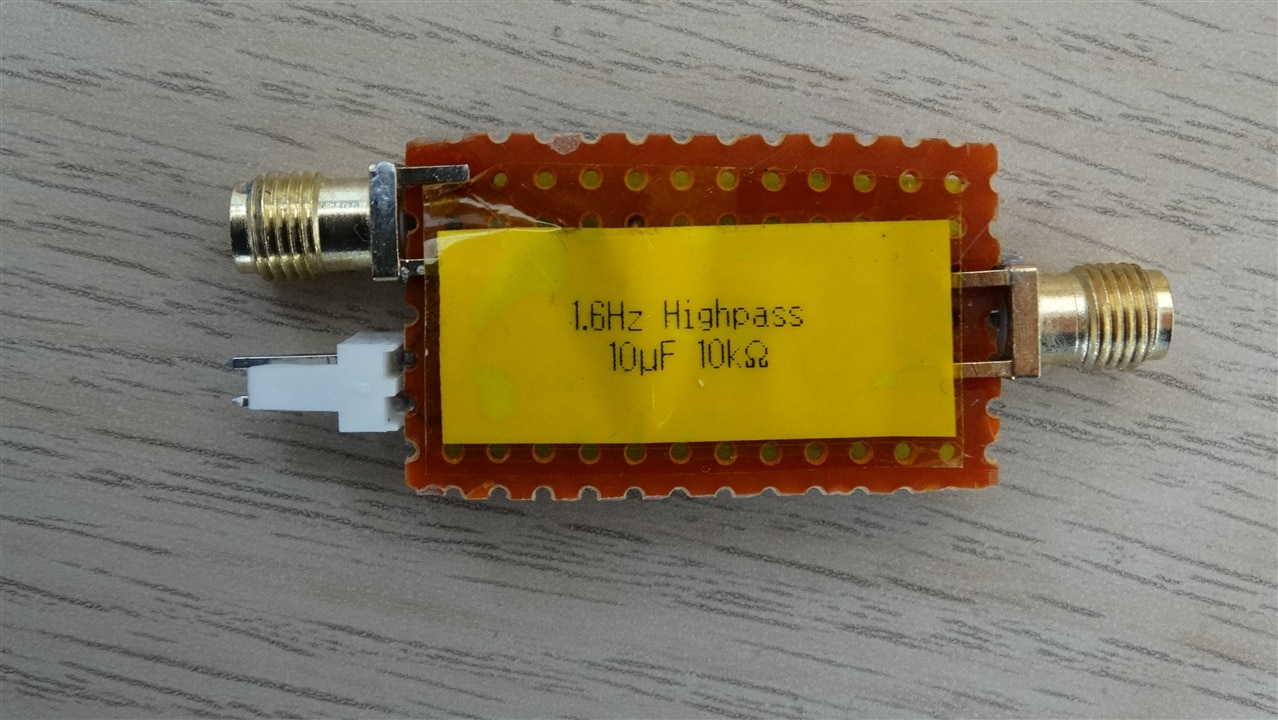

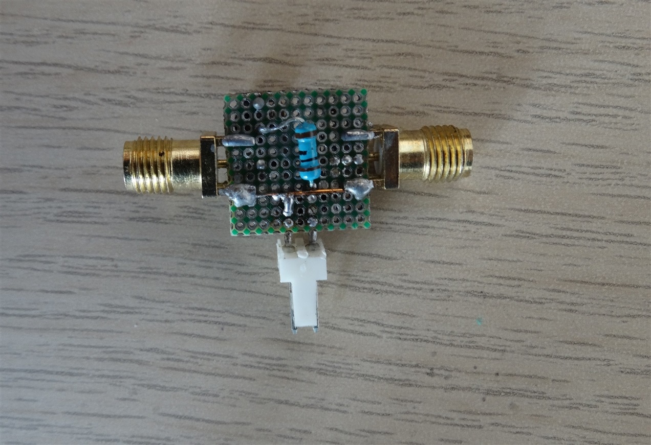

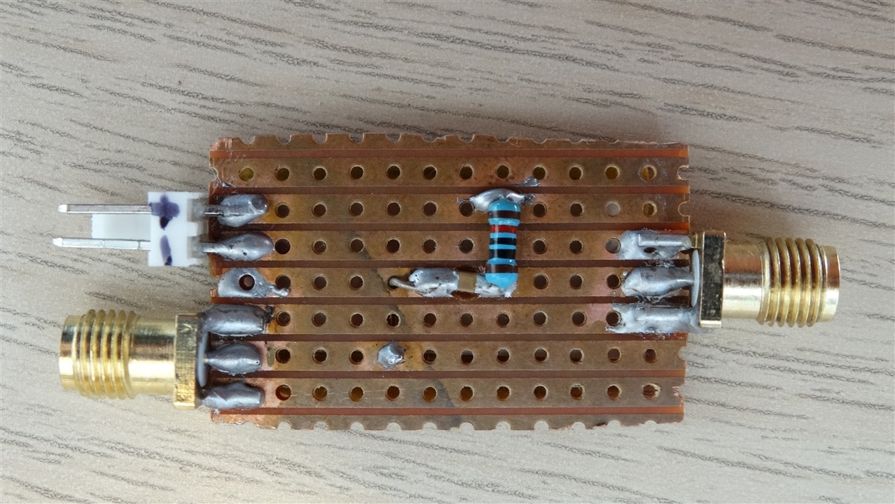

Usually, to perform PSRR measurements, an AC stimulus is applied to the supply rail, and the resulting AC at the output of the LDO is measured. From the formula for PSRR, we can now calculate, given these two measurements, the PSRR (at a given frequency). Typically, to obtain the plots shown earlier, the frequency is swept to accumulate results for PSRR over a given range of frequencies. In order to apply this AC stimulus to the supply rail, we can use a bench power supply to create a reference DC voltage (in our case, this is the supply voltage we want, i.e. 5.25VDC), and an AC voltage source (for example, a sinusoid of amplitude 100mVpp generated by a function generator) which we will add to the DC reference. The two signals will be added in a high pass filter with a low break frequency (in this case, 1.6Hz). This will then be buffered (to deliver the required current), fed into the LDO board, and the output AC is measured and plotted. Ideally, the voltage references should have low noise.

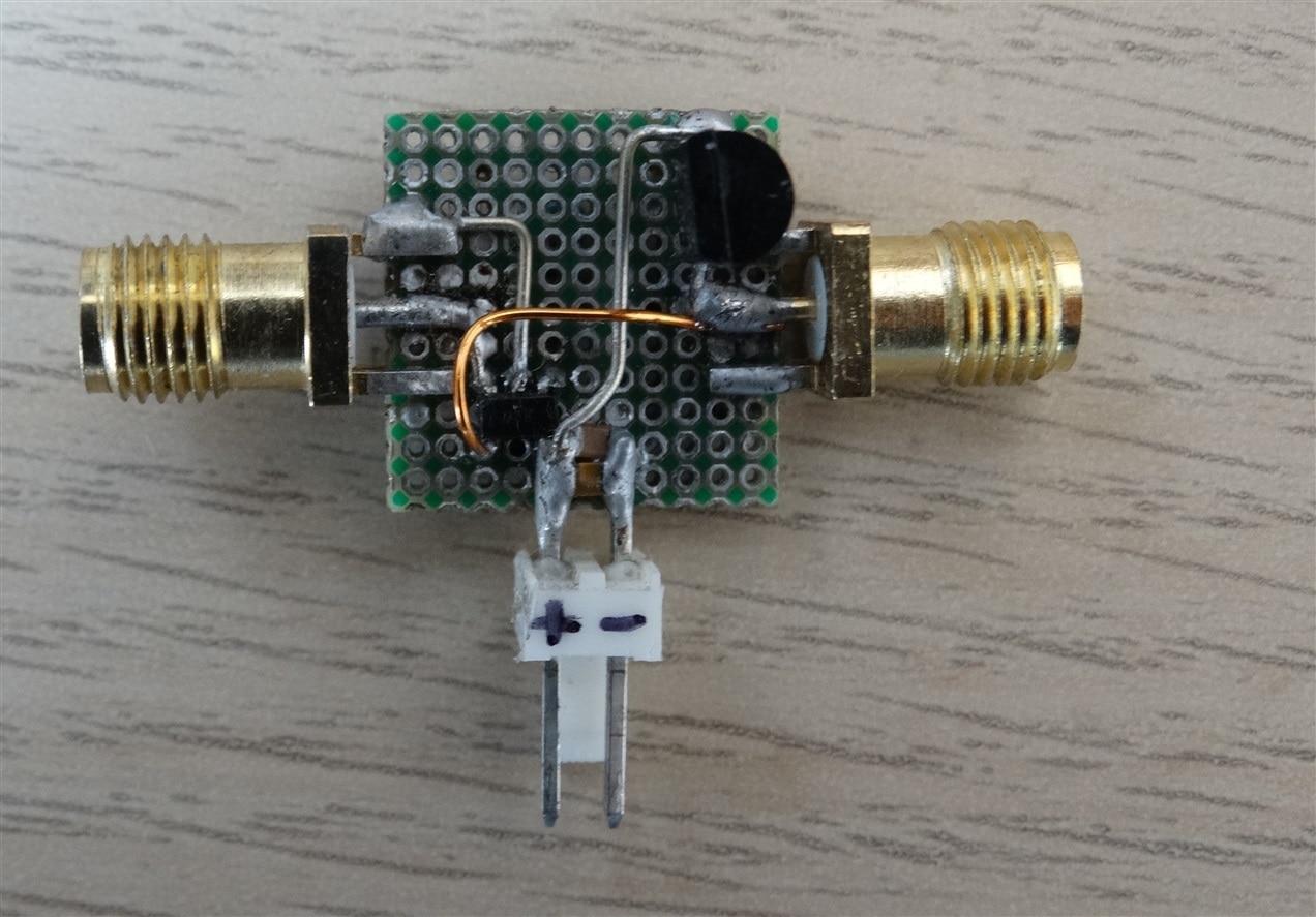

A simple buffer was created using an ADA4891 high speed opamp, and a generic BC337 npn transistor. The opamp was selected since it had a large bandwidth (220MHz) and a large open loop gain. The high bandwidth product is critical, as our sweep will be performed from 10Hz-10MHz, so we need the opamp to have a much larger bandwidth than the maximum frequency in the sweep. These were connected in a common-collector configuration, with a 10Ω base resistor connecting the opamp output and transistor base.
PSRR measurement buffer circuit schematic
PSRR measurement buffer circuit (top, bottom)
PSRR measurement high pass filter (top, bottom)
