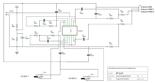

For this project we have chosen to use the integrated circuit TL084 which contains four operational amplifiers (op-amp). Two op-amps are used for each of the two Control Voltage channels. The four operational amplifiers are, therefore, used to make two fourth-order active filters specially designed to filter the PWM signal generated by Arduino. The image below shows the circuit diagram used for CVBoard.

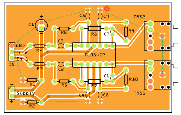

The four operational amplifiers provided by the TL084 allow to realize, for each channel, two second order filters placed in cascade. In this way it is possible to obtain, on each channel, a fourth order filter that provides a frequency response curve characterized by a slope of about 24dB per octave. The image below shows the design of the PCB board created for CVBoard.
The second order active filters are based on the use of the Sallen-Key configuration that uses the non-inverting terminal of the operational amplifier as input. The cutoff frequency of the filter has been set at about 160Hz. This frequency value has been chosen both considering the use of components with capacitance and resistance values easily available on the market and in consideration of the frequency used by Arduino to generate the PWM. In fact, this cutoff frequency value of the filter is about one third of the value of the carrier frequency (490 Hz) used to realize the PWM. This allows the filters to be able to sufficiently attenuate the amplitude of the noise introduced by the carrier frequency of the Pulse Width Modulation. To obtain a signal with an even smaller noise component it is possible to use some ports of the Arduino boards that realize the PWM with a double frequency (980Hz).
