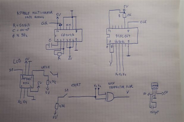

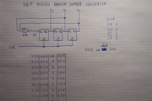

The basic idea was to create simple circuit with usage transistors, 4000 and 74HC series integrated circuits. I have created 3 bit random number generator with graphical presentation. Below there is logic circuit of this PRNG:
We have here 3 bit shift register which input is feed from XOR gate which is connected to two outputs from this register. It allows to generate number from range 1-7 in according to clock signal. To get here better random sequence you could use generator based on avalanche noise. Here is example circuit: Random Sequence Generator based on Avalanche Noise .

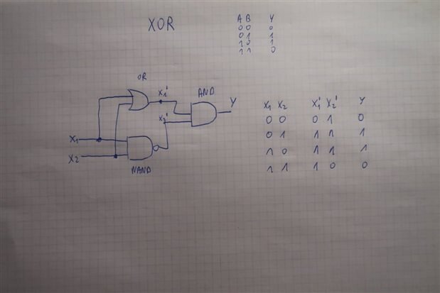

The XOR gate was created with usage of three gates OR, NAND and AND. Here is logic circuit for this XOR gate:

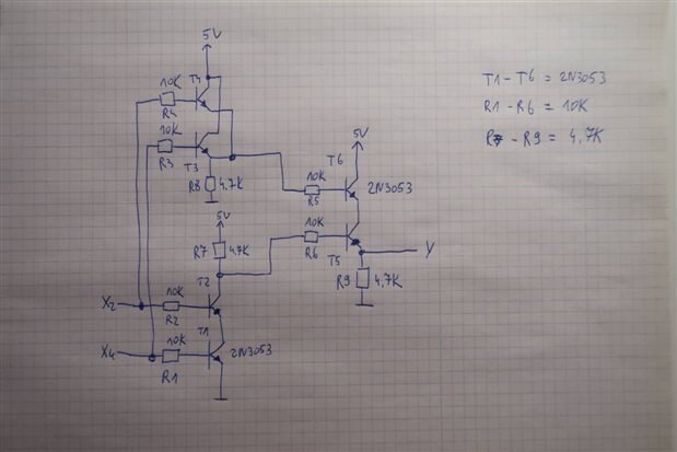

This XOR gate was implemented with usage of NPN transistors. We need six NPN transistors and nine resistors for create this gate. Below there is schematic of this gate:
Below there is schematic of whole circuit:

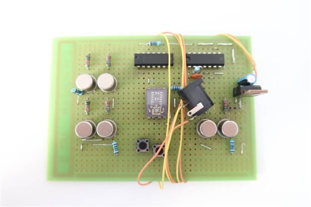

We have here CD4047 IC used to generate clock. It is configured to work as astable multivibrator with free running. I have chosen resistor R and capacitor C to get 9 Hz frequency. This clock drives 74HC164 shift register which is used to generate pseudo random number. Inputs of shift register are connected to ouput from XOR gate. XOR gate is connected to switch to initiate a number generation because by default all outputs of shift register have LOW value at inital state. I have used a HP 5082-7356 display which have BCD input and allows to latch input value. Because we have 3 bit output from shift register the MSB of BCD input is connected to GND. It allows to display number from range 0 - 7. The button connected to pin number 5 of this display is used to latch a number generated by pseudo random generator. All circuit is powered by 5 voltage generated by LM7805 linear voltage regulator.
Here is short video presentation of this circuit:
    jw0752 over 7 years ago +5
    Hi kk99, This is a very interesting build. Thank you for sharing your build and thought process. Can you explain the purpose of the two buttons which I see are labeled start and latch in your schematics…
  • kk99
    kk99 over 7 years ago in reply to jw0752 +5
    Thank you John. HP display have latch memory. When you set low voltage on pin number 5, it loads a current value from input to memory and displays it. So, I use it to display number from pseudo generator…
  • afmishaq
    afmishaq over 7 years ago +5
    Simple but instructive project! The idea of making an XOR with three gates is also interesting. I assume it will continue to repeat the same sequence over and over.
  • afmishaq
    afmishaq over 7 years ago in reply to kk99
    Sure, I understand.
  • kk99
    kk99 over 7 years ago in reply to afmishaq
    Thank you. I totally agree with you. I treat this simple design as example for learning purposes. Of course we could make a improvement it e.g. by using three different clocks for each bit with switching between these clocks based on another clock.
  • afmishaq
    You are right. But I was thinking more in terms of pseudo random number generation. The simple difference between the two is being deterministic or not. True random number generation is non-deterministic. Pseudo random numbers, on the other hand follow a deterministic sequence, as you have shown in your post. If the sequence is easily predictable, then it is not sufficiently random. The strength of a pseudo random number generator lies in the length of the (repeating) sequence and the complexity of its prediction. My suggestion was to provide a simple way to improve both. As long as the sampling frequency does not have a harmonic relationship with the multivibrator frequency, it should meet both requirements.
  • kk99
    I think that to get true random generated number the best option is to create a avalanche noise generator and connect it to input of shift register.
  • afmishaq
    A simple way to prevent the repeating of the same sequence could be to use another free running multivibrator with a different frequency and XOR it with one of the outputs to form the new input.
