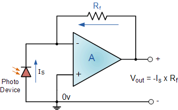

The basic goal of this project is to explore the design considerations of working with transimpedance amplifier which amplifies input current into voltage. Photo plethysmography is a real life practical application of transimpedance amplifier to amplify photodiode signal.

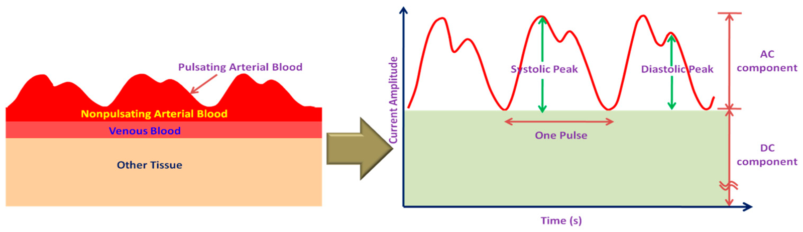

"Photoplethysmography (PPG) is a simple and low-cost optical technique that can be used to detect blood volume changes in the microvascular bed of tissue. It is often used non-invasively to make measurements at the skin surface. The PPG waveform comprises a pulsatile ('AC') physiological waveform attributed to cardiac synchronous changes in the blood volume with each heart beat, and is superimposed on a slowly varying ('DC') baseline with various lower frequency components attributed to respiration, sympathetic nervous system activity and thermoregulation. Although the origins of the components of the PPG signal are not fully understood, it is generally accepted that they can provide valuable information about the cardiovascular system."
-source: https://www.ncbi.nlm.nih.gov/pubmed/17322588

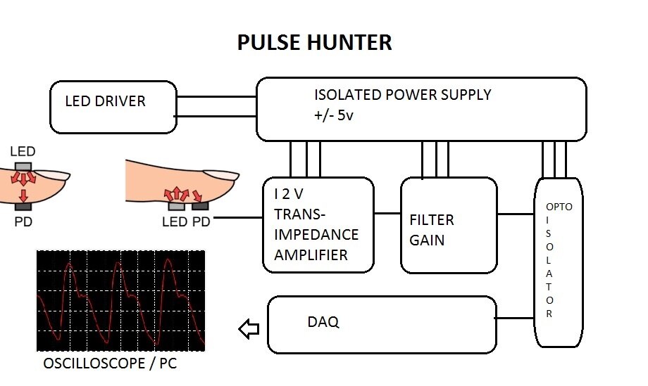

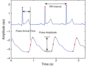

The working principle is pretty simple. A red LED is used to pass light through finger tip and a photodiode is used to receive the reflected light. This contains both the DC and pulse AC components in terms of photo-current. A transimpedance amplifier converts the signal into voltage and amplifies it. Filters are used to get rid of the DC component and the remaining AC component is further amplified to observe using oscilloscope or send to PC using a DAQ system. The PPG signal represents the heart beat, which can be captured at finger tip and takes a small time gap. A simultaneous comparison of ECG and PPG explains the relation and time gap between arrival.
**images are collected from internet [https://www.comm.utoronto.ca/~biometrics/PPG_Dataset/ ]
Project Description:
Block Diagram -
Key Analog Modules -
  • Transimpedance amplifier
  • Basic High and Low Pass filters
  • Optical Isolation

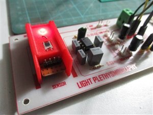

Sensor-
The sensor module consists of a RED LED and photodiode. To drive the LED at constant ~22mA, a LM317 based simple driver ckt is used.
However, the intensity can be varied using an onboard potentiometer.

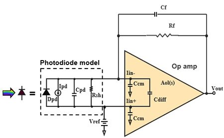

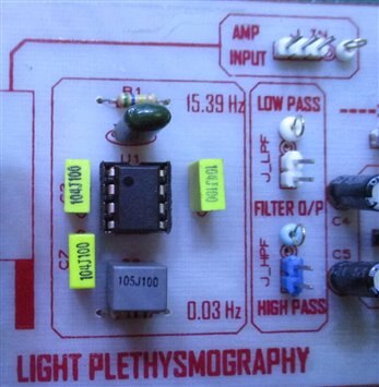

Transimpedance Amplifier and signal conditioning-
The TIA converts the photodiode’s current output signal to a usable voltage level. The implementation of this current-to-voltage conversion consists of a photodiode, an amplifier and a resistor/capacitor feedback pair.

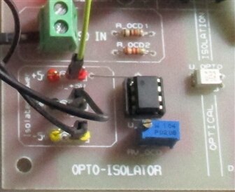

Optoisolator -

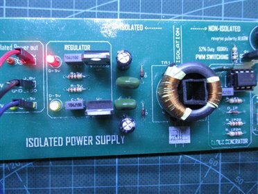

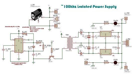

An isolation power supply is used to reduce the mains 50Hz noise. It also converts the single 5v supply into dual +/-5v which is used to the operate the amplifiers in dual supply mode.
however, isolation circuitry is not necessary in this case, if battery power is used.

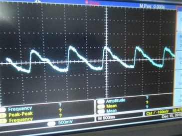

Output-

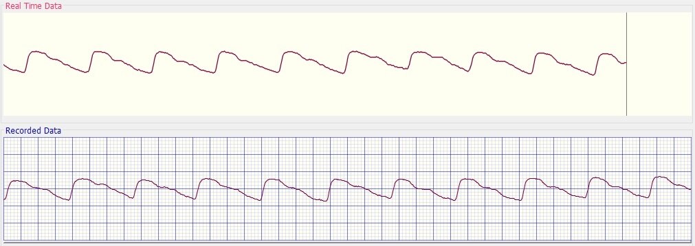

using oscilloscope
using a DAQ system and software developed by Department of Biomedical Physics and Technology, University of dhaka

    genebren over 7 years ago +4
    Very nice blog! Just a couple of things that I noticed that I was not too sure about. 1) There is a buzzer that is connected direct to the 5V supply input. Is the buzzer intended to alert whenever the…

    sunnyiut over 7 years ago in reply to genebren +3
    Hello Gene, Thank you for your comment. I really appreciate that. Yeap.. you are right about the freewheeling diode to suppress the back EMF voltage to save the switching circuitry. However, it's a very…
    Hello Gene,
    Yeap.. you are right about the freewheeling diode to suppress the back EMF voltage to save the switching circuitry. However, it's a very low power design and the collector-emitter sustaining voltage is quite high. So, in this case I overlooked it. But definitely I should have used it. Thank you for pointing it out.
    And about the 'Buzzer'!!! well it's connected in a reverse way. So, it's just an indication that the input supply voltage polarity is reversed.
    There are header rails along with the Dc power socket to provide the input supply externally, so chances are there to connect it in reverse accidentally. image
    - Kamrul
    1) There is a buzzer that is connected direct to the 5V supply input.  Is the buzzer intended to alert whenever the unit is on?  Not sure why you want to do that.
    2) In the isolated power supply, I noticed that there was no flyback diode to suppress the voltage that is generated when the primary of the transformer is shut off.  You might want to look into this to help prevent any damage to your switching circuit.
    Otherwise pretty cool.  I have worked with a few engineers that came out of groups developing commercial pulse oximetry instruments.  They were doing some pretty aggressive filtering of their signals (>10 tap filters) to clean up their signals.  The load of these filters on a microprocessor where pretty heavy, up to the point that there was little to no background time available (of course they were using 8051 derivative).
    Gene
