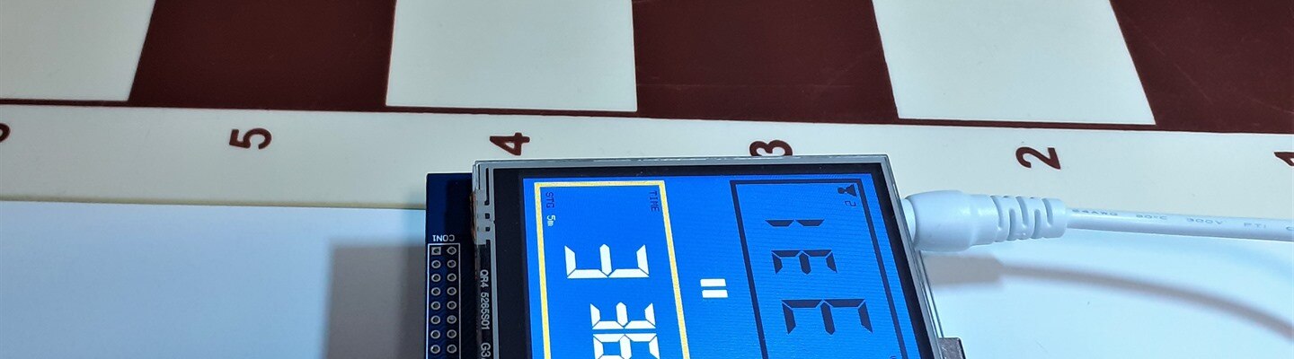

Arduino UNO TFT LCD Touch Digital Chess Clock
a Christmas present to play face to face with your loved ones.
In this project we have developed a digital chess clock based on the Arduino UNO and an LCD screen to give to my young son. He has also collaborated in all the development and testing and now he thinks that C programming is easier than programming with Scratch.
This chess clock allows you to program all the most popular time control modes for the game of chess. From the simple time control, to the post-increments and pre-increments of time, as well as the bonuses for moves made in different stages of the game.

Overview of our implementation
Time control reached
Hardware used
This program is compatible with all TFT LCD screens an Arduino models that the Adafruit TFTLCD Library supports.
For the examples shown, I am using:
  • Arduino UNO
  • ELEGOO UNO R3 2.8 Inches TFT
You can also choose this one from Adafruit:
  • adafruit TFT Touch Shield, 2.8", Arduino, Resistive Touch Screen
Software
You can download the complete Arduino Sketch form the github repository:
  • Arduino UNO Chess Clock https://github.com/javagoza/ArduinoTFTChessClock
The sketch uses a library that we have also developed to display virtual seven-segment displays on a TFT screen. This library allows displaying various configurable displays without flickering on an Arduino UNO with a TFT LCD screen that generally has serious problems refreshing the data on the screen. /challenges-projects/project14/buildapresent/b/blog/posts/arduino-uno-chess-clock-_2d00_-tft-lcd-virtual-clock-display-library
  • TFT LCD Virtual Segment Display for Arduino https://github.com/javagoza/TFTVirtualSegmentDisplay

Touchscreen selection of preset modes
Sample of the two clocks facing each other in the idle state to start the game. It has not yet been decided which clock will control White's time and which will control Black's.
The screen shows the chosen control mode (TIME, FISCHER, BRNSTEIN, US DELAY), the increment time to apply if it exists.
The different defined stages, the number of movements to complete in time and the time bonuses in the following stages.
Moves counter and color (White, Black) indicator
Pause/Resume
Reset game, new game, back to idle.
