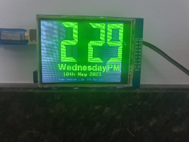

  • AndyL1952
    AndyL1952 over 3 years ago in reply to javagoza
    Thank you for a prompt reply....
    I reached out to Elegoo Technical Support  - and they came back almost immediately.
    I was very impressed.
    They sent me a different pin_magic.h file to overwrite the pin_magic.h file in the adafruit TFTLCD-Library-master file.
    That means that the Adafruit example files now run on the Mega as they did on the UNO.
    So .. so should your lib - but I havnt got that far yet.
    Here's a photo of my 'latest' clock.
    Seems to be an obsession! image
    I tried to attach the pin_magic.h file - but couldnt.
    Keep up the good work! This is such a useful display.
    Andrew.

  • AndyL1952
    Hi Enrique
    What a suberb library! Just love it. Thanks for sharing it.
    I want to use this to update my clock that curerntly uses 8*8 led displays but I have a problem.....
    I am using an Elegoo 2.8TFT screen, and although I get get it to work perfectly with the Uno and Adafruit Lib, when I try to use a Mega - nothing!
    The Elegoo Lib examples work fine with the Mega - but no the Adafruit examples.
    Anyone shed any light on the reasons why?
    Thank you!
    Andrew.
