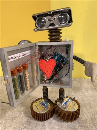

The concept of course revolves around a beautiful piece of robot art my wife created. And I turned it into something... else.
Honestly though, she may look innocent but she's just as much to blame for all this image

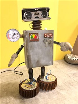

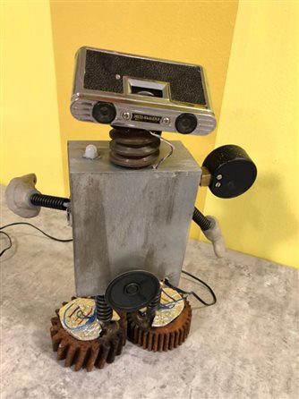

SuperArtGirl took a little wooden dollar store trinket box and made this beautiful and innocent looking robot, using random parts and her excellent artistic skills.
Isn't he cute? And so innocent looking?

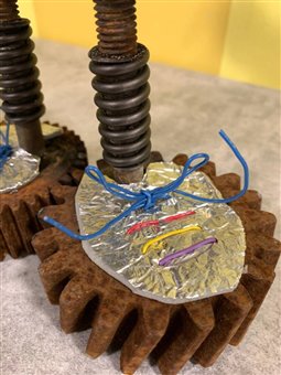

His head is made up of an old pocket binoculars, the feet are gears adorned with some aluminum foil and wire to make shoelaces.

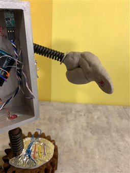

She made custom hands with sculpting clay, which allowed her to embed a little pushbutton switch into the finger. Told you she wasn't completely without guilt in all this image

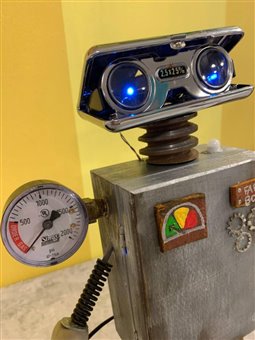

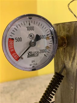

Did you notice the wording on that gauge? image

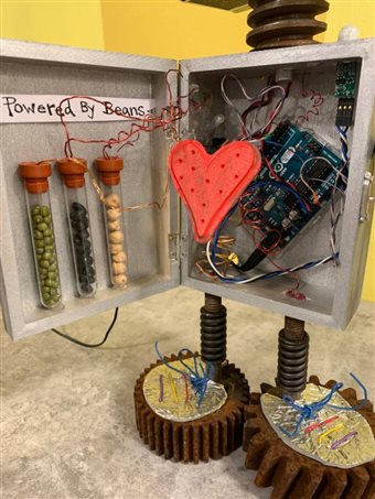

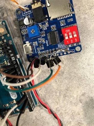

At the heart of the robot we have a standard Arduino Uno. It controls a little soundboard (DY-SV5W) that plays sounds from an SD card.
I attached an old speaker to the robot's... ahem... back side.
At startup this little robot introduces himself.

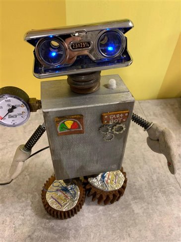

The eyes are little LEDs that I soldered up to some stiff wire and tucked inside of the binoculars. They light up whenever Fartybot speaks.
On his left shoulder we put an SR505 PIR sensor, which triggers a random "pull my finger" sound clip.
I haven't found these PIR sensors to be super reliable, but maybe I just got a bad set or maybe I am missing something in the way I hooked it up. For this project it works well enough, as it does seem to detect motion often enough, and once in a while it just randomly blurts things out.
And, of course, there is a switch in the finger which plays a random fart sound clip.
The heart is spring loaded. His intentions are good.

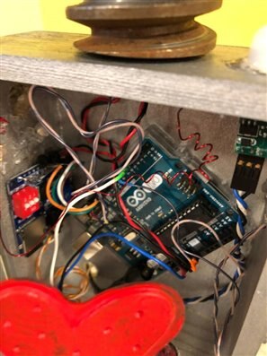

Getting ready to assemble all the techy pieces into the robot's chest:
Here's a closeup of how the parts were placed into the robot's chest:

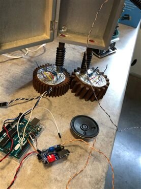

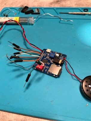

The soundboard is quite interesting in how it works. You simply have to provide 5v power, and then touch the contacts to make it play a sound file from the SD card.
The sounds on the SD card are numbered 00001.mp3 and counting up to, in my case, 00009.mp3. By connecting a pin to ground, it will play the associated sound from the file. This little board also directly powers the speaker with no extra hardware required!
This is a picture of some early sound testing:
I ran into problems when I tried to have the Arduino control the sound board though - it seems to need more than just the draw an Arduino pin can handle in order to produce a nice sound. Directly connecting an Arduino pin to the soundboard pin made for very scratchy terrible sounds. I solved this issue by using some transistors in between - I soldered those directly onto the little soundboard to keep things compact.
The red block with white microswitches is to set the soundboard mode. I set it to the mode that allows me to provide a binary number type of input to the board, so I could get away with just 4 transistors instead of needing 8 - one for each pin.
Using the 4 transistor controlled connections allows for 16 sounds - more than enough for this project.
