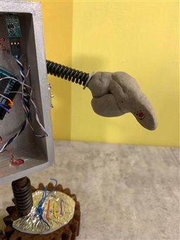

SuperArtGirl took a little wooden dollar store trinket box and made this beautiful and innocent looking robot, using random parts and her excellent artistic skills.
Isn't he cute? And so innocent looking?
His head is made up of an old pocket binoculars, the feet are gears adorned with some aluminum foil and wire to make shoelaces.
She made custom hands with sculpting clay, which allowed her to embed a little pushbutton switch into the finger. Told you she wasn't completely without guilt in all this image

At the heart of the robot we have a standard Arduino Uno. It controls a little soundboard (DY-SV5W) that plays sounds from an SD card.
I attached an old speaker to the robot's... ahem... back side.
At startup this little robot introduces himself.
The eyes are little LEDs that I soldered up to some stiff wire and tucked inside of the binoculars. They light up whenever Fartybot speaks.
On his left shoulder we put an SR505 PIR sensor, which triggers a random "pull my finger" sound clip.
I haven't found these PIR sensors to be super reliable, but maybe I just got a bad set or maybe I am missing something in the way I hooked it up. For this project it works well enough, as it does seem to detect motion often enough, and once in a while it just randomly blurts things out.
And, of course, there is a switch in the finger which plays a random fart sound clip.
