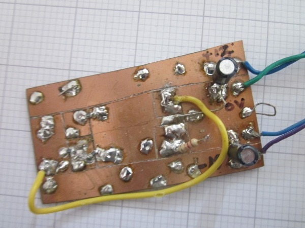

Here's the board I'm going to build on.
As you can see it's recycled from some other experiment. The cutting between the pads was done with a
craft knife.
Here's an upside-down turned-pin IC socket showing how I place the decoupling capacitors underneath
between the supply pins with the excess lead then being the supply connection down to the pcb.
I won't go through the build step-by-step, but here are some pictures of the end result
A few tips from my experience so far of building boards like this:
1/ It's worth using a continuity setting on a multimeter to check that all the separate pads really are
separate. It's very easy to end up with a sliver of copper joining areas that shouldn't be joined.
2/ I use a magic marker pen to write on boards. Particularly things like supply voltages which would do
the most damage if subsequently connected wrongly.
3/ Large areas of copper will obviously need a soldering iron with a reasonable heat capacity if you're
going to solder to them. I generally manage ok with a 60W Weller iron and a fairly large 3.2mm chiesel
bit.
4/ For test points for probes, rather than a single wire sticking up I prefer to form a wire into a
triangle or square shape. It's more stable and you're less likely to have an accident with a probe tip or
ground clip shorting something else.
5/ Parts don't have to sit the conventional way up. When wiring directly to the pins of DIL ICs, it often
works better having the part inverted. In this case I can't do that because I wanted to be able to swap
both devices and had to use sockets.
6/ I tend to mix conventional and smd parts for the passives. Sometimes it's convenient to use
(reasonably large) smd parts between pads, sometimes it makes more sense to use conventional parts as
'bridges'.
7/ I've noticed that bright orange capacitors look really cool in photographs.

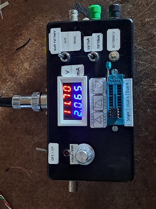

    • imageHi
    I have done an OpAmp tester base on this méthod of measurement.
    • Jean-Louis
