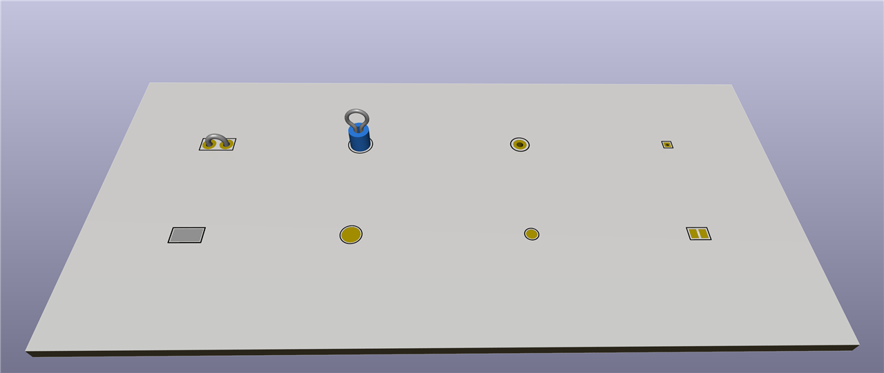

Test Points:  Test points are invaluable for probing power, key analog signals, and buses such as SPI and I2C.  Some common ways of probing single points are shown below.
Test Points
The two loop style components shown in the upper left are convenient for hands-free connection of oscilloscope probes or use with mini-grabbers.  Simple through-hole pads to the right can be probed directly with a pointed probe or a pin/section of wire can be soldered in for use with grabbers.  The surface mount pads lower left can be probed with a sharp probe or a bit of wire soldered on and grabbed.  The last pad is a special type that can be used as an open jumper, or a solder blob can be used to short across it. There are also test points for use with an oscilloscope probe tip with spring ground tips.
