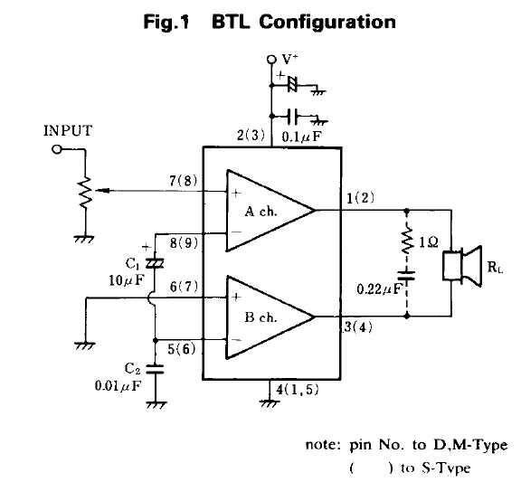

For the amplifier, I'm using an NJM2073 (New Japan Radio Co. Ltd.). This is a small, dual amplifier that can be used either for
stereo or in a bridge configuration. I'm using it mono in a bridge because of the low supply voltage. The datasheet says it will
work down to 1.8V, so it will do fine on the 3V battery pack. The datasheet gives this recommended circuit for the bridge
arrangement but I'm a little unclear as to what I feed to it so I'm going to prototype it on a breadboard first so that I can
experiment with it and make sure it works how I think it does.

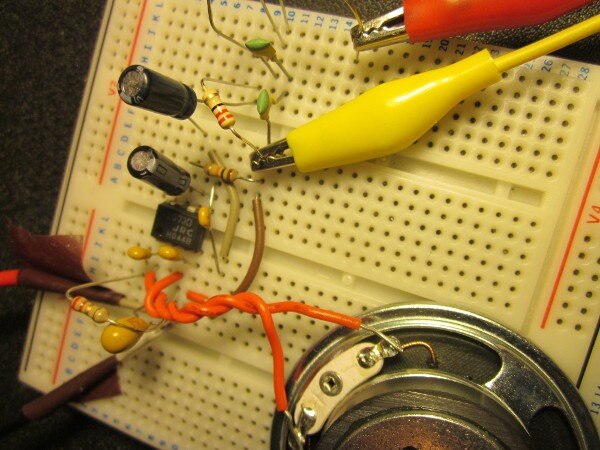

Here it is on a breadboard. I've included the Zobel network that they recommend (the resistor and capacitor across the speaker),
but I've increased the resistor value from 1R to 5.6R, in line with their suggestion to make it closer to the real resistance of
the speaker at low supply voltages.

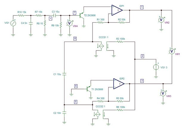

Here's the circuit I've ended up with but without the speaker and Zobel network which you can get from the circuit above. This will
look a little odd - I wanted to try it in the simulator but didn't have a model so I created the innards from two 'ideal' op amps
and two current-controlled current sources to replace the transistor mirrors. It won't be a particularly good model overall but it
does model the internal biasing arrangement shown in the datasheet which I was curious about. Anyhow, ignore all that - what's
important is the external circuitry [I've labelled the pins for my virtual amplifier component so you can see what's internal and
what's external]. Sorry if this is a bit confusing, say in the comments if you want a more straightforward version.
The logic signal at the input is attenuated with the potential divider and then ac coupled to the amplifier input with a capacitor.
I've lightly filtered the signal with the 5nF capacitor [odd value - really two 10nF in series] to round off the edges of the
digital waveform.

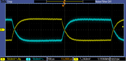

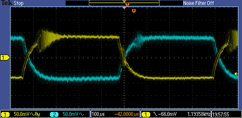

Here's how it behaves on the breadboard with a 1kHz 3V pk/pk squarewave at the input. Looks a bit noisy, but sounds ok. The bridge
is working nicely with each side roughly centred between the supply rails. [The scope traces show each side of the speaker relative
to GND and are ac coupled. The speaker sees the difference between the two.]
Here's what it looks like without the RC network on the output. I thought that I might get away without it but it is necessary to
stop it trying to oscillate.

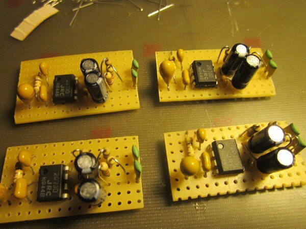

Building the Amplifiers

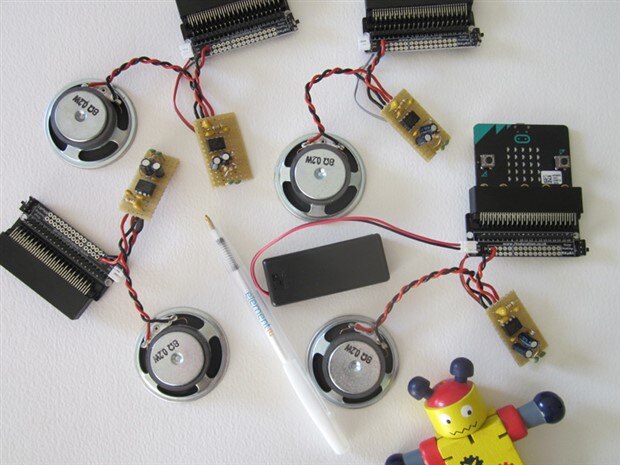

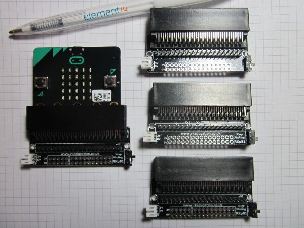

Here are the interface boards after I finished soldering them together (they come as a kit of parts). I'm using these
because three of the Micro:bits are on loan from my local library so I need to be careful with them - everything will get
tested with my own Micro:bit (the one in the picture) and the loan ones only plugged in once I'm sure of the circuits and
power connections. Sorry about the picture - taken quickly under a desk lamp.
My aim at the moment is just to throw something together quickly for the video, so construction is on some tripad board.
Here they are as I built them but without the connecting wires (different desk lamp, just to confuse the camera). They're
meant to be identical yet all are subtly different (which pleases my natural sense of disorder and untidyness).

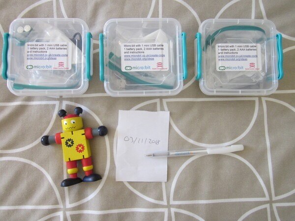

Here are the three performers that are appearing courtesy of Colchester Public Library. They each come in a neat little
plastic box holding the processor, the USB lead, and a pair of batteries with a battery box. I thought I'd have to mark my
own board but I've noticed that all the library ones are yellow so I'll immediately be able to tell my cyan one apart from
the rest. The piece of paper with a date on it is the return date. My little assistant looks nervous - I don't think he's
happy at the prospect of meeting all these super-clever thinking machines.
I've wired the amplifier boards to the interface boards [feels like a production line around here at the moment] and done
a quick test using my own micro:bit. They all play music.

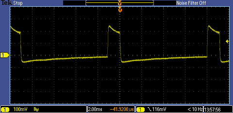

but, if it works with that, it'll work with anything I throw at it. One thing that I discovered is that the output from
the micro:bit (on P0) isn't a square wave. It looks like they're doing it with PWM (I'd guess with the hardware, given how
awful the software-emulated PWM that can go on any pin is) with a fairly large mark/space ratio. Here's what the 'scope sees measured
across the speaker:
It's good because it actually makes for a more interesting sound than the square waves I was using from the generator.

    I didn't explain very well in the blog. The 5nF with the 15k at the input is a simple low-pass filter. The cut-off is around 10kHz.

    The decoupling is a 47nF capacitor a few millimetres from the pins and a 47uF tant a bit further away. Too late to see what the effect of removing it would be, though, because I only had four amplifiers so they've all gone on the circuit boards.
    I'd like to examine in more detail what the Zobel network is doing and the way it modifies how the speaker inductance appears to the output but for the moment I need to get on with the Quartet (still too much to do). As you say, in practice it works (for this amplifier, in this circuit), so I'll just throw it in and forget it for now.
    Thanks for the comments.
    mcb1 over 7 years ago in reply to jc2048
    That may be layout - this is on a breadboard - or might just be natural variation.
    I guess you'll have to wait until it's on some form of pcb, veroboard or birds nest to see the real world result.
    I'm curious about your power supply decoupling and whether this has any affect.
    It is really obvious that the zobel network stops the oscillation, so they are effective.

    Answer is yes.
    This is with a sine wave from a generator going in and no RC network across the speaker:
    This is with 2.2R and 47n (just what came immediately to hand) across the speaker:
    Here it is with a square wave going in, the 5n input-side capacitor removed, and the same Zobel network as above. The square wave edges lead to overshoot but it settles ok (at least on the generator - the microbit edges will be faster than the function generator).
    Finally square wave without either filter (where it seems to settle after the edge and then break into oscillation):
    In the last two shots I moved the traces apart simply so that the overshoot could be seen better.
    One amplifier seems more prone to oscillation than the other (this is a bridge, so we're looking at how two separate amplifiers behave). That may be layout - this is on a breadboard - or might just be natural variation.
