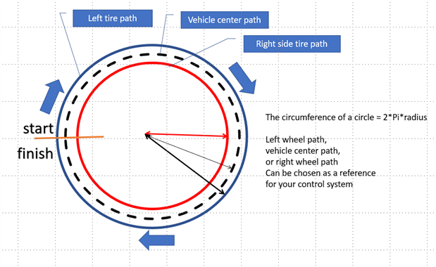

First, let's understand how the robot drives in a circle.
In this illustration , the left hand side wheel has to go faster and further than the right hand side wheel to get back to the starting line.
The ratio of left side speed to right side speed sets the circle diameter (turning radius).
Theoretically, tracing out a circle should be easy, its just a ratio of wheel position (and speeds)
The ratio is difficult to maintain precisely, and there are so many variables.....
BUT by using motor encoder to regulate motor speed or use the distance traveled of the to adjust the motor speed to keep that circle perfect.
My control solution is determining the traveled position of each wheel ( which also has to be be at the same ratio of inner circle to outer circle diameter).  if the traveled position of the right side wheel is not as calculated for a perfect circle to what the left wheel has traveled, it's speed reference can be sped up or slowed down, applying a correction to compensate for errors.
The Arduino program speeds up or slows down the right hand side wheel speed by 2% when the actual encoder counts are + or - 10 counts
off from calculated value.

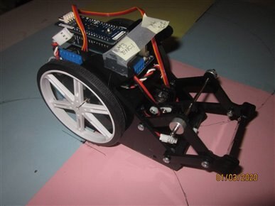

This robot has a MKR1000 for brains, a motor carrier shield for variable speed motor control, and
inputs for the motor encoders.

The Robot Wheel Diameter inches = 3.5625
The Robot Wheel circumference inches 11.19181
One turn of the wheel measured 1190 encoder counts (measured value as info on PPR, actual gear ratio or motor top speed is not available)
The robot width (to the centerline of each wheel ) is 3.25 inches.
For simple testing, a 12 inch circle diameter was chosen for the robot's path.
The left side wheel path diameter is 13.625 inches, the right side wheel path diameter is 10.375 inches.
The ratio of inner path to outer path is ~  .76146788990825688073394495412844
Running a baseline value of speed ratios with the hardware, and the calculated values didnt quite work as calculated.
The motors are so different at the slow speed points being operated at, and the small circle diameter the speed ratio had to be empirically set for .55 ( 11 / 20)
Using the MKRMotorCarrier Arduino library, the motor control is set as an integer PWM Duty Cycle,   -100 to 100.
1% is the best resolution speed reference that can be written for PWM.
