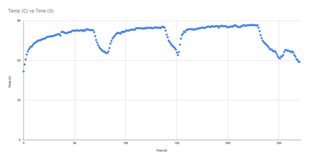

Slow cooker test results
For my first test, I used the high temperature setting on the slow cooker as this allowed the temperature of the bowl to reach over 150 ℃. The first test results were not that exciting. As shown on this chart, the heating profile achieved with the PCB inside the bowl was nice and linear but the rise in temperature was way too slow (0.04 degrees per second).
My first challenge was to determine how I could improve things just using the slow cooker. Then it dawned on me. Who needs the bowl anyway as the heating comes through the aluminium shell. So, I removed the ceramic bowl and I placed the PCB inside the shell with the lid balanced on top (not quite a snug fit).
This provided a much much better temperature gradient (0.16 degree per second) but it still took about 10 to 15 minutes to reach 150 degrees centigrade with the lid on.
It was time to reflect on the science behind this.

Well the test results were very disappointing. The temperature gradient was not great at all and pretty erratic. Clearly temperature control was kicking in. To solve my temperature fluctuation problem, I would have to remove the mechanical type thermostat control mechanism.

The results were really encouraging.
I am no PCB reflow expert so I am not sure what the implications are for the initial high temperature gradient (below 65 degree the temperature rise was about 5 degrees per second) but this eventually settled to a steady 1 degree per second rise all the way up to 150 degree, which is pretty darn good, in my opinion.
The problem now was that once I turned off the spotlight, the temperature plummeted as there was no means for heat retention. So definitely some form of active heating control and maybe passive heating insulation will be needed for the soak phase.
I decided to focus on the latter (improved insulation) first to see if I could make things more efficient. I also decided to order in some 230 W R7 Halogen bulbs to see if I could get away with less power.
More on this in the next blog.
