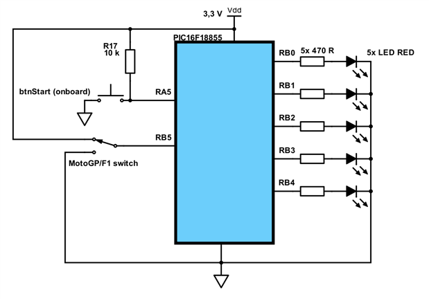

I wrote about the Xpress Evaluation board in my previous blog, so I will just provide a link to the schematics of the board.
As mentioned in requirements, 5 red LEDs, one switch and a push button is required to be connected to the PIC. Oscillator was selected internal low frequency, running at 31 kHz. Here is a simplified schematics with just the external parts connected to the board (one exception is button connected to RA5 and resistor R17, I used them to minimize the number of external components needed).

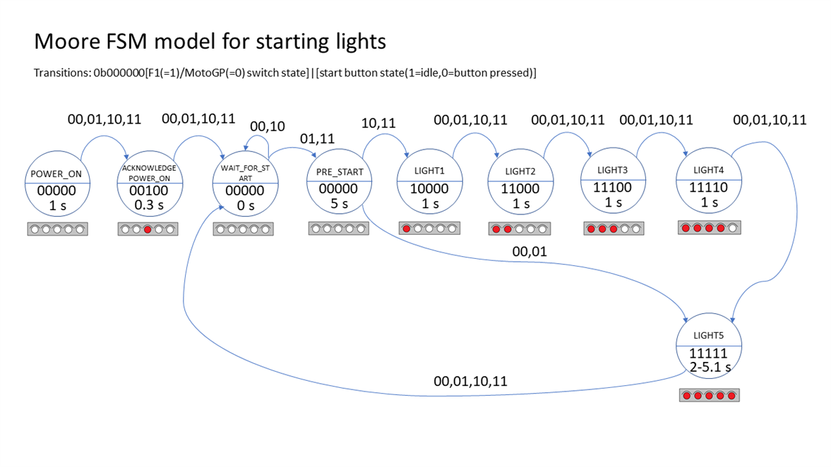

Now comes the fun part. Traffic Light Controller "from the clouds" v0.1 used a Moore finite-state machine model. The same model is used in this build, but there are now two inputs that need to be considered - an F1 / MotoGP start style switch and a button that initiates the starting sequence. What needs to be changed?
The struct that holds all the information for state machine doesn't contain only one nextState variable, but an array of four. Why four? There are two new inputs, each can have two states, that gives four states in total.
Here is how it works. A switch logic state on RB5 is read and a button logic state on RA5 is read. Both bits are stored in the inputSwitches varible in the following way: 0b000000[F1(=1)/MotoGP switch(=0)]|[start button state(1=idle,0=button pressed)].
For each state, all four possible next states are defined, because the input can change anytime. If the input is not important than all four next states can be the same (of unrelated to the meaning of the switch and/or the button). For example all transitions between S_LIGHT1 and S_LIGHT5 are performed this way.
The program works this way:
After a power up, nothing is performed for one second. Then one LED (the middle one) is lit for 300 ms just to show that the power is on and the circuit is ready to take orders. The program is now waiting for a start button to be pushed. That is what initiates the starting sequence. After the start button is pushed, nothing happens for 5 seconds. As described above, this is just a small delay for the player who starts the race to grab the controller and get ready. After the five seconds delay a decision is made, based on the state of the F1/MotoGP mode switch. If set to MotoGP, all 5 LEDs are turned. If the switch was set for an F1 mode, the LEDs are lit gradually up to all five. The rest of the process is the same. A pseudo-random delay is made (using an independently counting Timer0, which 5 LSBs were captured when entering the "5 LEDs on state"). There is a base of 2 seconds and additional 0x - 31x (5 bits from Timer0) 100 ms are added. After that period, all LEDs go out and the state gets back to the "waiting for a push of the start button".
To get the whole picture, here is a diagram of the state machine with all possible transitions:
