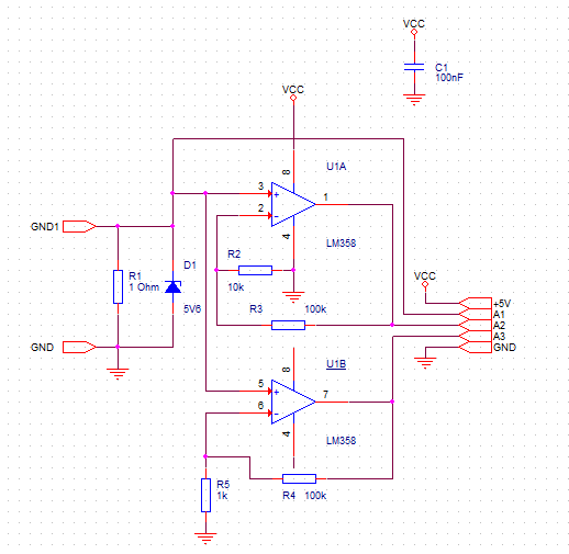

Now - how to improve measurement range of our device? We can use different resistor - but it can impede operation of DUT (even on 1 Ohm at 1A voltage drop is 1V - and it generates 1W of heat). Switching resistors during runtime seems impractical - we will need to switch them very fast to follow current variations.
In the next step auto-ranging using two opamps was implemented. Atmega828P includes analog multiplexer and - according to the datasheet - voltages greater than reference are represented as values near 0x3FF - so it is not going to be destroyed by measuring voltages near Vcc even using internal 1.1V reference.
It means we can connect signal amplified by different ratios to different analog inputs and select one that is both in-range and as far from zero as possible. As opamp (LM358) is powered from 5V, output voltage cannot exceed Vcc (so it is safe for Arduino) - and input was protected with 5.6V Zener diode instead of reverse-polarised switching diode to protect both from reverse connection and overvoltage. Schematics of interface circuit is as below:

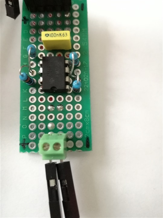

And the question everybody is asking in this competition - can it drive you crazy? Of course - unreliable connections of breadboard was driving me crazy to the point when I moved everything to the proper universal PCB, when unexplained behavior ended. This version is displayed on the following photo:
Universal PCB version
So - how fast one can build such a meter? It took me a few hours - mainly debugging problems that turned out to be related to unreliable bread-board connections...
