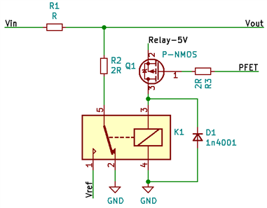

The first step in my VADC project was to design an R-2R ladder. My goal was to create individual "bit boards" with a resistor, relay, and LEDs. The resistors are obvious because they build the R-2R ladder. The relay and LEDs are entirely for visualization purposes. I decided the PCB should light up around the relay whenever that particular bit is active. Each bit board contains six LEDs and one relay. The relay determines if the resistor is in the ladder or not. The LEDs are these reverse mount LEDs from Wurthreverse mount LEDs from Wurth. (More on being reverse mount below.)

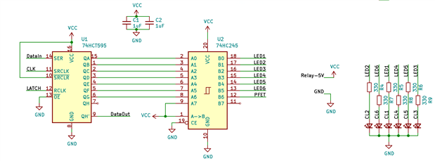

To drive the relay plus six LEDs, I decided to add a 74HCT595 74HCT595 shift register to each board. Using a shift register means I can daisy-chain multiple boards together. Initially, I built four boards for a 4-bit DAC. But in theory, I should easily be able to extend to 8-bits+. (Well, I would have already built them if the rest of my LEDs were not back-ordered. grr.)
Instead of using discrete transistors to drive the LEDs, I decided to add a 74HC245 74HC245 buffer. It can provide up to 70 mA total on its outputs, which should be sufficient for this project. The LEDs have a fairly high forward voltage, so a 330 ohm limiting resistor means I'm drawing 9 mA each. So the LEDs draw 54 mA total (if they are all on). The only real consideration is the relay's coil.
For the relay, I decided to include a P-Channel MOSFET configured as a high-side switch. That way, the `595 output can directly drive the transistor. For flyback protection, I added a 1n4001. Although, it is probably overkill for this relay. I'm using these Multicomp Pro Signal RelaysMulticomp Pro Signal Relays. And they are tiny! They are so small; I was initially concerned they would not click loud enough! (Spoiler Alert: No worries, they do.)

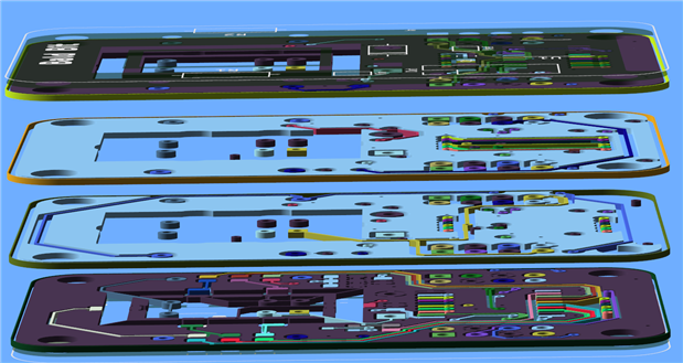

Why 4-layer?
If you look at the vADC KiCad design files, you'll probably notice the PCB is 4-layers. Why?
Well, first, my go-to PCB supplier is OSH Park, especially if the project is below 100 mm2. And second, I am using reverse mount LEDs to create a glowing ring around the relay. (or that was the plan.) OSH Park's FR4 formulation is different from their 2-layer, and it is more fluorescent. While the signal integrity of this design didn't need four layers, the cool visualization integrity did!

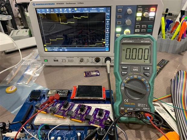

Interfacing the daisy-chained bit boards is straightforward. The only hiccup I ran into is that Arduino's shfitOut() only accepts 8-bits or a byte. Since each bit board has its own `595, each board has 8-bits of data to handle. So I had to do some barrel shifting to get the expected outputs. Even with 32-bits of data, I found I could update the LEDs once every 25 milliseconds. From a visualization perspective, that is probably too fast, but it is good to know I have plenty of headroom to flash the LEDs.
Scope Capture

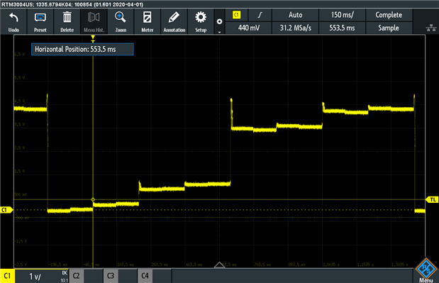

In the video above, you can see that the multimeter measures a different voltage as the bit values change. Astute viewers might notice that the voltage starts close to 5 volts and ends near 0 volts. From a DAC perspective, this range is irrelevant. However, for the visualization, I think it makes more sense for the voltage to go from 0 volts to 5 volts as the binary codes go from 0x0 to 0xF. So, later, I inverted the relays. This change means while the relay is lit up, it is actually off. In retrospect, I should have swapped Vref and GND on the relay contacts.
After making that code change, I captured the codes on my scope. And to my surprise, there is a huge gap between 0x7 and 0x8. Upon further inspection of the Bit Boards, I put the "R" and "2R" values in the wrong places! So, the ladder is just output nonsense. The positive news is that different binary values result in different outputs.

The DAC not going to 0V when the binary codes are zero was bothering a friend of mine. Which after he asked the question, it started to bother me too. After thinking about it, I had an idea why. "VIN" on the least significant bit is supposed to be connected to ground. In the video at the top of the post, it is left open. After making that change, now the DAC goes from 0.00 volts to about 4.2 volts. (but the codes are not linear or in order because the resistor values are still wrong.)
