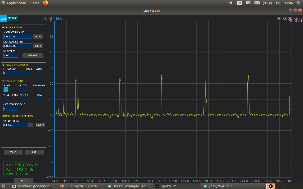

And this is what I wanted to do. First I measured the signal directly from the Si5351 with all the harmonics and then I measured again with my filter in place, where all my harmonics should have disappeared.

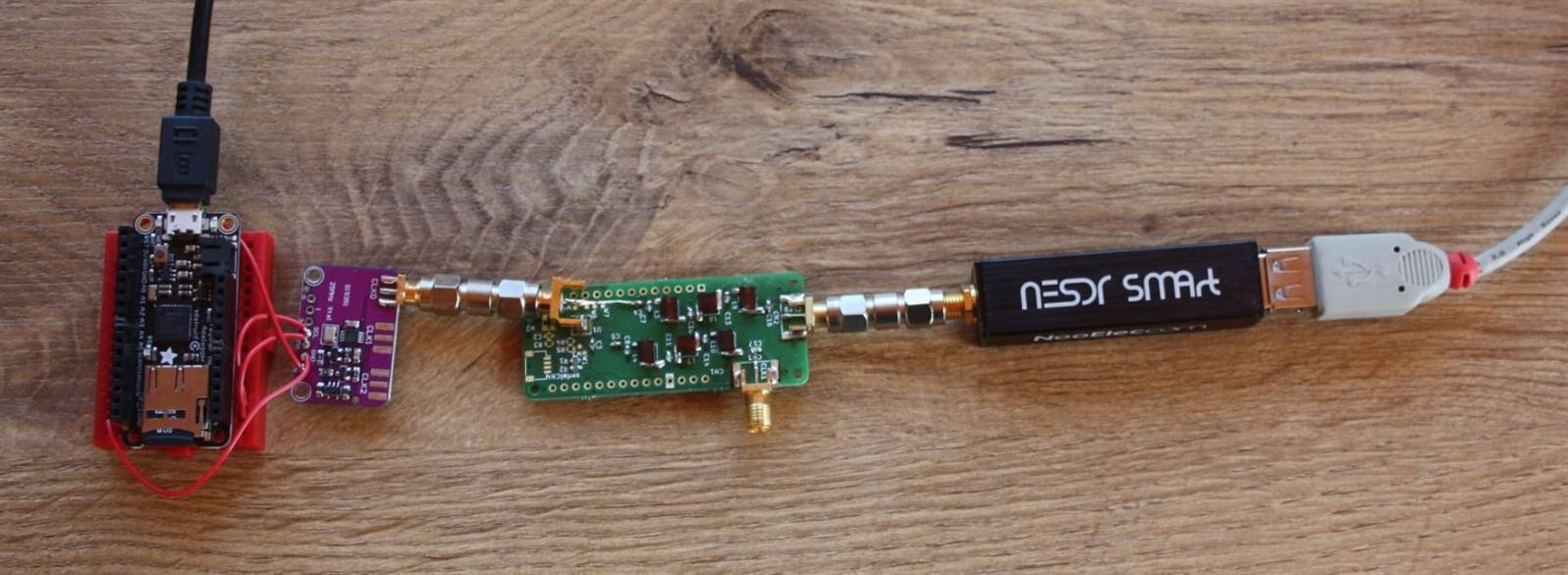

Hardware setup
This shows my test setup.
From left to right it shows:
  • Adafruit Feather M0 to control the clock generator
  • Si5351 breakout board
  • my pcb with the filter
  • DVB-T stick with RTL2832
  • and some USB cables to connect it to the computer.
For the measurements without the filter I disconnected the filter and connected the DVB-T stick directly to the output of the Si5351 breakout board.

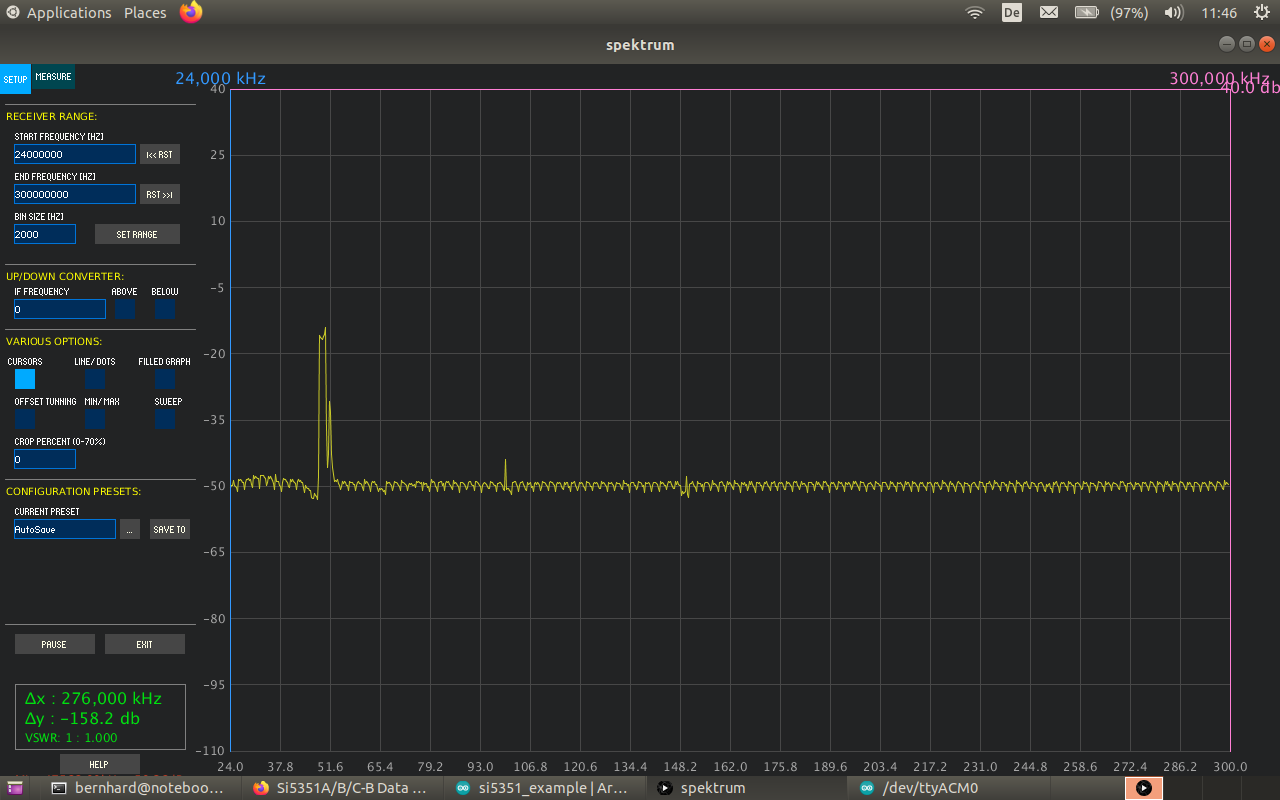

measurements
The RTL28xx has only a band width of up to 3.2 MHz. So you need a software which does all the measurements and plots all the results in one image.
I went with "Spektrum": https://github.com/pavels/spektrum
And these are the results:
Measurement without filter:
Measurement with filter:
As I have written before the RTL2832 as analyzer has some limitations. Most of them can be seen in the first measurement: The harmonics of the 50 MHz signal should all have lower amplitudes but they don't. It seems like the RTL2832 is more responsive at higher frequencies. Additionally there are some signals at 100 MHz and 200 MHz which shouldn't be there. I assume they are related to the measurements.
But the second measurement shows that all the harmonics disappear. So I think the filter works correctly and that is what I wanted to know.
