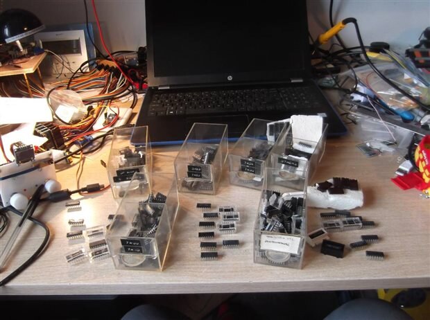

Below is a photograph of my collection of old 3400 series, 5400 series and 7400 series logic ICs. Not particularly well sorted, some are recovered from PCBs, some are new purchases a long time ago, others I just somehow have.

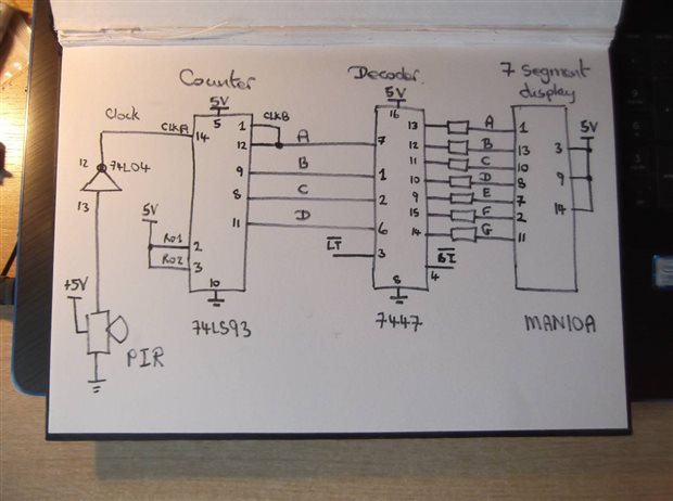

First device I needed was a display. I could have used LEDs, maybe a binary output but that is not a particularly friendly user interface. I remembered that at some point I had purchased some very early 7 segment LED displays and I thought I might have some left - and I did. They are MAN10A, mostly used in some old Fluke instruments I think and they make up each segment with a row of tiny little LEDs. They seem fairly high current (5 mA per segment) and compared with modern displays are mind bogglingly dim. . Sadly they do not have a BCD input so have to be driven from another IC. Nor do they do the full hexadecimal seven segment display font (0 to F) but instead decimal (0 to 9) plus some other made up characters, but that didn't matter as I only wanted 0 to 9 anyway.
I could not find my Texas Instruments TTL IC book (hopefully I still have it some where as it has sentimental value to me) as I disposed of all my printed books when I retired. Who needs actual books any more! I was randomly scrolling through the internet looking for a datasheet for the MAN10A when I saw one with a circuit showing binary to 7 segment using a 7447 IC. Having bought the MAN10A displays in the past I supposed that I might also have purchased/obtained some 7447 ICs as well. After looking through all my ICs I eventually found that yes! I did have a couple of 7447s. And at lease one worked.
So now all I needed was a 4 bit counter. I was sure I must have some, which I did and settled on the 74LS93 which is a decade/hex counter. I wanted hexadecimal even though I only wanted 0 to 9 - it was just simpler, so the 74LS93 was fine. Then it was a case of connecting everything together, as illustrated in the circuit diagram shown below.

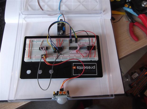

I also had to add a 74L04  inverter as for some reason the PIR output would not drive the clock input of the 74LS93 directly but it would drive the input to a 74L04 inverter. It worked so I didn't bother finding out why. While trying to get all this circuit working I realised why I used microcontrollers now and I have decided to never again make any discrete logic circuits - it is just too much like hard work. The final assembly is illustrated below.
I used a 12V lead acid battery for a power supply as the circuit takes over 100 mA and I used a DC-DC converter with variable output, set to 5V to provide the 5V needed by TTL. To provide weather protection as the system was going to be placed outside overnight I used a plastic chocolate box container that seemed fairly watertight. Plus rain was not predicted so I hoped it would b OK. There is no ON/OFF switch, it is just plugged together and away it goes. Normally the 74LS93 counter powers-on with a value of 5 although other values have been observed so I just needed to wave my arm in front of the PIR sensor some unfathomable number of times to reset the counter to 15 - which actually turns all the LED segments off. I then setup the system outside in an area known to be frequented by cats, waved my arm one more time to set the count to 0 and retreated to the warmth of my house, see below.
Then all I had to do was wait until the following morning to see what, if anything, has been detected!
And, as can be seen, 6 instances of something were detected. I was a little uncertain of the number to start with as I was looking through the camera at a tessellated plastic box cover at a dim 7 segment display, without my glasses, while at the same time trying to avoid accidentally activating the PIR sensor. and I wanted my breakfast.
