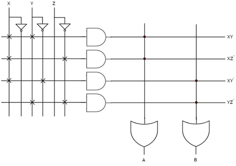

2. PLA - Programmable Logic Array:
A programmable logic array (PLA) has a programmable AND gate array, which links to a programmable OR gate array, which can then be conditionally complemented to produce an output. A PLA is similar to a ROM concept, however, a PLA does not provide full decoding of a variable and does not generate all the minterms as in a ROM.

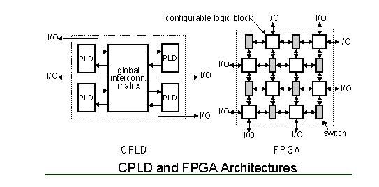

To understand more about FPGAs lets first look at the key differences between FPGAs and CPLDs:
The main distinction between FPGA and CPLD device architectures is that FPGAs are internally based on look-up tables (LUTs) while CPLDs form the logic functions with sea-of-gates (for example, sum of products). - Wikipedia
A CPLD contains a bunch of PLD blocks whose inputs and outputs are connected together by a global interconnection matrix. So a CPLD has two levels of programmability: each PLD block can be programmed, and then the interconnections between the PLDs can be programmed.
An FPGA takes a different idea. It has a clump of simple, configurable logic blocks arranged in an array with interspersed switches that can rearrange the interconnections between the logic blocks. Each logic block is individually programmed to perform a logic function (such as AND, OR, XOR, etc.) and then the switches are programmed to connect the blocks so that the complete logic functions are implemented.
Source: https://www.circuitstoday.com/understanding-fpga-and-cpld#:~:text=A%20CPLD%20contains%20a%20bunch,FPGA%20takes%20a%20dif…
In short, an FPGA is a device with a large number of configurable logic blocks (CLB) surrounded by a programmable interconnect to implement a user-defined logic function.

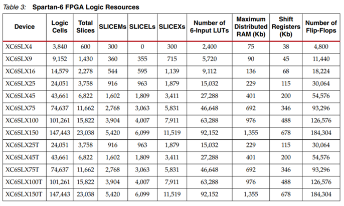

Choosing an FPGA is an important step, it can be done by looking at the CLB of an FPGA and decide accordingly for eg. if one wants to implement adders one type of CLB might render efficient use, while if one wants to implement shift registers another CLB might be efficient.
Here are slices from Xilinx Spartan 6 FPGA from the CLB user guide:
The above table illustrates the variants of Spartan-6 FPGAs, which one can choose according to the application requirements.

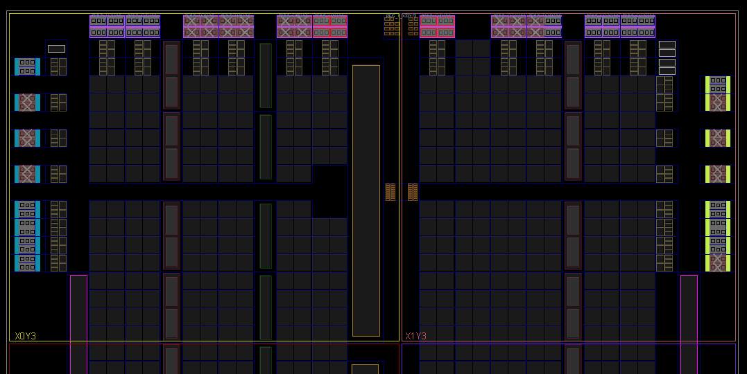

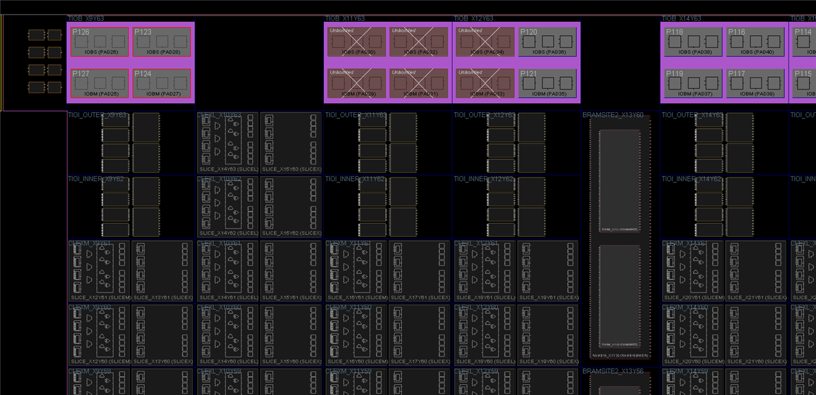

Internal Structure of Spartan-6 XC6SLX9 FPGA:
As we zoom more, we will be able to look at more detail in the FPGA, note that in the last image you will be able to see the placement of SLICEM, SLICEX and SLICEL in the FPGA.
