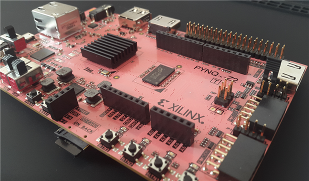

The TUL PYNQ-Z2 is a development board based on the Xilinx Zynq XC7Z020 FPGA SoC:
It features a 512 MB DDR3 RAM, a HDMI Input and a HDMI Output port and other interesting features.

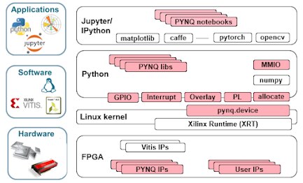

The PYNQ-Z2 is also one of the "official" demo boards for the PYNQ (Python Productivity for Zynq) framework.
PYNQ (Python Productivity for Zynq) is a open-source framework from Xilinx that aims to make FPGA development easier.
PYNQ uses pre-built FPGA designs along with Python libraries, to allow exploiting the power of PL acceleration much easier.

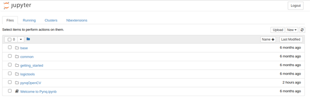

After we power up the board, a Jupyter Notebook server will be started. We can access it on http://pynq:9090/:

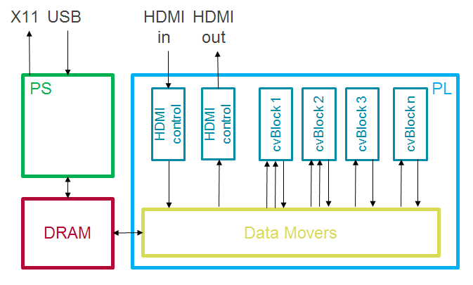

To do image processing with PYNQ will use OpenCV. For HDMI Input and Output we can use the Base overlay.
The PYNQ-ComputerVision overlays provide hardware accelerated versions of common OpenCV functionality:

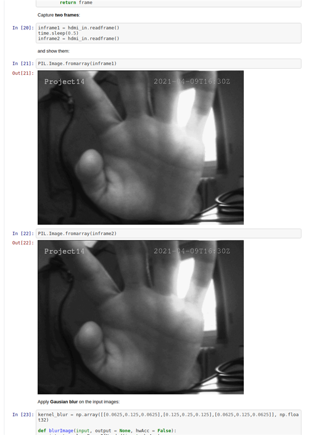

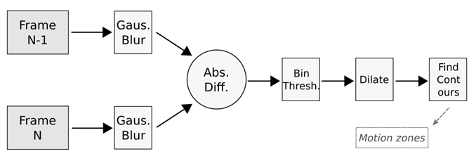

To implement hardware (partially) hardware accelerated motion detection, I used the following algorithm:
  • two consecutive Input Frames are used as input
  • Gaussian Blur is applied for noise filtering
  • the Absolute Difference of the two frames is calculated
  • a Binary Threshold algorithm is used to transform the gray-scale image into a black-and-white image
  • two Dilation iterations are applied to fill up small gaps in the white areas
  • a Find Contours algorithm is applied on the resulting image
  • the resulting Contours represent the areas in the image where Motion was detected

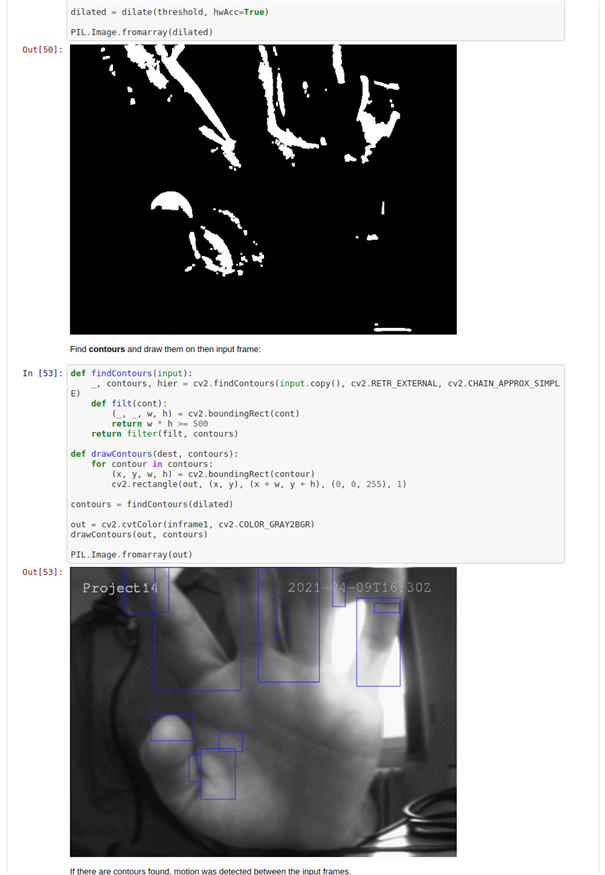

The parts that can be hardware accelerated are:
  • the Gaussian Blur calculation, which is implemented as a 2D Filter - using xv2.filter2D()
  • the Dilation - using xv2.dilate()
(note other steps may also be hardware accelerated, but it may require building custom Pynq overlays)
The algorithm is mostly inspired from the Use Python, Zynq and OpenCV to Implement Computer Vision article from Adam Taylor.
I implemented the algorithm a Jupyter notebook, in a step-by-step manner. The notebook is available in the following Gist:
https://gist.github.com/bluetiger9/5aaa049380e795877c31d16cb009d486

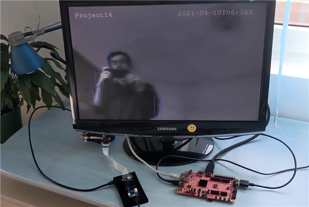

A pure software and a (partially) hardware accelerated version of the algorithm were implemented.
The performance of the two versions looks like follows:
  • software: ~10 FPS
  • hardware: ~16 FPS
(note: it is not too spectacular result, but given that 3 of the 5 steps are still implemented in software it can be considered ok)
Here is a demo video showcasing the project:
