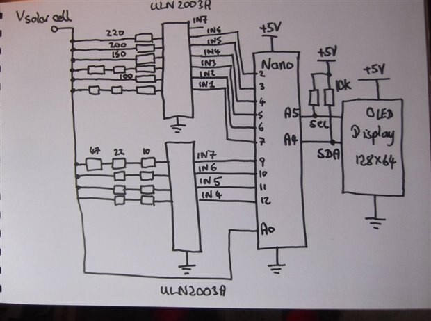

For the DIY Test Instrument Project14 Challenge I decided that I wanted to make something using a graphic display and something I have been playing with this summer (when the sun actually shines!) are solar cells. Solar cells are interesting things as the power they produce is very dependent on the sunshine 'power', naturally, which affects the maximum power transfer point. The maximum power transfer load occurs when the load resistance across the solar cell is the same as the internal resistance of the solar cell and the internal resistance varies depending on the intensity of the sunshine falling on the solar cell. So it seemed to me that a meter that would measure and display the maximum power transfer and the maximum power transfer load resistance would be a good thing. So here it is.
Circuit Diagram
The circuit consists of a Nano connected to a 128x64 OLED white display which is used to show text and graphics. Ten of the Nano digital outputs are used to control analogue switches (ULN2003A) capable of a maximum current of 500 mA, used to apply resistive loads from 44 Ohms upto 220 Ohms. I didn't have all the specific resistor values I wanted so I made them up out of the values I did have. (Note : Buying lower value pin-thro-hole resistors is quite difficult if you only want a few). The values I managed were:
44 Ohms  (22 + 22)
57 Ohms  (10 + 47)
69 Ohms  (22 + 47)
79 Ohms  (10 + 22 + 47)
91 Ohms  (22 + 22 + 47)
100 Ohms
122 Ohms (22 + 100)
150 Ohms
200 Ohms
220 Ohms
I used Veroboard to construct the circuit, aiming for as few additional wires as possible, which is why the circuit is a bit 'odd' in places. In the end I think I only used four wires, plus the components, which seemed pretty good to me.
The circuit works by applying one of the resistive loads across the connected solar cell for a short period of 20 mA. I only had 250 mW resistors so a short applied load period was sensible, in order to avoid overheating the resistors, and I choose 20 ms. Solar cells are essentially semiconductors so should have short rise times and 20 ms seemed a good amount. I didn't have time to experiment with alternative delay values and the resistors did not seem to warm up. The solar cell voltage, Vsolar, is then measured using A0 on the Nano. In order to calculate the current through the load resistor I needed to subtract the Vbe voltage of the ULN2003AULN2003A transistors switches from Vsolar and then divide by the resistor value. Rather than try and measure the Vbe one each resistor load I took a sequence of manual measurement's using a DVM at various loads and decided that a value of 0.65V would be sufficiently accurate. The current can then be calculated as:
     I solar = (Vsolar - Vbe)/R
and the power becomes
    Psolar = Vsolar x Isolar
for each value of resistor.
To make a nice display on the OLED display it would be preferable to have more than 10 values (one for each different resistive load). Additional values can be obtained by fitting a polynomial curve to the power values. A library exists to do this in Arduino called CurveFitting which is easy to install via the Library Manager.
Sadly, it transpires that the Nano does not seem to have enough data memory to be able to implement both the OLED display and the curve fitting process as when both are implemented the same programme became unstable, resetting and just producing rubbish. There was insufficient time to rework the hardware circuit using  an Arduino with a larger memory (I did try the programme using a Maker WAN1310 and it seemed to work but it was not a pin for pin replacement for the Nano) so I ended up with two separate programmes. One obtains the power values, the other determines the polynomial coefficients. So I manually typed the power values into the curve fitting programme, obtained the coefficients and then manually entered them back into the first programme. I managed to get a working result although not in 'real-time'.  It would only take a bit more time and effort to rework the hardware to use the Maker WAN1310 (or some other Arduino with more memory) to create a fully working real-time measurement system.

To get the final results I took the hardware outside in the slightly sunny afternoon and obtained a set of power values. Then returned back inside, typed these power values into the curve fitting programme, obtained the  polynomial coefficients and then typed these back into the original programme. The results for all this effort is illustrated in the video below. A nice curve and the maximum power transfer resistor load.
Demonstration Video
Summary.
I am satisfied that the concept of the Solar Cell DVM  (should this be DPM) is valid and workable, once the problem of needing more data memory for the floating point calculations and graphic display are sorted, probably with a MakerWAN1310 or similar. It will then be possible to monitor the changing maxim power transfer point of individual solar cell, as the sun varies in intensity.
I was planning to make a 3D printed casing but this was not started due to the problems outlined above.
