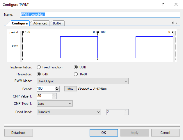

  • There are two VDAC components and their purpose is to generate a reference voltage for the comparator. These components are programmable in a PSoC 5LP and I have chosen a range of 0 - 4,080 V (16 mV / bit), however, as I am powering the circuit by Vdd = 3,3 V, the maximum reference voltage generated would be Vdd. (The good thing is that PSoC Creator makes you aware of this fact, so it's not a surprise for starting engineers / makers.) One VDAC is set for logic low level 0,8 V and the other for logic high level 2,0 V.
  • VDAC outputs are fed into the inverting inputs of the comparators. Input of the logic probe is fed into both of the comparators, but to the non-inverting inputs. The comparators have to decide then, whether the logic input is lower than Vil (and obviously Vih), between Vil and Vih, or above Vih (and Vil, of course). There is one hypothetical fault condition, that the high voltage level comparator will output a logic high, while the low voltage level comparator will ouput a logic low. I hope this won't happen, but the situation will be taken care of by the sound signaling part of the circuit. By the way, the comparators' synchronization is bypassed, so they don't expect to be clocked.
The rest of the circuit is used to produce a sound output so the user has an idea of the voltage level measured.
  • Two PWM modules are used to create two sounds with a different frequency, one for logic high and one for logic low.
  • As you probably noticed, there is an OR gate mixing both of the PWM outputs together. This was just found by an experiment to create a sound that would differentiate from logic low and logic high sound. This could definitely be done many other ways, using more internal PSoC resources.
  • All the outputs are fed into the multiplexer and the meaning is to provide separate channels with all the possible sound outputs, so only one sound buzzer is needed. (This probably isn't the smartest description of a multiplexer usage, right?) The multiplexer has four inputs, the last is not needed, so I connected it to a logic 0, but this input is never used.
  • The fun part is the control function of the multiplexer. We have two comparator outputs and their output combination tells us in which boundaries is the input voltage. This is where a lookup table (LUT) comes in. It is basically a definition of a discrete function. We have two inputs (4 possible states) and need two outputs for controlling which frequency output will be connected to a buzzer. Here is the definition:
