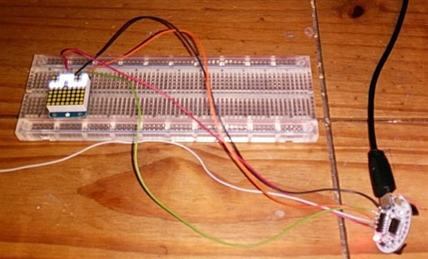

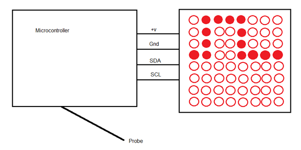

I was planning to make a super simple logic probe but Jon beat me to it with his comparator based logic probe. So I've prototyped a microcontroller based one.
Microcontroller based logic probe with display
My project has just two modules, an Arduino clone and an Adafruit I2C LED backpack. The probe is connected to an analogue pin although the current software uses it as a digital pin only. The pin is sampled once every half second and 8 samples are shown across the screen on the first 2 lines.
I tested the LCD with the Adafruit demo followed by writing my own hardcoded bitmap.

There seems to be a power issue where the Arduino resets when the display refreshes. That was the case with the demo as well as my test code. Potentially a big capacitor across the power rails might fix that or perhaps an independent supply for the display.
It should be possible to update writeDisplay so that the signal scroll across the screen, it would also be good if it used more than just the first two rows on the display.
The other obvious thing to try would be to write the data from the input back to the serial port then have a graphing tool on a host PC to display or capture the waveform.
