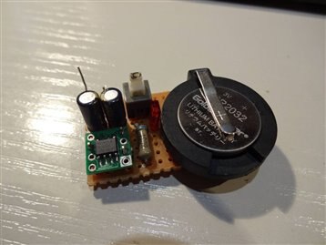

The Multi-Ref is not a test device as such, but the tool I use to test my test equipment. I got the idea for this from the user [matseng] as the Dangerousprototypes.com forum, and found it very useful.
MrRef, as it was called, is just two coin cells powering a precision voltage reference. The intention is to allow checking your own multimeters for accuracy and drift. Not everybody has a 6.5 or better DMM at home, with a accuracy of 0.01% or even better. Back then my best DMM was a TekPower TP4000ZC, 4000 counts and 0.5% accuracy at the best, anything else was just cheap 3.5 digit DMMs, some of them more than 15 years old (but I got a UT61E shortly afterwards which claims 0.1% accuracy). So it was interesting to see how accurate the meters still are. This is something important - you want to know that you can still trust the stuff you measure.
So I built a small MrRef by myself, using REF5020 from TI. This is a low noise precision reference with 2.048V output. Its 0.05% accuracy result in at most 1mV error - one digit basically. But this value creates a problem: its too high to properly check a 2000 count DMM since these go only up to 2.0V.

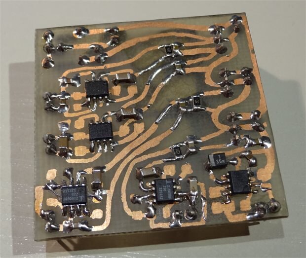

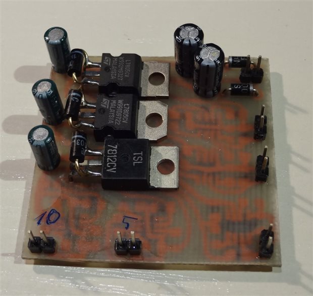

I put all of the references on a small PCB, together with some 78xx regulators so the references don't need to dissipate so much power and heat up. Everything was powered from a 9V AC supply (whose voltage was doubled).
The PCB itself was designed to be generic so I can use other references. Most of them follow a common SO8 footprint, and just differ in whether they need input and output capacitors, and sometimes an optional capacitor.
(The resistors in the middle look a little bit funny - I forgot that the 78xx regulators need some minimal load so I needed to add them. You can see the free footprints for the capacitors, and how they are populated differently for the different references. Whats not to be seen here is that I also have a DPDT switch so I can easily switch polarities to the multimeter so I can test both positive and negative ranges.

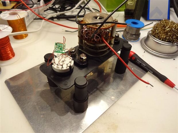

For the voltages, resistors and capacitors I found an old 2x24 rotary switch - unfortunately the current reference needs  a three-pole switch so I put it on an separate pair of binding posts. Time to start wiring everything:
The REF200 current source is just on that small SOIC8 breakout board, attached with magnet wire to the range switch. On the large switch I already added the wires for changing the polarity of the voltages.

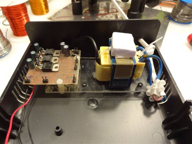

Then I mounted the existing PCB and the 9V transformer 8without its case) to a small acrylic plate which is then mounted in the enclosure:

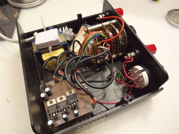

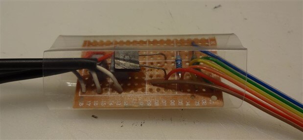

The current reference is powered from the existing 9V regulator so I don't need an additional battery. The resistors and capacitors go to a separate board, wrapped in heat shrink tube. One of the resistors (the 100k one) is on the bottom side since its a SMD one.
If you count very closely you can see that there are too many wires. This is due to a small trick: I added one pair of wires for the capacitors, which I left open. And another wire for the resistors which gets shorted to the common wire. These additional wires end up in a '0nF' and '0 ohm' selection, which can be used to zero out any capacitance and resistance in the measurement wires. Since they are of the same length and placement as the regular wiring this relative measurement is hopefully quite accurate.
Everything wired up:

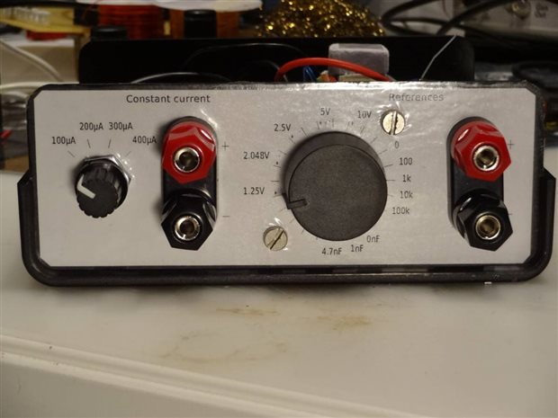

The front plate was designed in Draftsight (a free CAD program for Linux, Mac and Windows). I printed it on paper, glued it to the plastic front plate and them covered it with self-adhesive foil:
I found a nice trick to get the lines for the scales all in the right place:
  • draw two circles, centered on the hole for the rotary switch, which mark the inner and outer end of where the lines should be
  • then create points to split the circles in segments (Draw / Points / Segment - select a circle and it gets marked)
  • configure Draftsight so points get a large cross (to see them on the drawing)
  • Use the "Element Snap" function to snap start and end points of each line to the correct segment points
  • afterwards, delete the circles and the points, and you have just the scale lines left

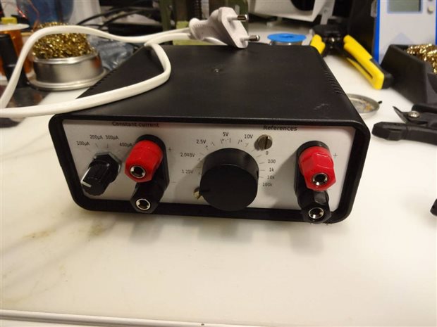

I think it ended up quite well. No need to fiddle with wire grabbers, re-positioning connectors and looking for parts in a small box:
