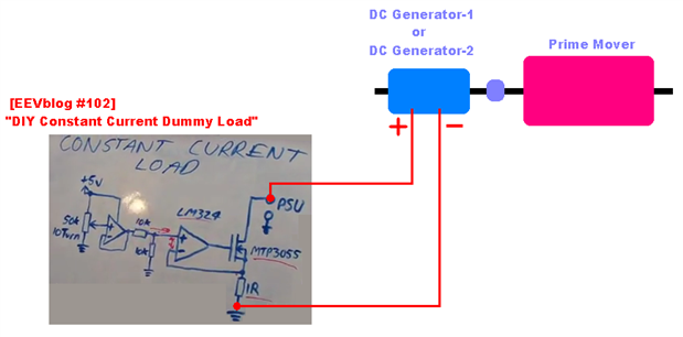

Doing a google search for ‘constant current source’ comes up with a number of interesting results including publications in instructables. Though these may not inspire much confidence, they are a source of test data that an approach was in fact used. My search lead me to a youtube video by Dave Jones of the EEVBlog where he uses a simple circuit to make a DIY Constant Current Load. Further investigation revealed that many more had tried the approach and indeed was a usable. Hence, I decided to recreate the circuit shown below due to it’s simplicity.

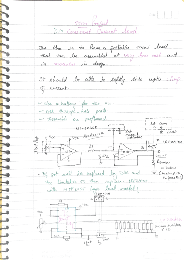

Below is a shot of my notebook with the circuit diagram, specs and a layout. I used separate connectors for the Op-Amp supply and the load. In order to monitor the set current, tapped into the non-inverting input of the second op-amp. This connected to a multimeter would give us the set current without the need for a dedicated meter thus reducing the BOM cost of the project. An extension of this technique could tap into the inverting input to get the value of actual current being drawn. In my case, I employ a dedicated meter for the task to ensure accuracy.
Adding a fuse or switch seemed trivial though can be a useful feature. I do not plan to make a PCB for this since it is a stepping stone to the next level which I will discuss at the end. I made a layout of the design before I switched on the soldering iron so that I knew exactly what I would be aiming for. I aimed to made the device as small as possible and in true DIY fashion.

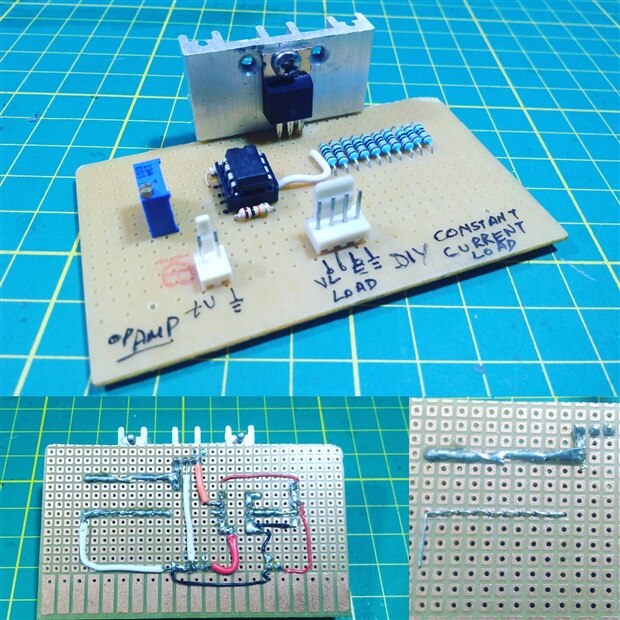

Putting humpty-dumpty together was not a challenge thanks to a bit of planning and the end result is presented in the image below.

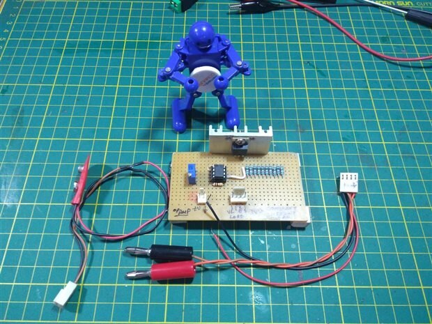

With my 3D printer lacking the necessary filament, I decided to add some DIY stand offs to the resulting circuit board. Pencil erasers cut up in the right size and attached using hot glue were a successful endeavour allowing for a bit of ground clearance. This would be helpful in case of solder blobs or unsheathed wire trims were loose on the workbench. The heatsink was a non branded one though it did seemed big enough and did it’s job well. The end result is shown below without it’s connectors as well as in complete setup.

    One point to be noted is that at 1 Amp of current, the drop on Rsense would be 1 Volt and with the Vgs required to be more than 10V for the IRFZ44N and 4.5V for the MTP3055, the gate voltage should be…
  • michaelkellett
    michaelkellett over 6 years ago
    One point to be noted is that at 1 Amp of current, the drop on Rsense would be 1 Volt and with the Vgs required to be more than 10V for the IRFZ44N and 4.5V for the MTP3055, the gate voltage should be as high as possible. This would also go on to effect the switching times with the Vgs rise time not being able to meet it’s intended mark.
    I looked at the data sheet for the IRFZ44N from IR, especially this graph on page 3:
    You can see that typically you will need a lot less than 5V Vgs to get 10A of drain current - so you should be able to run you op amp from a 9V supply.
    Another point that may be helpful, whenever I put a buffer in the feedback loop of an op amp I add some defensive components:
    R1 helps to protect the op amp from the capacitive load presented by the MOSFET gate.
    It also slows things down, make it too big and the MOSFET will take ages to turn on.
    C1/R3 reduces the gain in the loop at high frequencies, many op amp/MOSFET combinations are unstable.
    The best way to tune (in Spice or hardware) -
    start with the values shown, drive with pulses or square wave.
    Adjust R1 to get fast enough response (check op amp specs for recommended minimum series R driving a capacitive load).
    Adjust C1.R3 to get best (smallest) overshoot (increase R1 or C3), and best response time (decrease C1 or R3)
    As long as your op amp is unity gain stable you can tune this design to be stable with pretty much any MOSFET and op amp - high Q inductive loads  can be a problem.
    All the above applies if you are using the MOSFET as a current sink or a voltage follower where R2 is the actual load.
