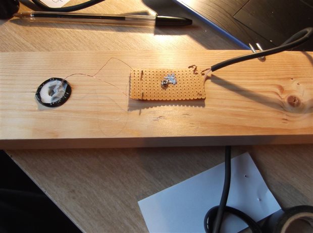

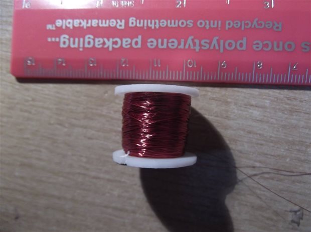

As the prototype body for the one string electric guitar has been completed the next step is to make the pickup coil. I have previously made a 3D printed bobbin to wind the coil on so all I need now is to select the wire to be used and wind it. I have selected the thinnest wire I had, which is 'pretty thin' (that's a technical term for non-mechanical engineers like me) which I think is 32 SWG or 38 SWG. It is so thin I can barely see it, even with my glasses on. It is enamelled so that the coils do not short out. I thought about making a coil winding mechanism with perhaps a continuous rotation servo motor but then thought - blow it, I'll just try winding it by hand. I don't think I'll do that again as it took a long time and the coils are not especially neat but eventually I had something made, see below:
The wire is so thin I had trouble handling it but by being very careful I managed to avoid breaking the wire (until right at the end!). I used sandpaper to gently remove the varnish coating, which again it was difficult to see if I had been successful, even with a magnifying glass. I know that some wires are coated with a varnish that evaporates when soldered so I hoped for the best. As the wire was so thin I decided that directed connections wasn't going to work as the stressed would have been too great and the wire would break. Instead I used a pice of stripboard and added some Veropins and then wrapped the wire around the pin and soldered the lot. It seemed to work as when I measured the resistance ot came up as 112 Ohms - which seemed reasonable for a very long length of pretty thin copper wire. I had an old guitar cable in by box (in fact I have several - left over from my son) which I cut one end off and soldered to more Veropinis on the stripboard see below.

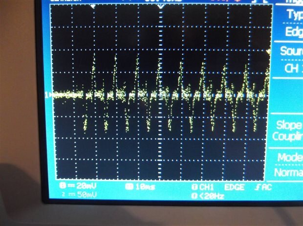

I used some black insulation tape on the pickup bobbin to create an interference fit into the wood as the hole drilled was slightly too large and then a U staple as strain relief on the guitar cable. Everything is now solid and stable and the coil wire should not break. I used a piece of white paper to cover up the bobbin and pretty thin wires to provide protection against mechanical rubbing and movement. As this is pretty much all there is to a simple electric guitar pickup I connected my Digital Signal Oscilloscope directly across the pickup coil and plucked the string. After some fiddling about with the settings I managed to obtain the waveform shown below. My DSO isn't that great as I bought it mainly for displaying digital waveforms and it's not that great at showing analogue signals. Either that or I just don't know how to get it to make good images - which is quire possible.
It is not that clear but I think the timebase setting is 10 ms per square which makes the frequency about 100 Hz. I don't know if this is good or bad.

So everything the pickup and string are working and the prototype electric guitar is complete. I have since looked on YouTube on How to Tune a Guitar and realised I have used the tuner incorrectly. I think it needs to be set to 440 Hz and then the string tightened to bring it into tune - assuming that is possible. While trying to find a circuit or kit for a guitar pre-amp I stumbled across a headphone amplifier module for an electric guitar. Apparently this is effectively an electric guitar pre-amp (makes sense really) and I can plug the one string guitar directly into it and then into my left-over iPhone Amplifier/Speaker set. This should be arriving today so shortly I should have a fully functioning working electric guitar. If it all works I might try taking it down to a place where there is a proper guitar amplifier and try it out at full volume, maybe even turn it up to 11!

    Hi Dubbie, Nice project, Now we are all waiting for the concert. If you switch your scope to vector mode it should connect the dots and make your waveforms look more conventional. John

    AFAIK, the output signal for real pickups is around 200 mV, so you achieved not that bad signal-to-noise ratio!
    Also, I wouldn't worry about the 440 Hz tuning: your value is still a real note. Just play the music with notes not lower then your 452 Hz image (I also don't know the note names associated to the frequencies). Anyway, you will not be able to play precise notes without position markers - so, no need in the precise tuning

    I looked at my DSO and I couldn't see anything that would switch to vector mode. It was a low cost model so it might not have vectors, or it might be hidden in a menu somewhere. I'll have another look. If anyone might know it is a GW INSTEK GDS-1052-U. I still haven't worked out how to capture the images digitally yet, hence the photograph.
