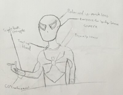

Dreaming Up a Maker Version of Spider-man

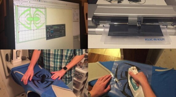

  • Vinyl Cutting

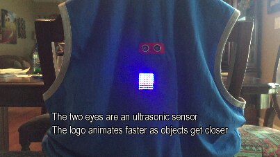

  • Spidey Sense Rear Proximity Sensor to flag close objects and update an LED Matrix in the center of my back

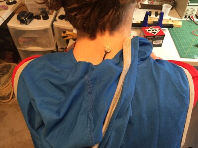

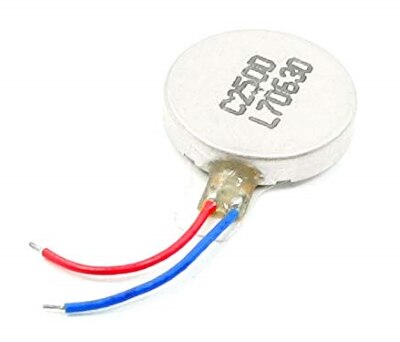

  • Small vibration motor that rests on my neck and vibrates whenever the A.I. report a danger

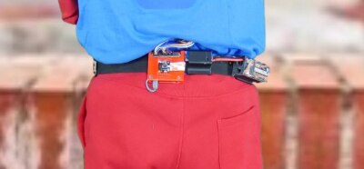

  • 3D Printed Belt Accessories to hold the components and CO2 Cartridges

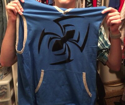

  • Modded hoodie to integrate the wearables

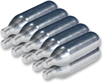

The webslinger gauntlet will house a 16gram CO2 cartrige to use a burst of pressure to shoot out a hook that is tethered with KevlarRegistered. No MCU is needed for this, just a valve like you find for inflating bike tires.  It will has a motor in the gauntlet to retrack the KevlarRegistered.

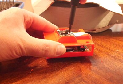

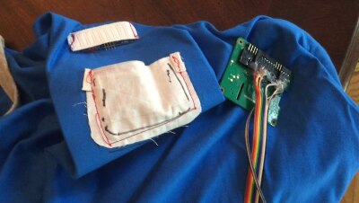

The camera & proximity sensor will be sewn into the back of the shirt.  The Raspberry Pi A+ will serve as a brain for the full suit, controlling all sensors and cameras within the suit. Along with that, we used a Pi SenseHat with its built in RGB display to change logos like when the "Spidey Sense" is triggered.  With the timing of this contest, I was able to score one last Halloween costume.  image

  • Raspberry Pi 3 Model ARaspberry Pi 3 Model A
  • Raspberry Pi NoIR CameraRaspberry Pi NoIR Camera
  • Raspberry Pi Sense HatRaspberry Pi Sense Hat

  • 12mm x 2.7mm Cellphone Vibration DC Micro Motor 3V 70mA 12000RPM

16 Gram 3/8"-24 threaded CO2 Cartridges

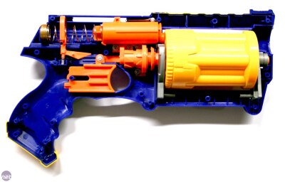

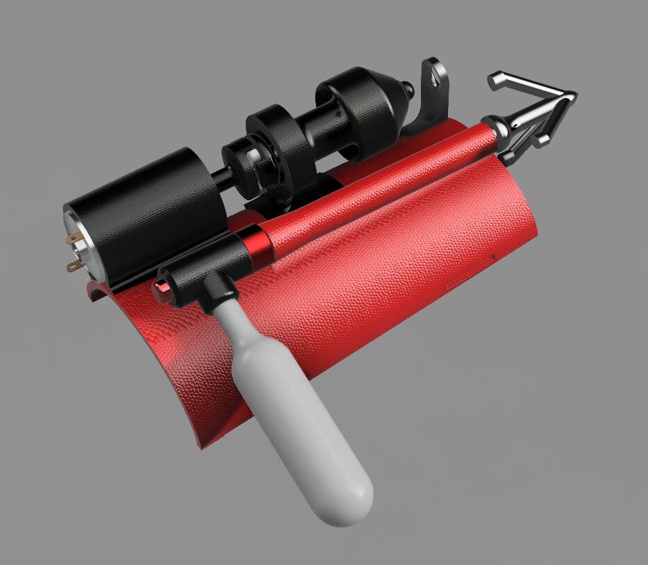

Of course, before we turned to CO2, there were loads of ideas I sketched up in Autodesk Fusion 360. I studied the many designs of Nerf guns.  As simple as it sounds, a lot of Nerf guns use air velocity to fire the dart. They draw back on a small cylinder, which is spring loaded behind the piston.  The spring pushes a piston in the tank.  The piston covers a wider area within the cylinder than its discharge nozzle has.  In turn, the velocity of the air rapidly increases out the discharge and that is what propels the dart forward when you pull the trigger releasing the spring.  It's not the spring directly push the dart out, but rather the high velocity of air that is jetted out of the cylinder's discharge nozzle.
    Cutaway of the "Maverick" Nerf Gun, showing all of the components

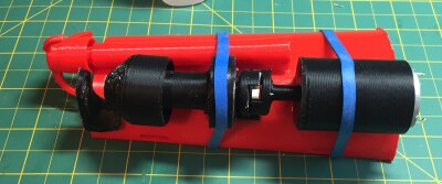

After a lot of trials with the spring loaded variant, ranging from taking up my whole forearm to only a bit of my wrist for what I called "movie accuracy," my dad and I decided it was time for the more powerful upgrade - CO2 cartridges. Changing to CO2 was the only way we were going to get a hook to shoot that to the desired 15-20 feet.

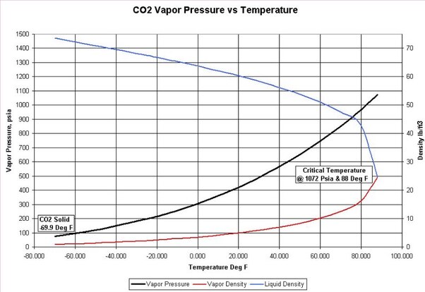

CO2 provides high gas velocity when expelled due to it being stored in the cartridge as a liquid.  At room temperature, to get it to be a liquid it has to be compressed to over 850psi.  As long as there is liquid remaining in the CO2 cartridge, its natural vapor pressure is there to deliver more than enough of the rapid change in velocity required to propel our "web".
Source: Bennett Eberle on Quara.com

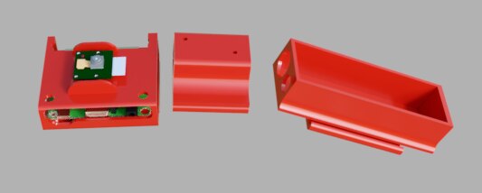

First Prototype of the Webslinger

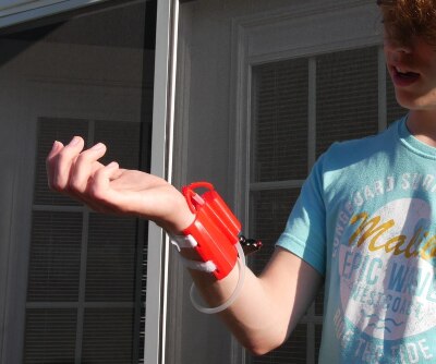

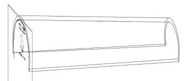

The wristband was designed as seen above. This was before I came to the shocking realization that the curvature of a human arm is outward expanding, and not the equivalent of placing an ellipse in Autodesk Fusion and extruding a few inches. Whenever I pulled it out of the printer for the first time, I felt really happy to see that this design had come so far. Immediately, I attempted to mount it upon the inside of my wrist, which then led to the unclean brim around the edges of the print slicing my arm up pretty well. That stung a lot for a good while, but while i was patching myself up, my dad came up with a better idea.

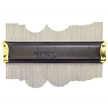

We used a profile gauge to measure my wrist from the front to the back, drew those onto paper, and then traced that in Autodesk using its "calibrated canvas" feature. When the two profiles were "lofted" to the desired length, we knew that we were in the endgame then.
Profile Gauge That Allowed Us to Design the Gauntlet to Fit My Arm

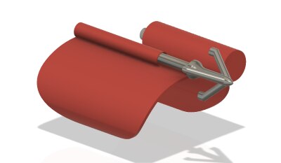

The Loft feature of Autodesk Fusion 360 Allows you to create a 3D Body by filling in the space between Two Profiles
2nd Prototype of the Webslinger - Much More Comfortable!

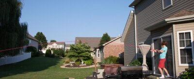

First Launch
We were too chicken to go straight to 850psi, so we took this new design out to the air compressor in the garage.  It shot a good 15 feet. The compressor charges to 120psi.  Although, what Spider-man would have a 4 foot tall air compresser dragging behind him at all times? We knew we had to complete the mobile part of this to get full results. When we set up the webslinger to a 12g CO2 cartridge, we got it to shoot a solid 50 feet with wind, and about 15 again with our KevlarRegistered string attached. This was solid progress like we hadn't seen before.
With 850psi CO2 as the Propellent, we got over 50 feet projection
(Dotted Line shows the Path)

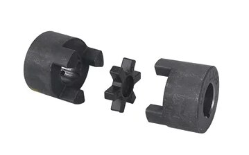

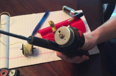

Spooling thread gets a lot harder when you have to make it fly out, retract, and have enough KevlarRegistered to hold someone's weight. We knew we had to find a way that the little metal hook could be roped back in so I wouldn't have to do it manually while fighting crime. We found my old spider man fishing pole for inspiration on the automated retraction mechanism.  However, to get a high speed motor perfectly aligned to prevent it from trashing itself would be impossible.  My Dad showed me how industrial motors are coupled.  We found a tile spacer for bathroom tile for the center elastomer and we had ourselves a coupling.
We Studies My Spiderman Fishing Rod for Inspiration
A Lovejoy Industrial Coupling:
Used to Prevent Mechanical Fatigue Due to Misalignment
The Final Webslinger Model
So, we had our final model.  A hook and string capable of holding 500 lbs propelled by 850psi CO2 cartridges with self retraction.  You can find the model on our GitHub site:  https://github.com/RaisingAwesome/Spider-man-Into-the-Maker-Verse/tree/master
The Final Webslinger Design - Very Cyberpunk!

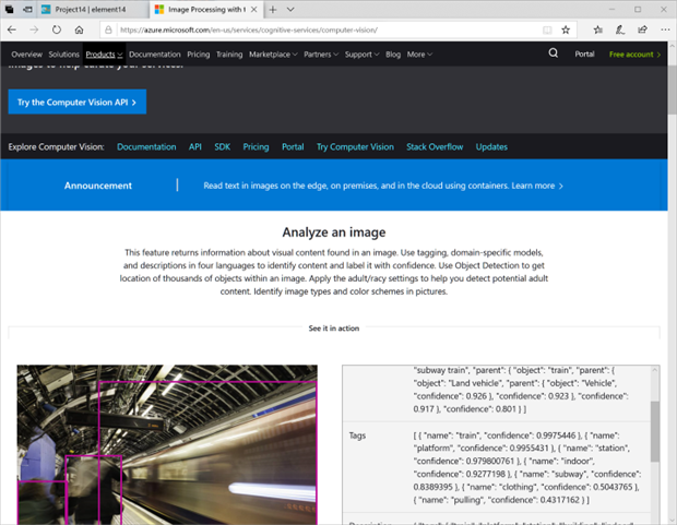

DESIGNING THE AI, "Karen":
If you've seen Spider-man: Homecoming, you'd know about the all new Stark branded AI, Karen, that Peter uses in his mask to assist him in missions. Karen was designed to be able to highlight threats and alert Peter of his surroundings, along with controlling many of his suit functions. While making an AI chatbot that responds with a voice and sense of emotion may not be the easiest thing to accomplish for this competition, we did think ahead to include a way to create this artificial "Spidey-Sense." We decided now would be a good time to take advantage of the surge in popularity of the Microsoft Azure, and the Machine Vision API provided by Microsoft.
This software is able to analyze things in an image which will be taken by a Raspberry Pi camera (aka my Pi-der cam) that is mounted to a belt. To activate this super sixth sense, I have to be very still.  Once the accelerometer of the Sense Hat stabilizes, the picture is taken automatically.  Using my cell phone's personal hot spot, the Azure API analyzes the image and the Raspberry Pi's eSpeak package let's me know through an earpiece. This will allows the suit to be able to tell if a car is close behind me, or maybe an evil villain.
Azure's image diagnosis software
Here is the Machine Vision code that pulls this off:

The Microsoft Azure Cloud API analyzes the image and returns a body of JSON as seen here:
{'categories': [{'name': 'abstract_', 'score': 0.02734375},
{'name': 'others_', 'score': 0.046875},
{'name': 'outdoor_', 'score': 0.0078125, 'detail': {'landmarks': []}}],
'color': {'dominantColorForeground': 'Black',
'dominantColorBackground': 'Brown', 'dominantColors': ['Brown', 'Black'],
'accentColor': '200B08', 'isBwImg': False, 'isBWImg': False},
'description':
{'tags': ['indoor', 'person', 'laptop', 'sitting', 'television', 'computer', 'dark', 'monitor', 'man', 'table', 'screen', 'front', 'hand', 'black', 'white', 'woman', 'light', 'room', 'holding', 'young', 'video', 'keyboard', 'remote', 'board', 'standing', 'laying', 'cat'],
'captions': [{'text': 'a person sitting in a dark room', 'confidence': 0.2671876355092342}]},
'requestId': '-------------------------------------------------', 'metadata': {'width': 720, 'height': 480, 'format': 'Jpeg'}}
They already have a Python library that does all the JSON parsing of the response, so you can snag out the caption's text element and directly put it into a sentence.  (See line 35 in the above code)

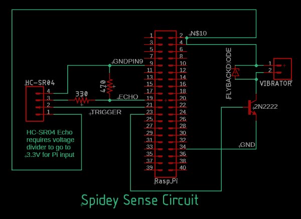

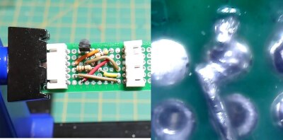

SPIDEY SENSE

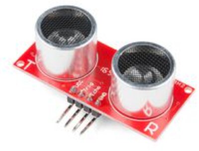

The main AI is always checking for something getting close from behind.  It does this using an ultrasonic distance sensor.  As an object gets closer, an animation of the Spider-man logo moves faster that is sewn into the back of my jersey.  In addition, when something gets real close, a cellphone vibration motor stuck to the back of my neck begins to tingle out my Spidey-sense.
My Spidey-Sense:  A Cell Phone Vibration Motor Stuck to the Back of my Neck
Ultrasonic Sensor used to trigger the Spikey-Sense vibration Motor
Spidey-Sense Vibration Motor Installed to Tingle When Objects Approach from the Back

Spidey-Sense Circuit
To allow sufficient current and get the distance sensor voltage compatible with the Raspberry Pi, a circuit was needed.  For one, the distance sensor is powered by 5V and returns a 5V pulse.  This required a voltage divider circuit to take it to 3.3V since the Raspberry Pi pins are not 5V tolerant.  The other need was for the vibration motor.  It drew up to 170ma - over 3xs what the Raspberry Pi GPIO pins should attempt to deliver.  So, we used a transistor to switch in the higher current network off the PIs 5V pins.  Since the vibrator has a tiny motor, we used a fly-back diode across it to prevent damage due to the voltage spike you get when cutting voltage on an inductor.
Without the Voltage Divider and Transistor, the Pi would have Fried
Spidey Sense Circuit Soldered and Scoped
The Spidey-Suit
With all this advanced tech, we need somewhere to house it. The suit finally is coming together, and the front has been given its vinyl spider across the hoodie. This hoodie is what holds the Raspberry Pi SenseHAT, and the proximity sensor connected to it.
Sewing - one of the first true Maker skills
Here I'm Adding Stitching for the Wire and LED Display Holes
Sewn Ultra Sonic Sensor and Sensehat Pocket
Here we are trying to learn the ways of vinyl cutting and sticking
Perfection! "Scarlet Spider" Inspired Hoodie
We never heard of the Scarlet Spider until We Searched for CO2 Cartridges!
He wears extras on his wrist - as will I
The animation speed is timed with the distance an object is behind me
A Vibration Motor vibrates when objects get real close
Microsoft Azure Machine Vision Tells me what my Pi-der Cam Sees
The Spidey-Belt
To hold the tech, the sensors are in the hoodie.  The power and Raspberry Pi are on a utility belt.  This took three custom 3D printed belt accessories:
3D Printed Utility Belt Accessories
Left:  Raspberry Pi 3 Model A with NoIR Camera Box
Middle: DC-DC Buck Converter Box
Right: LiPo Battery Bo

Mounting the "Pi" der Cam
The Spidey Sense Vibration Motor

We used Gorilla Glue to mount the Drive Train
